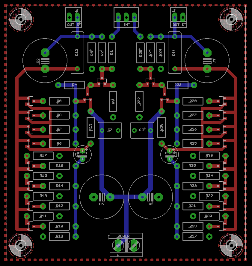

Any advice on my layout? Should I redo it non-mirrored?

Looks too NICE to change now. I wouldn't worry about. Build it!

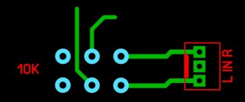

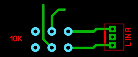

Inputs and outputs better be at different sides of the board. Easier mounting and easier wiring. Pads for volume control would be nice.
One other thing is if the JFET is already SMT, why make the resistors through hole? SMT resistors are much more compact, are better because they keep tracks shorter and easier and faster to install.

I think I see a film cap in parallel with the output blocking cap. Nice move.
I recommend adding two small caps, one to the junction of R4-R9 and another at R23-R28. That will add a small RC filter which will help smooth the voltage to the first gain stage. It's easy, cheap, and I been doing that in the last few experiments. For sure it won't make things worse.
I had to change R4 and R23 to 10R. I originally used 20R (don't ask), using a 33R purely resistive load, but was seeing clipping starting at about 1V pp. Using EUVLs model, I was able to replicate the waveform by increasing those r values to about 100R, and then Vout voltage graph looked like the waveform on the scope. After reducing those from 20R to 10R the circuit will drive the same 33R load to about 10V pp before clipping, which is far more voltage than my lo-impedance headphones will ever need. The jfets measured 28 degrees C (give or take) during normal listening. Square waves are still very square at 100KHz and beyond.
Not everyone is as excited about trying to solder SM resistors as you are.
Yes, they make for a much smaller board but they're not easier and faster to install compared to through-hole resistors.
For the lower dissipation resistors, you may be able to get by with .125W through-hole resistors making for a slightly smaller board, but I haven't done the math.
They don't have to be at opposite ends of the board. That's just your opinion.
He can easily move the outputs to the sides of the board as an option.
What's more important is he has the power input on the opposite of the board as the audio inputs and outputs.
That's exactly the way I would've done it.
I would also add 6 extra pads for a dual volume pot as you suggested.

EDIT: Wait, do you mean on the left and right sides?

I find it easier to mount the volume potentiometer on the front panel, hence the inputs and outputs on the same side of the board facing the front. I'll use shielded cable from the rear panel inputs to the pot.Inputs and outputs better be at different sides of the board. Easier mounting and easier wiring. Pads for volume control would be nice.
I'll give that a tryI recommend adding two small caps, one to the junction of R4-R9 and another at R23-R28.
I actually did a much smaller all-SMT layout for the fun of it, but I'd never be able to solder the darn thing. My hands are far too unsteadyNot everyone is as excited about trying to solder SM resistors as you are. Yes, they make for a much smaller board but they're not easier and faster to install compared to through-hole resistors.
