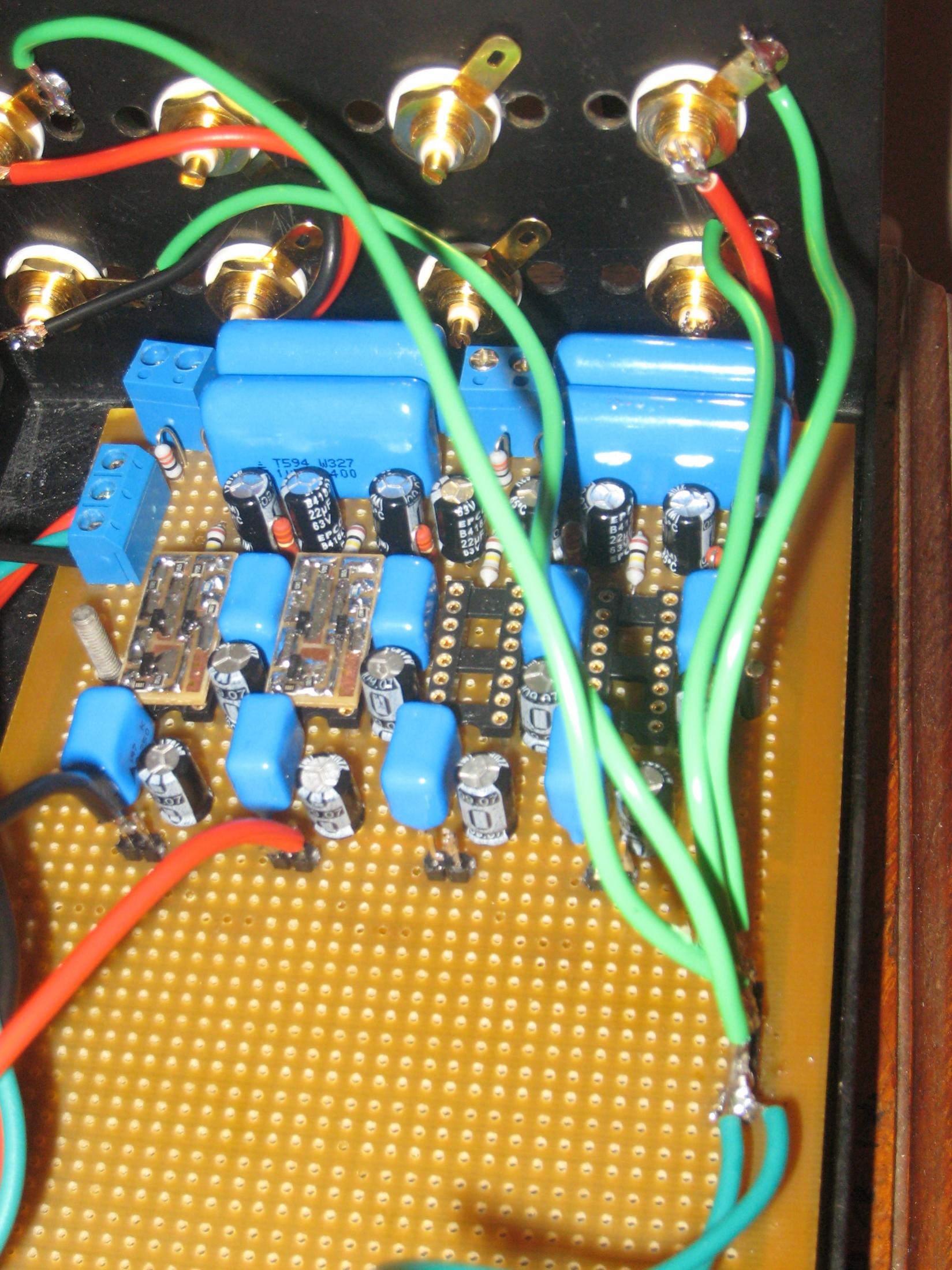

I've just finished rebuilding the four output buffers in the big green monster, using the DIP-16 boards I posted in #130 above. I've only put two in for the present, since until the rest of the crossover/bi-amping project is done I only have two outputs. They got hot, but don't appear to get unreasonably hot. This should solve concerns juma had about long tracks and exposed gates, although there isn't any easily audible improvement in the sound. (Not on a quick listen, anyway.) More importantly, perhaps, I managed to get a much "cleaner" p2p layout on the back, and managed also to put everything in a smaller area on the board, which will be important later and which was for me the main issue. (I only save about 1/2 in, though...)
In case anyone would like to try this out, I've attached a .pdf file,which is the mirror-image of the copper on the board - ready to print out and iron onto the copper. I'm sure many or most of you could improve on it, though, if you had a mind to...
As always, all comments are welcome.

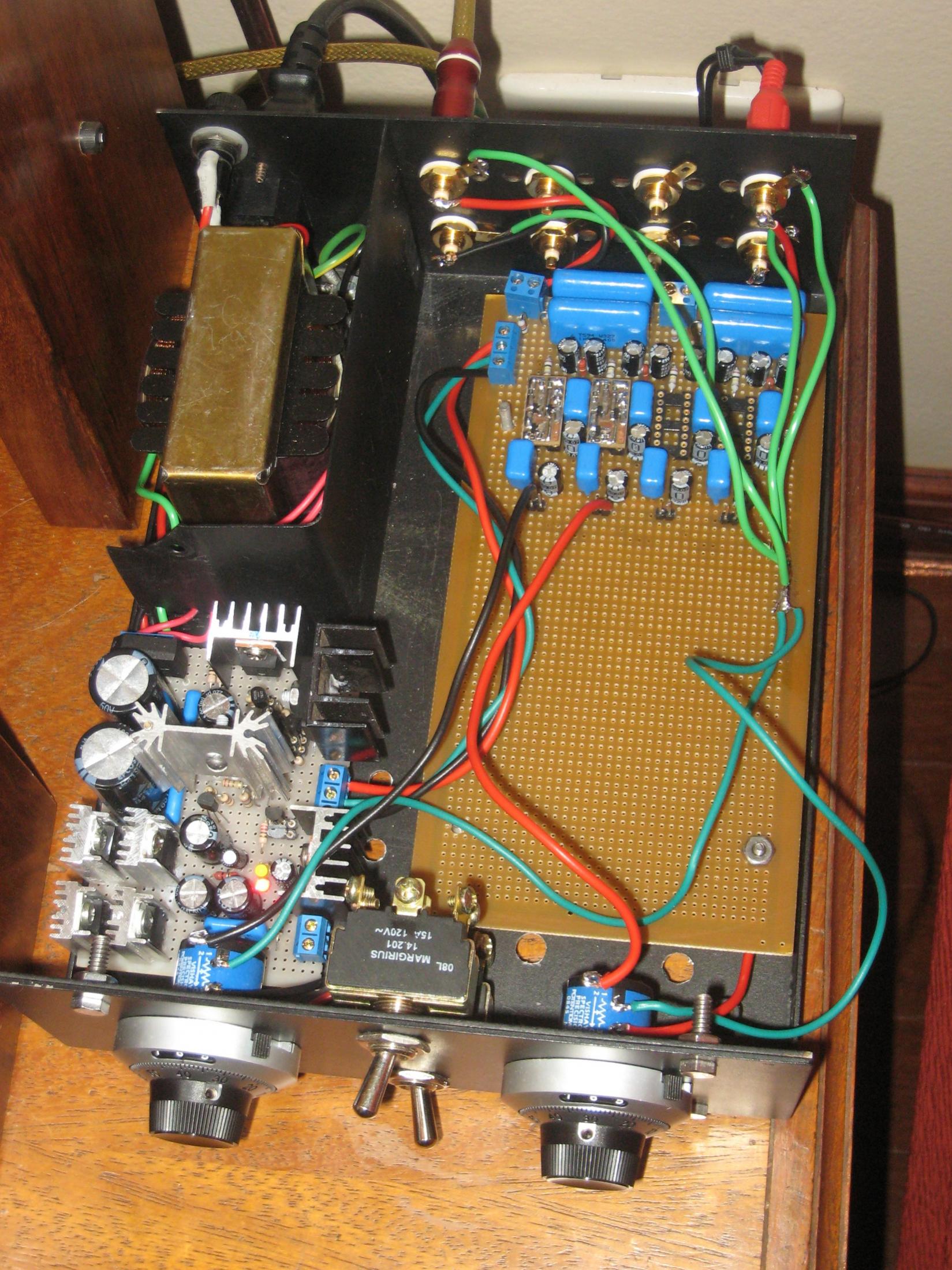

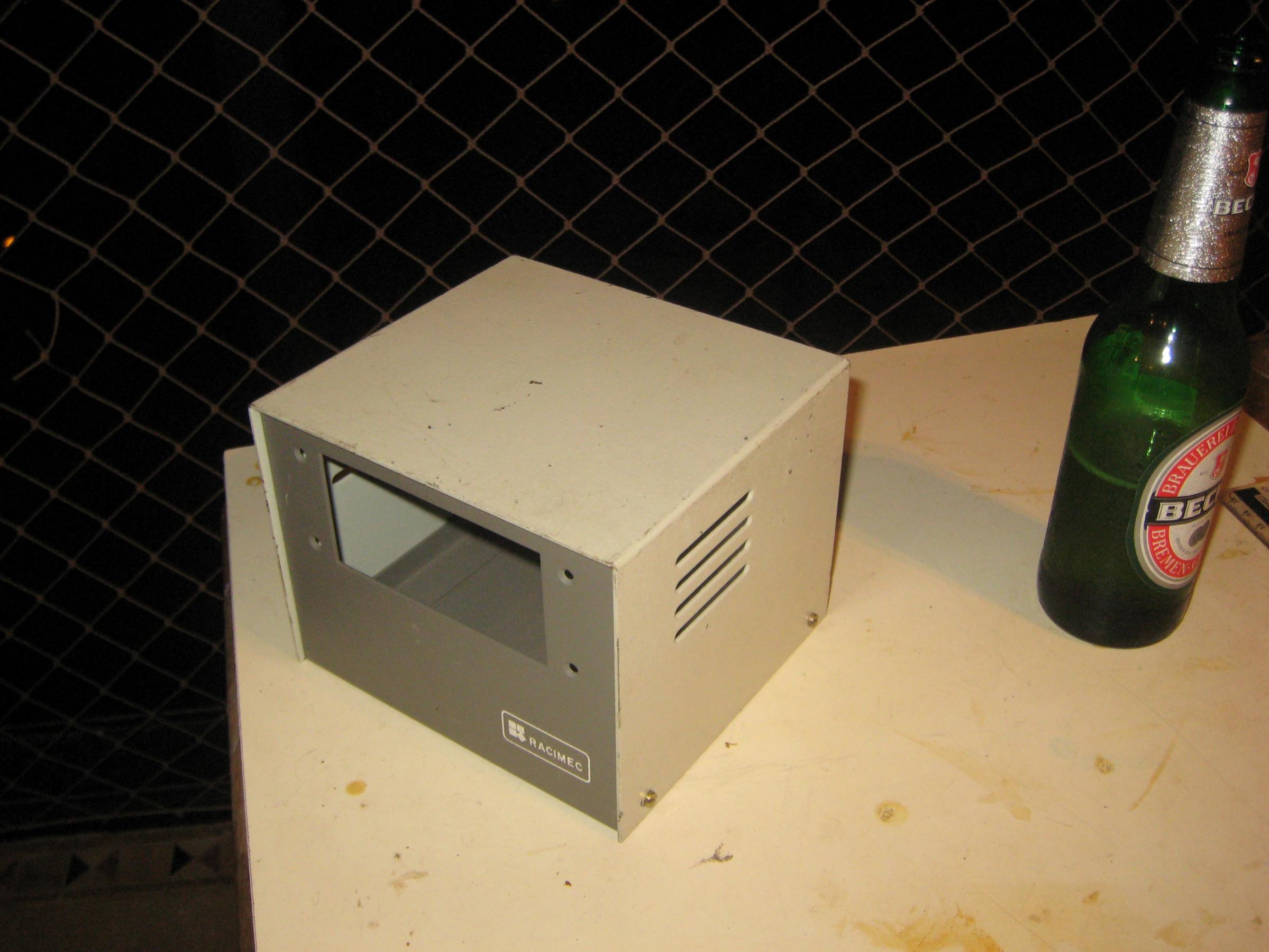

Hi Guys,
I mentioned above that I now have several surplus boards soldered up, enough to make three extra stereo preamps, which I am thinking of putting into boxes for non-diy friends. The catch is that I don't want to spend a fortune on these, so I spent a couple of hours going through the stockroom at the Elec. Eng. dept. again, to see what I could dig up to help keep cost down. (I've mentioned elsewhere that I can sometimes get NOS/used/surplus stuff there... It's like Aladdin's cave...) So I lucked out and got two really nice 10-turn 31k wirewould pots ("Clarostat" is the brand name on them, which google indicates is now part of honeywell). These will do really nicely for the one I'm planning on keeping for my office system, but I was less fortunate with the others. In fact, most of the pots look worn out, or aren't sealed and are just too dirty to consider. I did find a really nice pair of miniature sealed pots, which have a really smoootthhh action (maybe conductive plastic?) but they are only 5k. This sounds a little low to me, what do you guys think? The idea is to put them before the preamp circuit just as Nelson has them before the bufer in the standard B1 article. I presume their value only makes a difference by defining the input impedance, right?
I'm probably gong to do the PSUs for these "giveaway" amps with IRF9610/610 9620/620 or 9630/630, since these are widely avaiable and cheap here. Anyone have any suggestions or preference? Or strong reasons to stay with IRFP044?
Cheers
Nigel

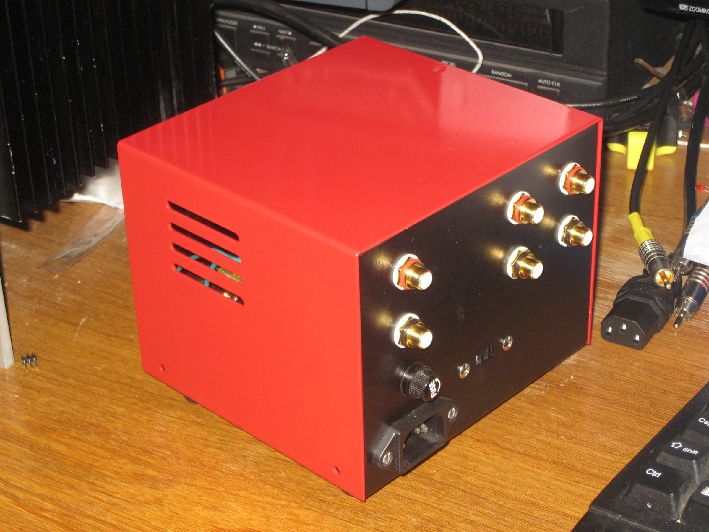

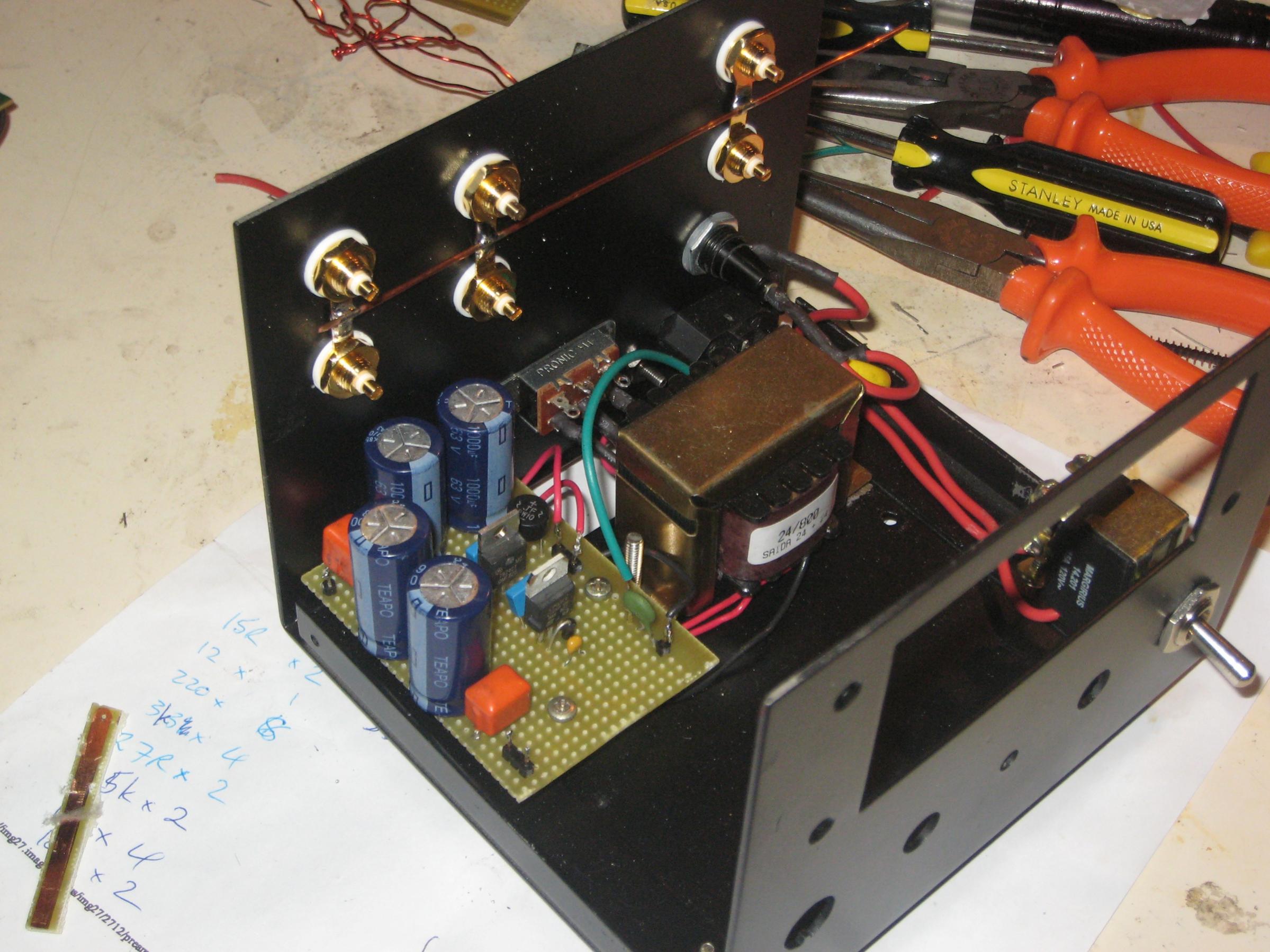

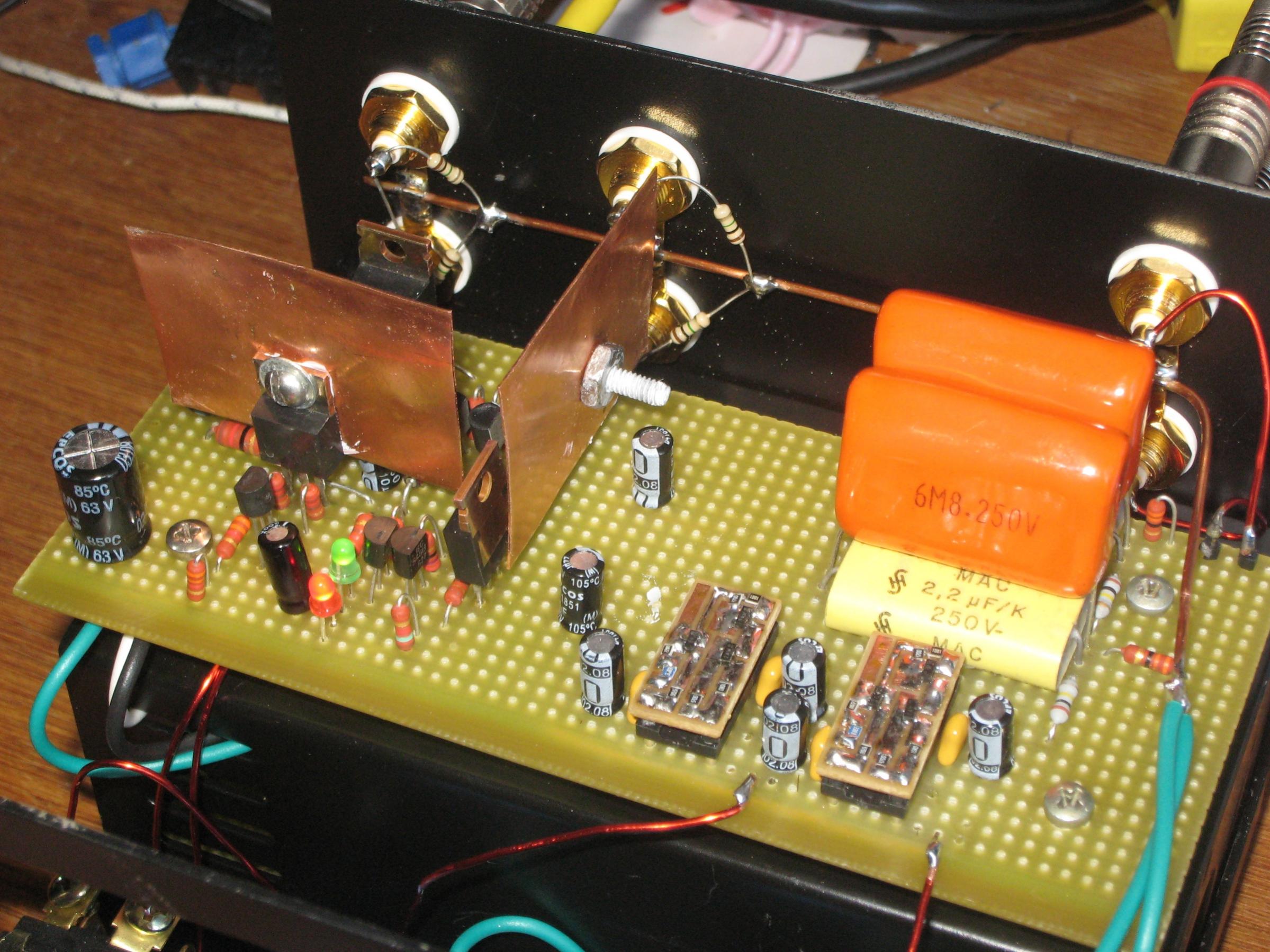

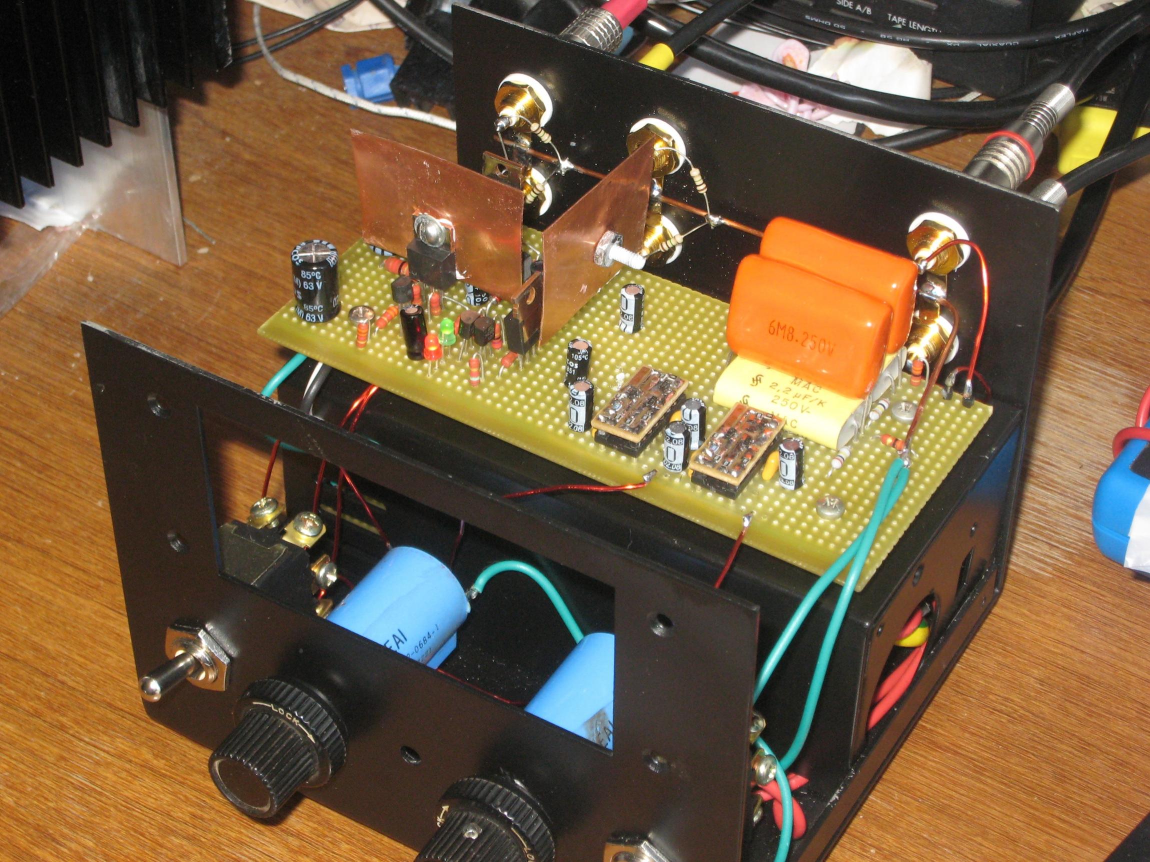

Hi Everyone,
I mentioned above I was thinking of doing more of these - here's one I just finished for my office system...
Sorry massimo, I just couldn't help myself...
The preamp uses two of the boards I showed above, a 24 - 0 - 24 Vac trafo (with 7924 and 7915 regulator preregulating the negative voltage), and except for using a pair of LEDs instead of the 3v9 zener in the negative PSU is juma's schematic posted above. The box is 1.5mm steel box from something the Elec. Eng. dept. was throwing out; the transformer and preregulatoers and smoothing caps are under a screen/shield, also 1.5mm steel, although in this case cut out of an old (VEEERRRYY old...) computer PSU chassis. I went out of my way to keep costs down on this one - 10-turn 31k pots for left and right volume, output caps, brass standoffs, steel boxes and several other bits and pieces came from the Elec.Eng. junkboxes (many thanks to Cicero and the guys there...) I'm pretty happy with how it turned out. I still have to put a plexiglass window on the front, wire up the second input, and put a (red!!) LED on the front to show power.
The sixth photo show it with the BF862-mini-Aleph-J its powering...
Did I mention it sounds great?
As always, (constructive) criticism is very welcome.
Cheers
Nigel
