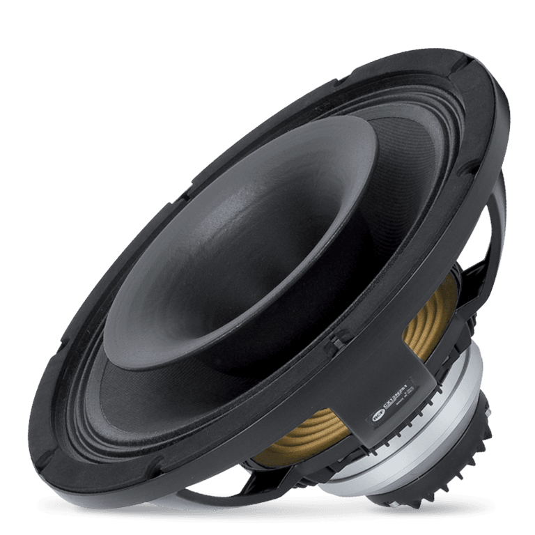

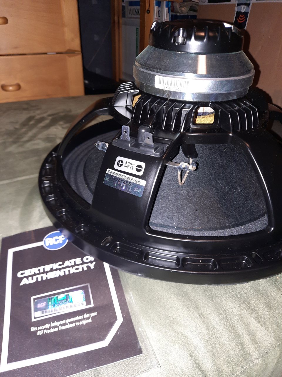

Big coaxial with RCF CX12N251

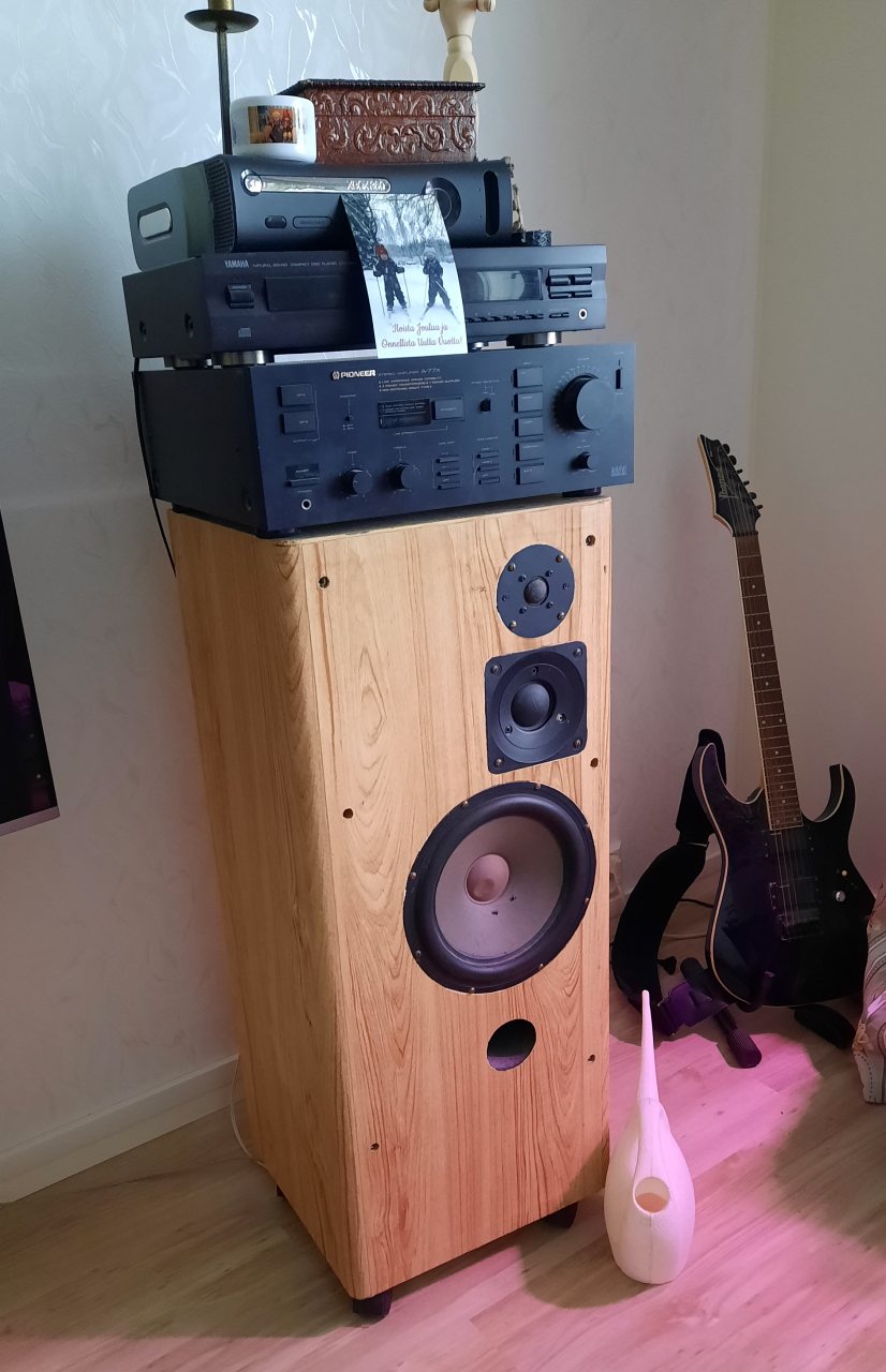

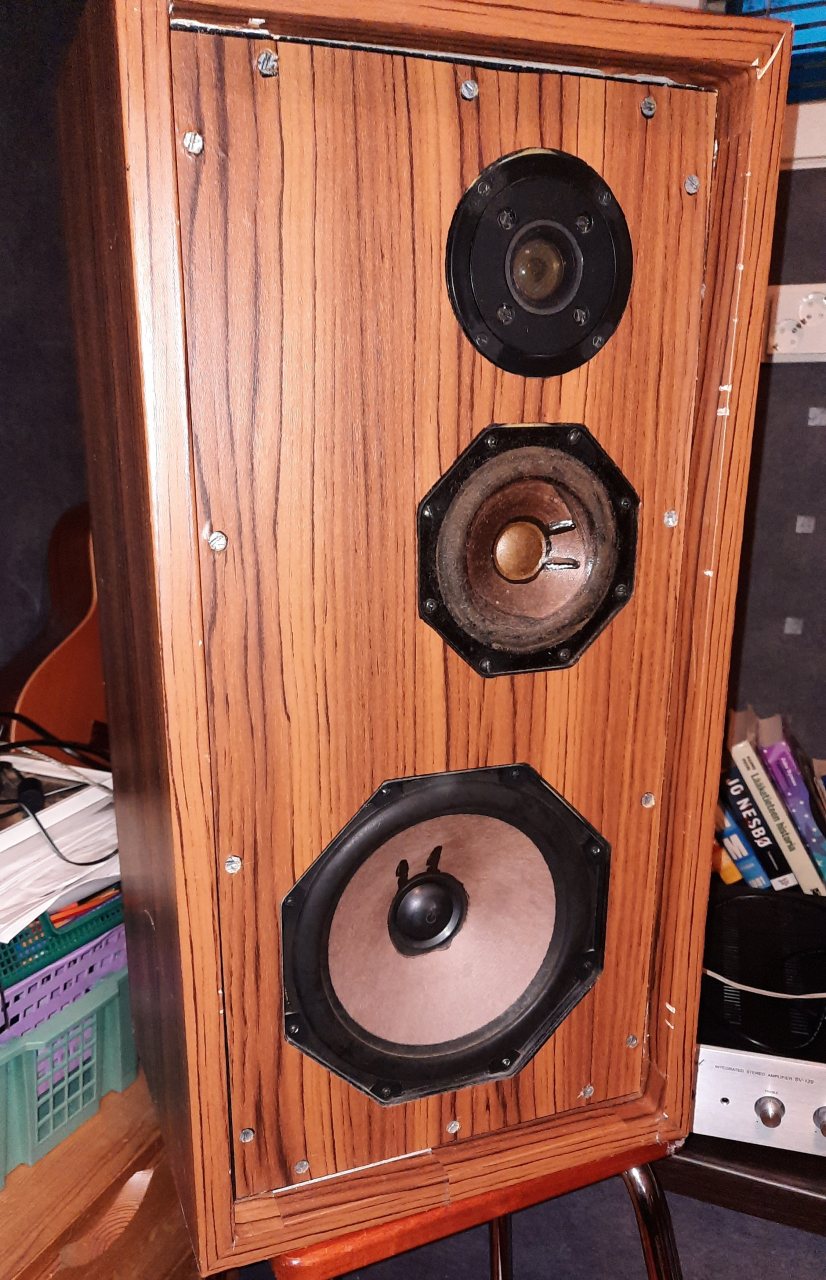

My first hifi speakers (kit) 50 years ago had a detachable front panel! In another pic we can see my elder son's present speakers, done by me only 40 years ago, also a kit.

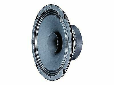

Visaton W300 is my second choice now, but is the surrond rubber or foam? https://www.visaton.de/en/products/drivers/woofers/w-300-8-ohm
in any case, the woofer choice is easiest and least critical to me. The problem is that there are millions of options!

I did some really crude abec sims to model that gap between the woofer cone and the baffle. Without any treatment you get a big discontinuity. The best result I got was to assume that the gap was filled with felt which would keep the HF out of the gap between the woofer and the waveguide and act as an acoustic low pass filter for the woofer crossover. Easy say; harder to do - have to find a felt thickness that works and a means to keep it in place.
This is why I usually shy away from coax drivers using this design with the cone shrouded by the horn. You have to keep the xover very low, well out of cone breakup area. This often means an unacceptably low xover to the HF driver, further negativity impacting system SQ. The larger unsupported horns will also tend to resonate at various frequencies.

That is the issue. If you can solve these problems/potential problems, you get a better solution because then woofer cone excursion doesn't FM the tweeter and you don't need a separate woofer to relieve the coax of the excursion. If you are going to use woofers in addition to the coax, then you are probably better off with a coax in which the woofer cone serves as a waveguide. We know KEF and SICA make nice small coax's. Its harder to find large coax's with clean top ends, although I agree with Zvu that BMS looks better than most. It really depends on how equalizable that ripple in the HF is and you can't see that without a set of measurements.

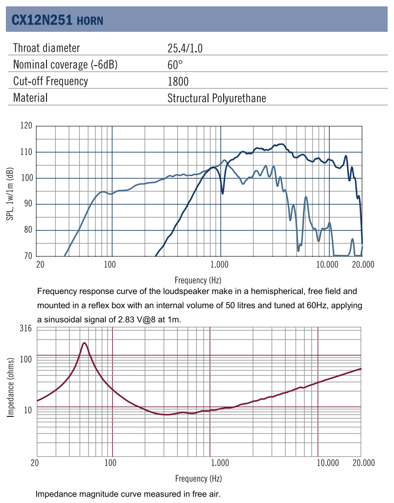

RCF coaxials are on their way to me already. Let's see how they measure. Home spl should actually be pretty easy task even for 1" CD.
My guess is that a plastic horn has less vibrations than a 12" cone playing music...

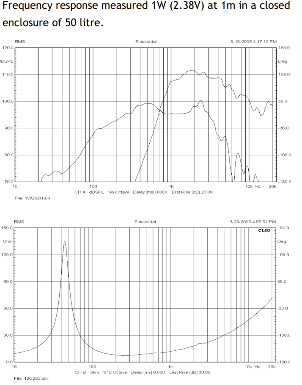

I don't know how reliable factory measurements are... RCF is in BR box, BMS in sealed. I expect that 1kHz dip to disappear off-axis. It is obviously interference from the horn, every horn coax has similar, depending of diameter. This RCF has the widest horn I've seen in 12" Audibility??

Sorry OT but some of the earlier comments about the big horn on the RCF CX12N251 speaker with its huge horn almost completely obscuring the cone led me here.....
Reactions: vineethkumar01

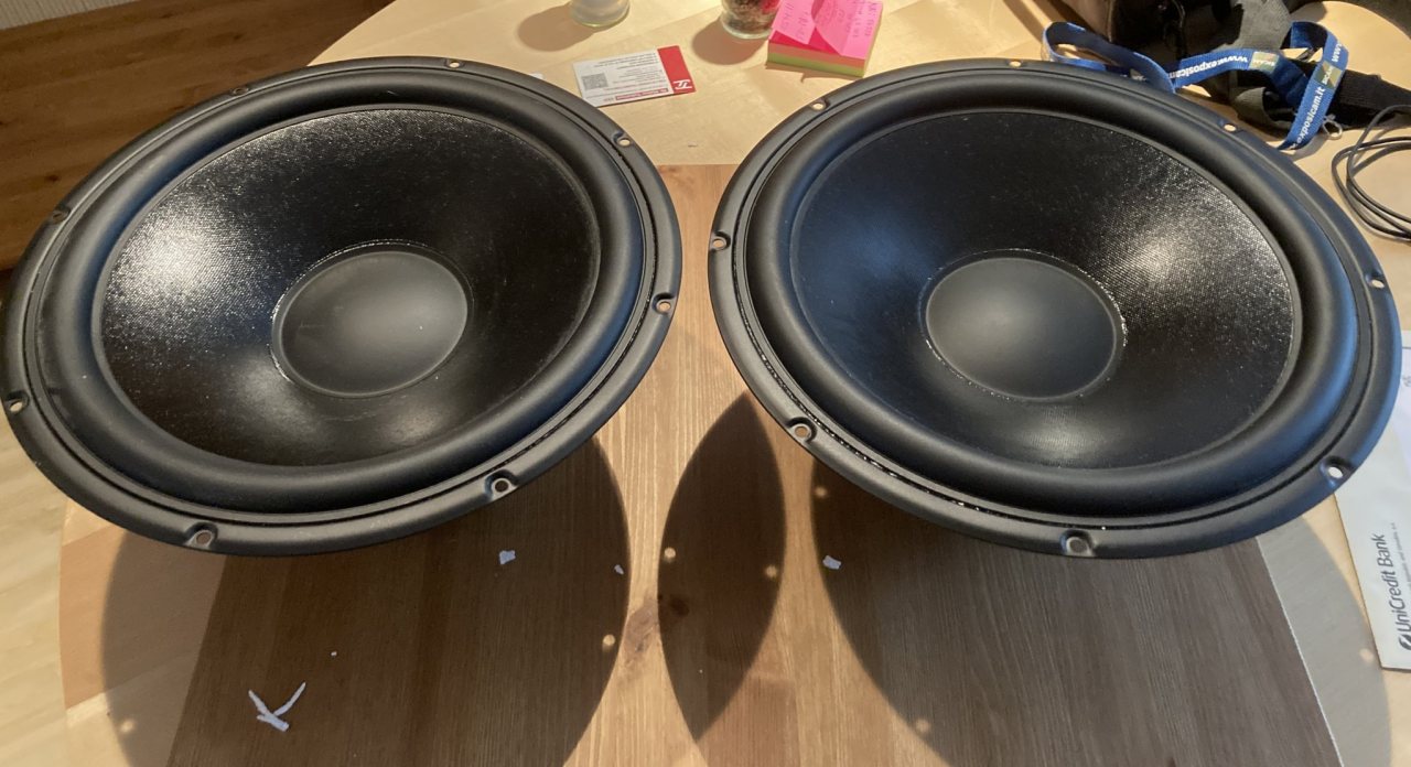

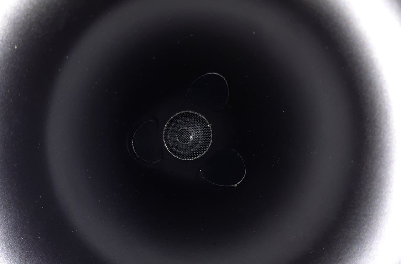

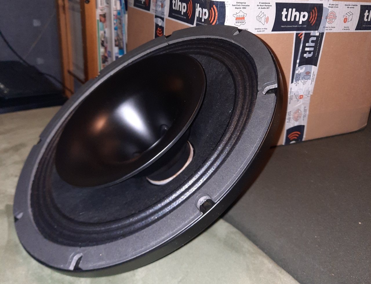

I received the TLHP parcel today and I'll buy four SLS-12 drivers from Peter. I have next week free from work (except for Wed) so I hope to have time to make a simple test box for the coax and start taking measurements for xo. Sensitivity of the CD makes me wonder if I must make a Lpad to avoid noise. I have some leftover resistors for that, values shouldn't be very critical for active setup.
