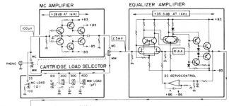

The load sockets are to use with MM or MC carts. If you need more Capacitance for your MM carts, you can add a capacitor there, or if you need 400ohm for you MC cart, you can add the requisite resistor there instead.@Bigman80

I have a question regarding “LOAD” positions, left and right, on board - what is the function?
Could you explain me a little bit, please.
Kind regards.
S.
I usually install RCA socket and make loading plugs to insert with whatever value resistor I need, soldered to the RCA plug.
The load sockets are to use with MM or MC carts. If you need more Capacitance for your MM carts, you can add a capacitor there, or if you need 400ohm for you MC cart, you can add the requisite resistor.
Or you kan add a switch to make it variable .
AbsolutelyOr you kan add a switch to make it variable .
OK, RCA plug with resiestor or capacitor.
You add whatever values are required fornthe cartridges you have.Does anyone have any idea regarding the values of resistors and capacitors if make it variable with rotatory multi contact switch?![]()
Do you have some “know how” example to help me?
Thank you in advance.
I have used 6 posision multi swich with 10-47-100-248-474-1000 ohms resistors.
Thats for my Denon 2 MC pickup.
And for MM-?
