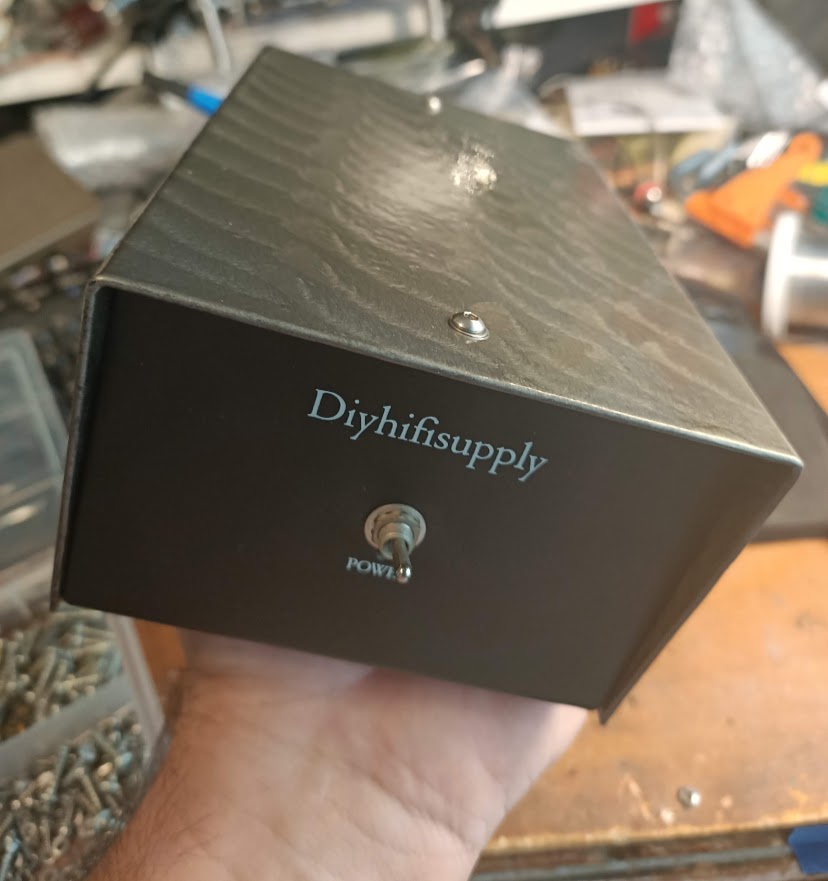

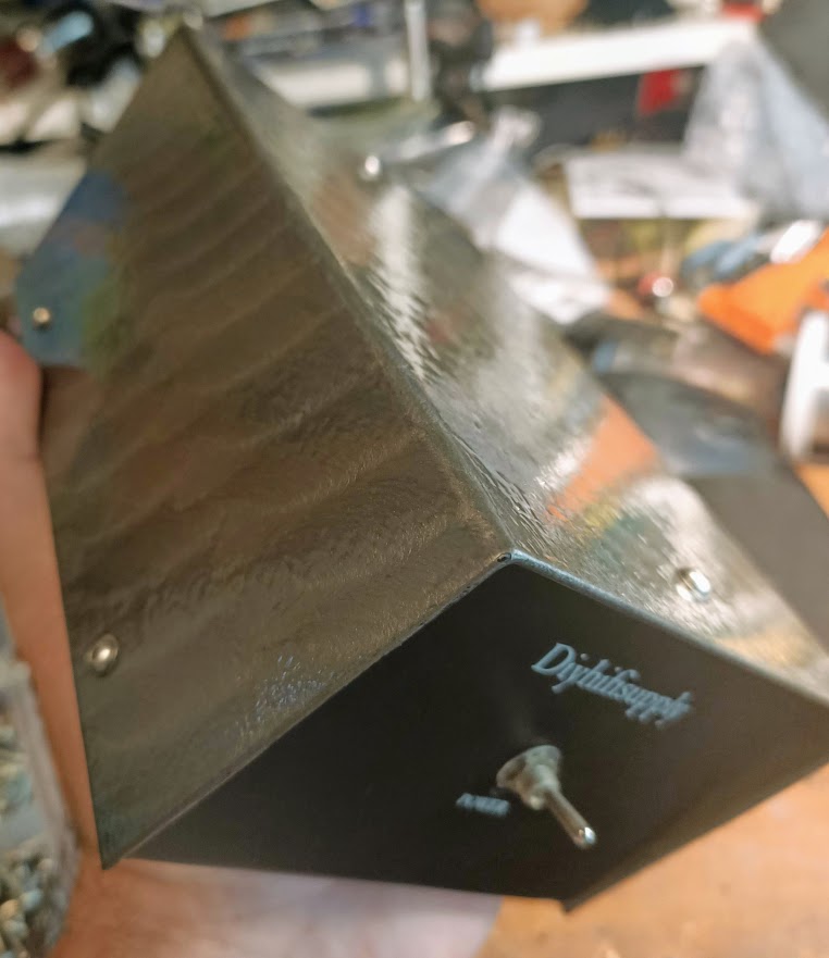

In other news. Transformer enclosure pimped, locked and loaded!

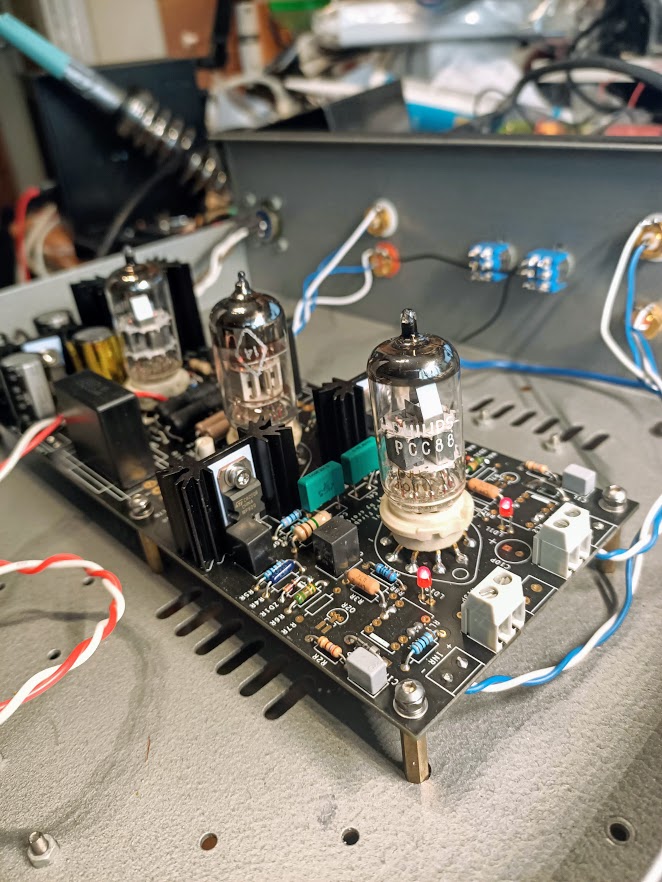

Bigbottle phonostage done, fixed to the enclosure and all wired up. Now I just need to find the cover somewhere in my house.

Looks a tidy job that, BasIn other news. Transformer enclosure pimped, locked and loaded!
Nicely done!
