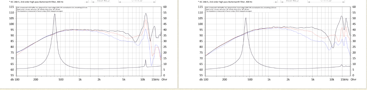

The M74A is the perfect candidate for a passive notch. The resonance is strong and wide and occurs at the same frequency for all reasonable off axis angles, so notching it will have a similar effect across all angles. It also extends down towards 8K so removing it has much more chance of being audible.
The M74B does not have the same consistency across angles in the highest peak, is not as strong or as well defined and is another few K up in frequency.
The impedance traces show the magnitude differences between the resonances quite well.
Double peaks are much harder to suppress with passive filters. The M74B really needs DSP to get every little bit of bandwidth its capable of with a more shallow LP, but you shouldn't cross them that high anyways if you want good power response. The off axis irregularities pose an issue when trying to find a compromise. Its better to just steer clear of the breakup area altogether.Do you mean in the first post of the thread? Oddly, those links seem to be dead. I'm familiar with the HiFiCompass measurements for these drivers. My question had more to do with any experience they had utilizing the passive parallel / series notch technique to these specific drivers and the sonic results of doing so.
The M74A is more suitable for a passive filter, being it has a single peak and it doesn't shift off axis. This is typical of deeper dome profiles,, but more common with Aluminum alloy diaphragms. I prefer the sound of the A version over the others anyways.
