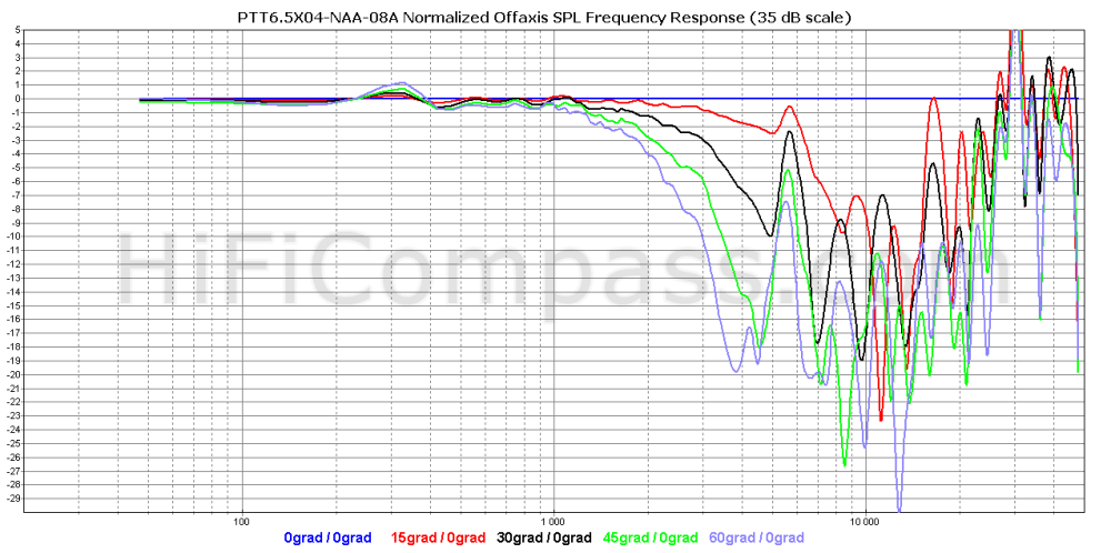

Well Michael I won’t comment on these drivers specifically. But I can comment on something that you may find useful, in terms of why different materials may sound different.
First off I do all my designs with full 360 degrees measurements, usually at intervals of 10 degrees. I feel that this is the current best practice, enabled by tools like (but not exclusive to) VituixCAD and Klippel NFS.
Now the part I can comment on is the bit about “precisely matched crossovers”.
Because I matched, with DSP, a hard cone driver to a soft cone driver (Purifi alu 6.5” to Purifi 6.5” fibre) so that two different speakers, with exactly the same cabinet and tweeter, had exactly the same on axis frequency response.
However, I found that the off axis responses are NOT perfectly matched.
To be clear for other reader following, it’s not possible to control all of the other off-axis responses for the driver- it’s predetermined by the cone/surround and cabinet.
But this, to me, is one reason why different cone materials will always sound different. And no amount of crossover tuning can make them sound the same.
Simply because they just don’t measure the same in 3D space.
I will have to dig my data out somewhere to illustrate this. But in the meantime, here’s a taster of what I mean.
Courtesy of www.Hificompass.com
Relative to the on axis response (akin to what would happen if you could massage the on-axis frequency response to perfectly flat +/- 0.0 dB), this is what a few of the off axis responses would look like at 15, 30, 45 and 60 degrees, for the PTT6.5X fibre cone.
and aluminium cone PTT 6.5X:
You can see that in just 4 different angles, there are differences in the typical pass band eg. 40Hz to 2-3KHz; as well as the stop band (beyond 2-3KHz)
