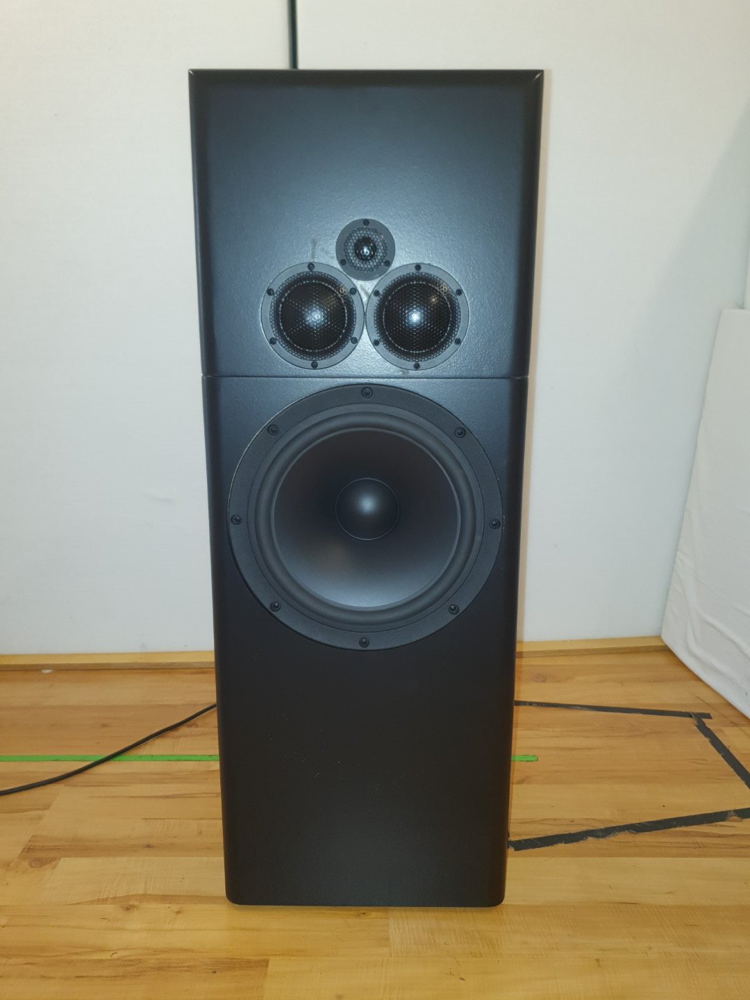

Not sure If I posted it already here - this is the Monster I built for comparisons. Switching time must be really short to reliably hear differences.
Swapping speaker parts and knowing what you hear ... is fine for the customer but your brain will hear way more as just the drivers. (but I expect significant differences between a total S and B setup - would love to hear that)
This is tested in nearfield in an non environment room - there is barely any room influence. Filter is active 4th order.
You can identify the drivers horizontally so for sure it's no perfect test! But the best I could do with short switching times (1-2s which needs the DSP to switch presets).
