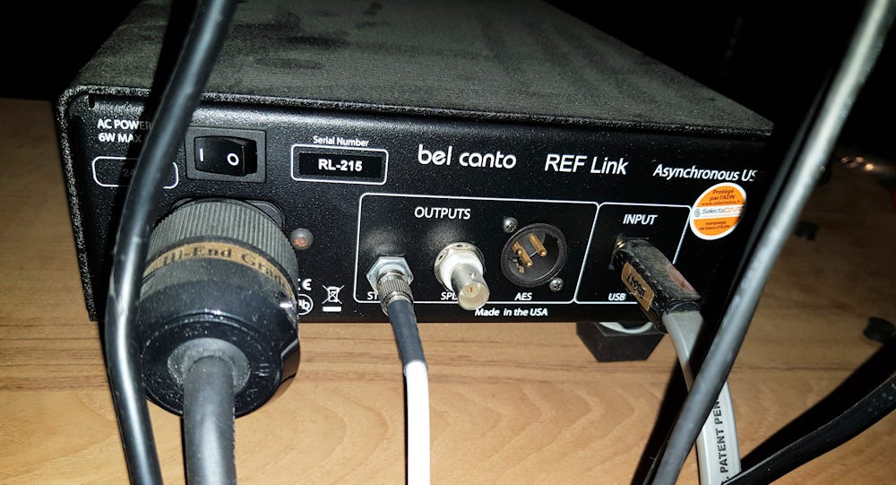

It does: look at the attached photo, it has 1 USB input, and 3 outputs as you say: AES-EBU, BNC and ST.if your source (e.g. Bel Canto Reflink, etc.) has 3-pin XLR AES output, then that could possibly be connected thru an RS-422 or similar differential line receiver chip (e.g. ST26C32ABDR) to drive an ST fiber transmitter module.

I use the Reflink,but the Reflink has jsut a USB input, no Toslink or BNC input.If you are intending to use the Wadia 9 DAC as-is (without modifications) then why not use a purpose-designed single-mode ST optical link from Bel Canto Reflink to Wadia 9's ST input?

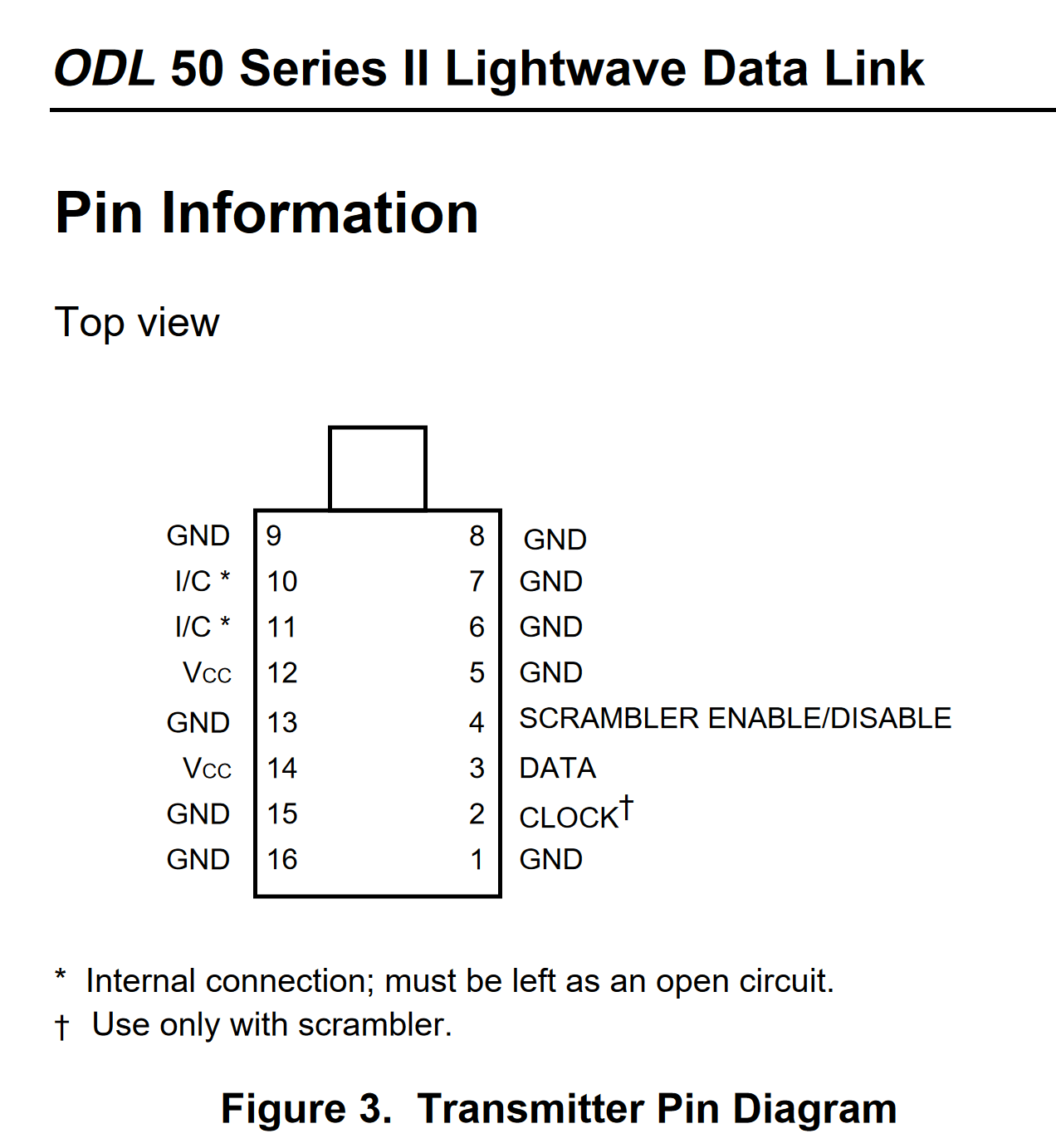

So all you need to do is find the TOSLINK transmitter datasheet and the ST transmitter datasheet and do a mod.
The CTS ST transmitter will likely be the best match with your Wadia. There are available.
https://www.ing.iac.es/~eng/detectors/engineering/sdsu/data_sheets/odl50.pdf

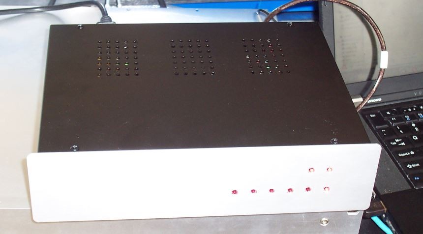

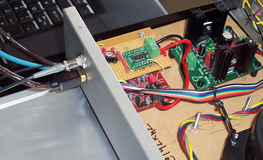

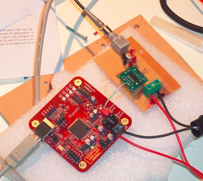

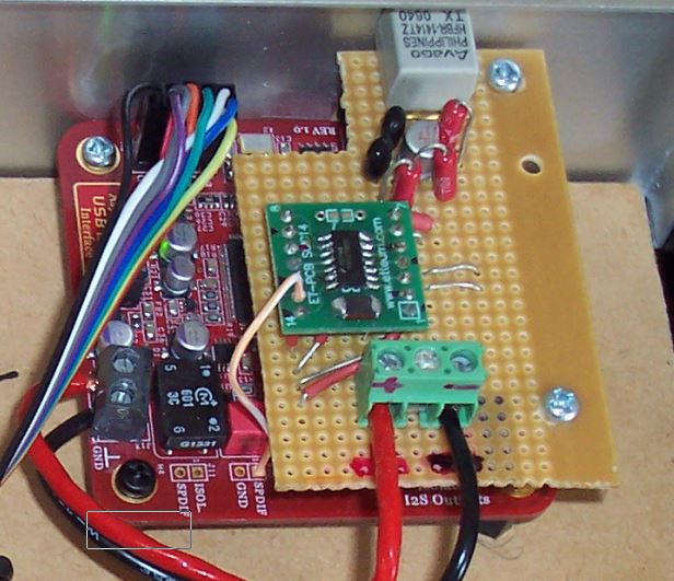

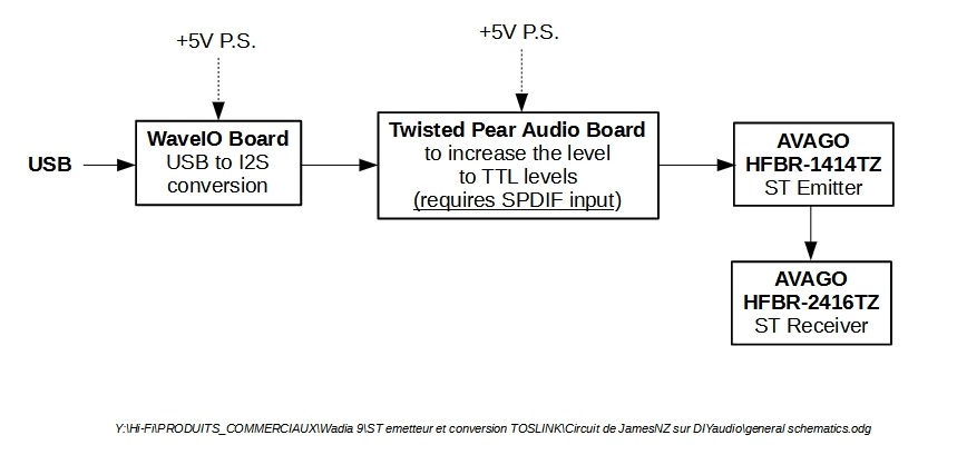

I had a similar situation - I wanted to feed my (old) Genesis Digital Lens via ST... What I did was check the model of the ST receiver in the digital lens, then brought the matching transmitter... In my case the receiver was made by Avago, and the matching transmitter was a HFBR-1414... Then I looked through the application notes on the Avago site, and Application Note 1121 showed transmitter and receiver circuits. I actually got a bit of help here and sent the transmitter circuit to Lucian to see if he thought it would work with his WaveIO, he said yeah but he had to modify the WaveIO to give a higher voltage output (IIRC). I ordered all the parts, and the WaveIO, built the transmitter circuit following the Application Note and it all worked. I have USB in (from computer via WaveIO) and ST out (to stereo). Also FYI I've had different ST gear in the past that didn't mix and match which is why I'd recommend getting the matching transmitter for your receiver.
I found some old photos...

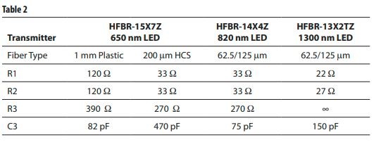

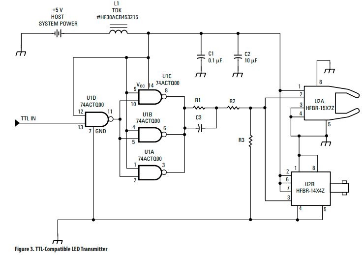

Some more info - the issue with getting the WaveIO to work was the Avago TX circuit requires a TTL signal. Lucian who makes the WaveIO omitted some resistors to give me a high enough signal for this. Obviously you're after BNC or AES input rather than USB, and I'm sure there are any number of prebuilt boards for this which will output spdif, that you could then run through something like the following before the Avago TX circuit: http://www.twistedpearaudio.com/digital/spdif-level.aspx
Here is the application note: https://docs.broadcom.com/doc/AV02-0723EN
The circuit I used is Figure 3...
@JamesNZ: thank you for all this very interesting information: it is promising to build up a solution....
As fas as I understand, your solution converts a USB input to ST output; my understanding is described by the following schematics: see the attached diagram.
Your suggestion seems to replace the "WaveIo board" by another prebuilt board that would convert the [BNC or AES/EBU] signals to SPDIF signal, in order to feed the "Twisted Pear Audio" board. The rest of the diagram would remain unchanged.
One of my Wadia inputs has been modified with an AVAGO receiver, and I am almost sure that it is an Avago 2416-TZ, probably matching with the 1414TZ that I have in my stock (the 2 other inputs are unchanged, so they should use a CTS ODL Series II).
If it is simpler to design a solution using the CTS ODL Series II, then I will by a CTS emitter.
Do I understand correctly ?
If yes, we still have to find a prebuilt board that would convert BNC to SPDIF: suggestions are welcome !
If we find such a board, then I could probably begin to build a solution, under your monitoring of course...🙂
