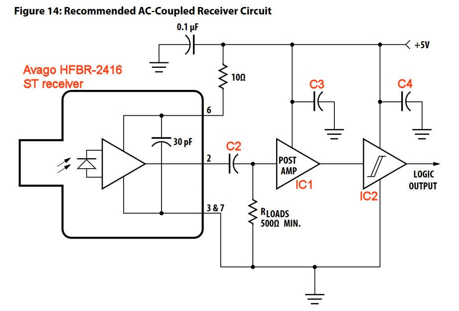

With the exception of the 22R in series with the Transmitter, the circuit shown is exactly what AVAGO advises for a 100mA Transmitter current, .Well, I have spent a few hours to draw back the ST output part: see attached file.
The way the HFBR 1414TZ is connected differs from the official Avago diagram, but I know that this diagram had been optimized to use the 74AC14 circuit.
I have not found more information for the time being.
Have you already seen this diagram with these parts' value ?
I know that it had been published in specialized websites a decade ago, but I have not managed to find it again.
However for the application to transmit SPDIF, they advise to use ca. 50mA.
That's why the designer of this circuit used the additional 22R, which still results in ca. 60mA.

- For your circuit, see https://nl.mouser.com/datasheet/2/678/av02-0525en-1827973.pdf, page 17 for the calculation and page 18 for the circuit diagram.
- In all cases you will need a scope to verify the correctness of the waveforms.

Now have a look at the ST receiver side (HFBR-2416). The Avago datasheet gives a not complete connection diagram (at least for me): see attachment.
What are the recommended values for C2, C3, C4, IC1 and IC2 in your opinion ?
You initial need was to have BNC to ST fiber, true ?Now have a look at the ST receiver side (HFBR-2416). The Avago datasheet gives a not complete connection diagram (at least for me): see attachment.
So, why don’t you finalise this first.
