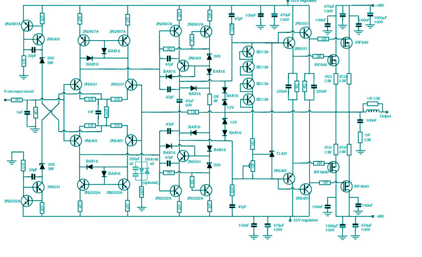

That design you have right there is a fine amp, difficult to sort out, but when you get it going its very good indeed.
Hey, thanks homey
I thought no one would notice with all the blameless activity going on
Hey, thanks homey
I thought no one would notice with all the blameless activity going on![]()
A blameless can sound very good indeed, depending on how you compensate it but that design by stochino is excellent sounding amp, use different mosfets like toshibas 2sj201 and compl. This amp is in my top 3 of good sounding class AB amps of this forum, the irf640 s battle in this application, they just cant dissapate enough heat, that amp is very fast, needs carefull pcb design or it will oscilate. Some of my family members, they are classical music musicians prefer that amp to my electrocompaniets which cost me an arm and a leg. There is a couple of threads and a website that has some details about it. I could dig out the origianal articles of that amp if youd like to read through it. Its called the stochino.
