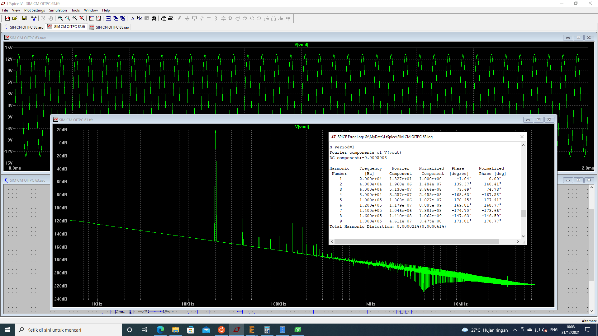

My simulation of this topology using PSU 63VDC. At low level output, 20kHz, 8 Ohm almost no distortion. I use OITPC compensation by Dadod.
