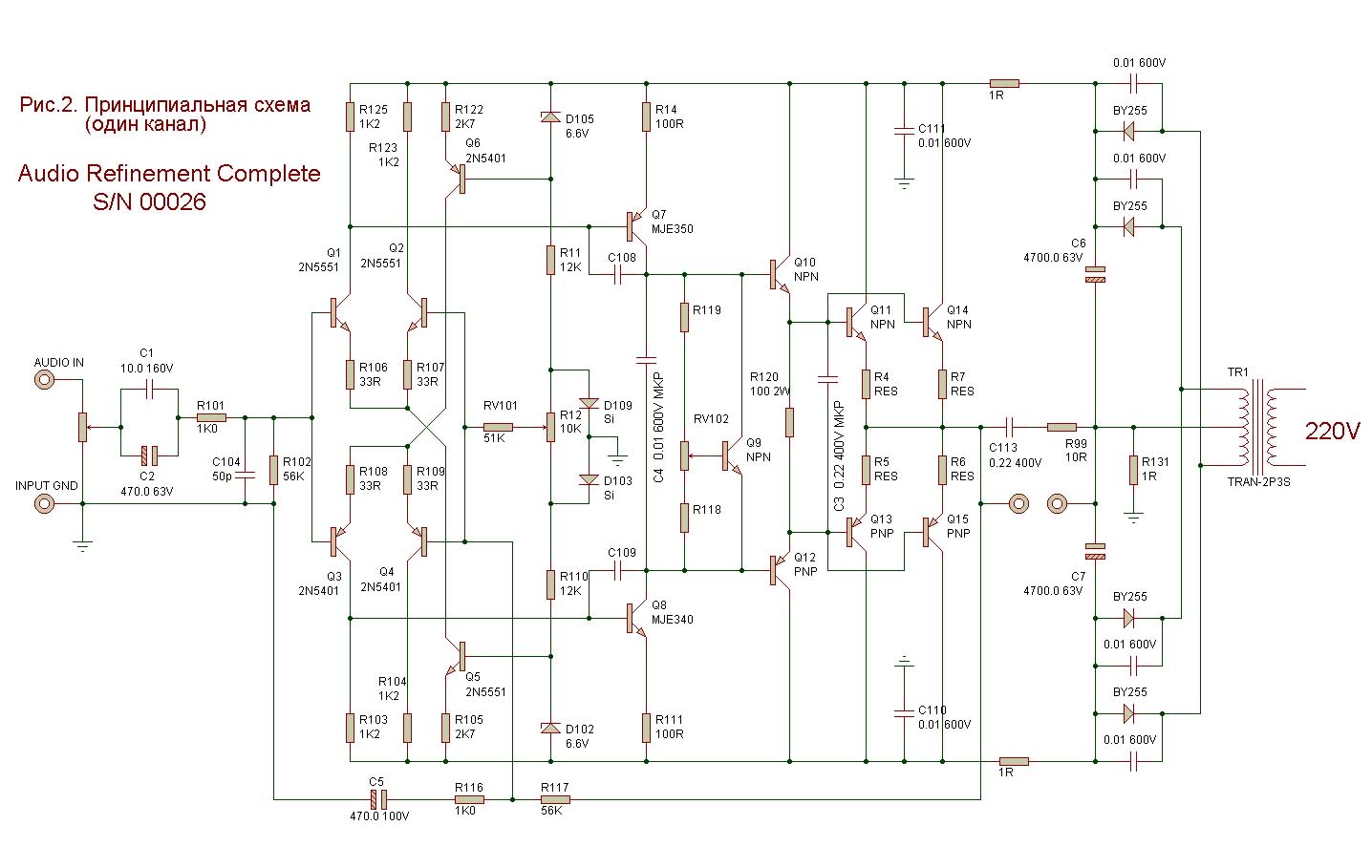

I don't have the Self's book. I just search here and all the blameless amp are what I described.
I can't find any link, attached is what I have, I believe it's "Passion" something. I saw some others but the topology is pretty much the same......Complementary LTP with only resistor load. No beta enhancement VAS, no 3EF. Particularly, I was wrong, it does not even have cascode for the LTP pairs!!!

Schematic like that, should have high distortion. I think you like colorfull sound (high distortion). Then you should design an amplifier with sound effect built in
Threshold and some other designs from Nelson Pass are just as primitive, single ended IPS, no beta enhancement VAS, asymmetrical VAS with CCS on one side. He even came out as said he use high emitter resistance for power transistors that violates the Oliver's optimization. Anyone dare to argue with Mr. Pass and his Threshold?Schematic like that, should have high distortion. I think you like colorfull sound (high distortion). Then you should design an amplifier with sound effect built in![]()

I read his article on Distortion of Power amp. The topology is SE IPS with asymmetrical VAS. I did a search through this site, every schematic I saw in the threads is like that. I don't have D Self's book, so I can't really say anything more. Seems like a lot of Nelson Pass/Threshold circuit are very similar to that.
That's the reason why I asked about why all the fancy circuit when the highly regarded and well respected amps use this basic circuit.
