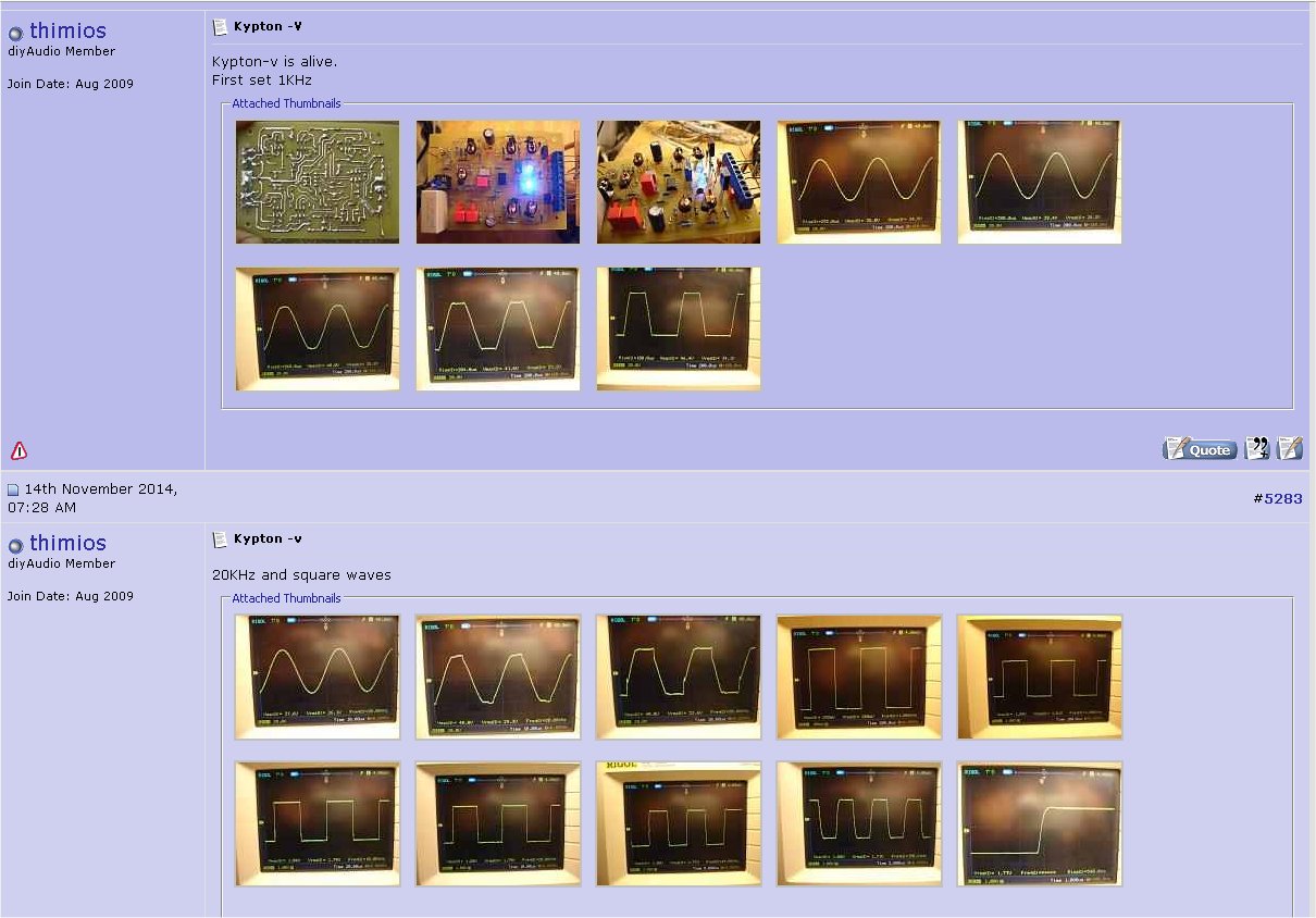

I went "all the way" with this ...(Kypton V2) -
here's the final perfected input stage (with anti-parallel diodes in first stage).
http://www.diyaudio.com/forums/solid-state/248105-slewmaster-cfa-vs-vfa-rumble-108.html#post4126276
Post 5384 has all you need to build it.
Thimios scoped the "non- diode (clamped)" version 2 (below)
"Sticking" on saturation until we clamped the 1st stage with anti-parallel
diodes.- then it was quite good.
Post 5282 on .... this ips was perfected.
Vzaichenko's "tubesumo" is also this topology with a 12au7 valve for first
stage.
OS
