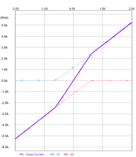

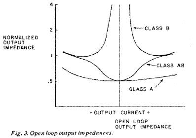

There is no difference with heavy idle current that you displace the kink of the curve away from the center. How far you move the kinked area depends on how much idle current you have. This is exactly the same whether you use a CCS to pull in the Self XD or just simply run higher idle current. There is absolutely no difference in the displacement of the kink.
This is not correct. Even with full class A biasing, the 'kink' (however small) is still smack in the middle of the transfer curve.
There are many of these curves as a function of Re and Ibias in both Douglas' and Bob's book, and they all show that.
See, for example, attached 'kink': when you inclease Ibias, the kink gets smoothed out but does not move from center. Viewed from another dimension, it closely mimics the so called 'wingspread' plots. They may vary in shape but are always symmetrical around zero (assuming complemetary output stage).
Jan
There are many of these curves as a function of Re and Ibias in both Douglas' and Bob's book,and they all show that.
Jan
Don't think the response of the XD is flat at the center. You pull current with the CCS, when you drive a load, the current through the top NPN is going to vary from the CCS current to zero when move from the center to the offset kink. If the CCS is pulling 1A, the NPN current vary between 1A to 0 just moving from the center to the kink. r'e change big from 26mohm to infinity( say some high value) during the transition. This alone will create distortion. remember, the PNP EF is off with the CCS as long as the load current does not exceed the sinking capability of the CCS.
Back to just the kink, I am talking about using higher current. Of cause if you bias with 50mA idle, the kink is very close to the center and severe as show in Fig.10.31. BUT if you bias at over 200mA, the middle is a lot broader and smoother as shown. ALSO, the worst part of the kink is beyond the kink of the XD for the same bias current. There is no other way about this.
If I want 10W of class A into 4ohm, I bias 5 stages to 220mA each, I avoid most of the kink in the normal listening level. BUT if I run XD, the bias has to be DOUBLE to move the kink as far.
In another words, if you set the CCS of the XD to low current like 100mA, you are not moving the kink much off the center. You easily hit the crossover and you get distortion. You will have to set the CCS to 400mA in order to move the kink as far as if I set the Class AB to 200mA.
If you use 5 stages like me, you'll almost never hit the worst part of the kink with total bias current of 1A to 1.5A. To match this with XD, you are going to have the CCS to pull 2A to 3A respectively.

Alan I think we don't disagree. I took exception to your statement that Ibias can move the kink off-center but probably you meant XD - agreed. Not so for 'regular class A/AB/A of course.
In XD, the CCS sets how far the kink moves off-center and thus how far the output can go in class A before moving into AB territory. This is also the case in regular class AB. In regular AB the class A area is around the center, with two devices involved; with XD the class A area has only one device involved. I don't know what the difference on performance would be. For instance, is there a difference in 'Gm doubling' in the two cases?

Thanks for your detail reply.
I should clarify, I don't mean the kink actually moves away from the center in Class AB with higher current. I should have said "if you look at wing spread graph of the of Fig 10.31 in page 278, the higher the current, worst changing part of the curve moving away from the center SYMMETRICALLY on both side. This leaves the very flat part in the middle.
It is the worst part on the graph of the heavy biased Class AB that I am comparing to the XD. Yes, I agree it's my bad that I did not explain what's in my mind.
Also, if you look at Fig 18.10 in page 459, XD is no better than Class AB until they get into high signal level where both are in Class B( not self Class B) area which is above -7dB in the graph.
the point I am trying to make over and over is if you waste the extra current for the XD, why not go for heavier biased Class AB so you can push the graph of the AB in Fig 18.10 further to the right so you get lower distortion at higher level than XD.
Also, Self was talking about the CCS draw like 1A. that is a BIG DEAL!!! I am working on the heat dissipation when using high bias current of 1A to 1.5A in my 5 stages in parallel. even at low rail like 25V or so, the dissipation is over 60W at idle. This is for 5 stages to spread the heat. There is no way you can pull 1A with the CCS if you have only one NPN on the top. You smoke the NPN right away.
Sorry about the confusion, I did not mean the actual kink of the Class AB displace off center, just the worst part of the graph move away symmetrically away from the center leaving the flattest part at the center.

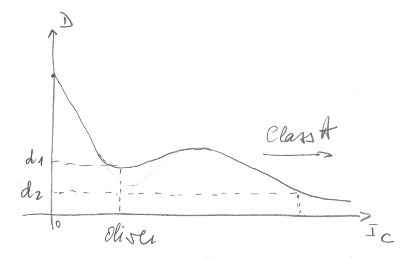

Hi Mr Cordell,
If you don't use resistor below 0.22ohm, then how are you going to satisfy Oliver's condition if you try to run beyond 120mA of idle current per stage?(120mA produce close to 26mV across 0.22ohm)
Simply as that: you don't. You may want to get the bias to point d2. The ridge between the Oliver point bias and class A corresponds to the gm doubling region (I guess you still do not have a grasp of this concept, it was mentioned several times in the last 24 hours). Physically, far up from the Oliver point, the transconductance peaks for the two halves are becoming broad enough so that their superposition is negligible. As a result, distortions are decreasing towards class A.
Because of their different conduction mechanism, power mosfets do not exhibit such a ridge. There is no optimal bias point for mosfets.
As a personal preference, I would definitely not get in the d2 bias point - IMO it's a poor trade between distortions and power dissipation. You either stay (at, or slightly over) the Oliver bias point, or you go deep class A and pay the full price. In d2 you will burn tons of idle power with very little benefit for the distortion performance. I think it was Mr. Curl that built in one of his commercial amps an externally switchable bias, one corresponding to the optimum Oliver bias, the other somewhere around d2.

Thanks for the reply. do you have any link that explain more on this? I want to verify with you how I understand this. Attached is your graph with my notes.
1) At 200mA with 0.12ohm, I have 26mV across the Re. this is Oliver's optimization.
2) At 200mA but with 0.22ohm, I have 44mV across the Re. This moves into the GM doubling region. BUT because of the high bias, the kink is so smooth out that the distortion is not that bad. It's a little more as shown in your graph, but I do have a broad Class A region.
3) At point D2, the smooth out of the kink is so good that even though GM Doubling, it's still better than Oliver's optimization with 0.12.
My questions are:
1) How to determine D2? What mV across Re?
2) From your graph, sounds like distortion only depends on the bias current. Just want to check whether D2 be achieved keeping 200mA, but increasing Re to even higher than 0.22ohm? Or it is purely depends on the current.
