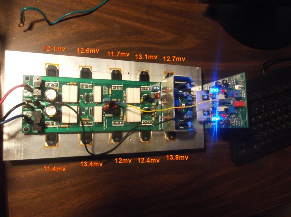

I remember you said you use lower than 26mV. I never quite get that. What is the reason you don't follow Oliver's condition of 26mV?
I've seen the "glitch" at < 30ma , Sanken's will be good at 50ma (OEM
recommendation) . the ON's , since I'm runnin' so cool , I went to Jwilhelm's
15-16mv setting.

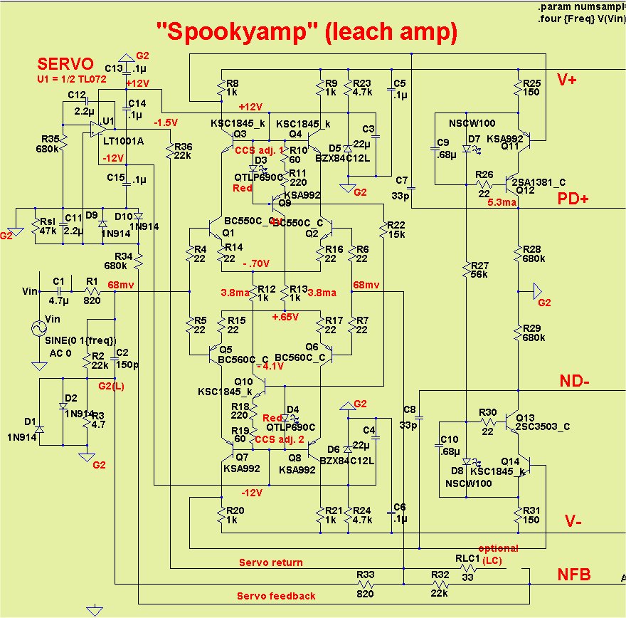

I just had a open loop condition on one of my amps. The feedback wire
broke inside of a piece of heat-shrink. Spooky went to either rail -
Protection flashed "hard" (shut off speaker) - that "21'st century" just paid for itself again !!
Either blue led cascode reference would be on or off if I touched the PCB!
The LED's told me the problem. The input stage CCS red reds would stay on
regardless.
So the combination of red/blues told me exactly what was going on
with this fault.
Fixed the wire , neither the OPS or IPS went up in smoke !!
Over designing these modules seems to have worked out.
Very strange I did not smoke this IPS going open loop ? (I've done this before).
Perhaps it is the conservative aspect of the design ? (below)
Sucks to have to troubleshoot something that works so well.

I did not match - (below) is the 72V readings on the worst of the two amps.
The spread of the readings was about 1/2 (under 1.5mv) at my test supply
(45V).
.22Re - about the same cold to after heavy (I mean real heavy ! ) use.
OS
