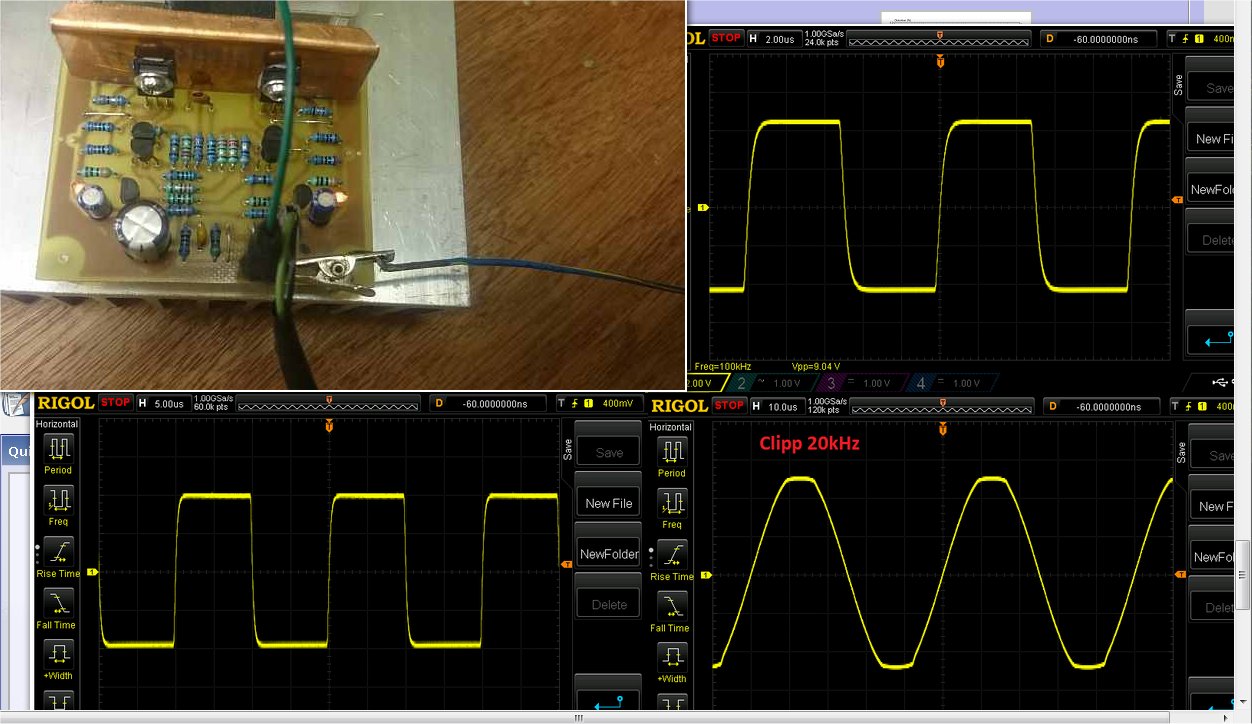

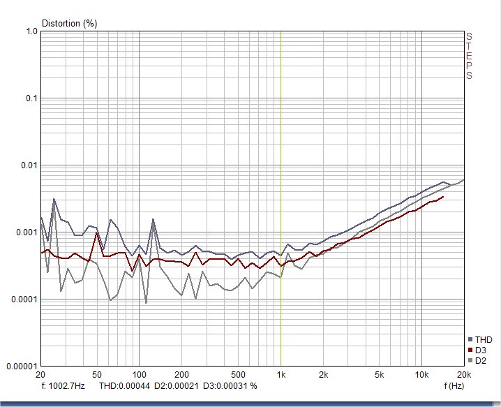

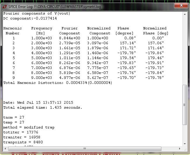

Simulation vs. "real world" ....
Back a hundred posts , there was doubt as to the accuracy of a simulated amp.
(below 1) is the 1K thd simulated. (below 2) is a sound card test.
The limited sample rate of the PC's ADC (should ) not give reliable
>10Khz results. The simulator tells me I should have <20ppm , even at
20K and a much higher power.
I'm sure an AP would show much better >10K.
So , the sound card is mediocre. The blameless test I mentioned at 5ppm/20K
was a VERY expensive setup. Most likely still short of an AP.
The 1K test tells me a lot. If 3-4ppm is exactly the output
from the real amp (and simulator) at 1K with a given set of models , so should it be
at 20K.
(Below 3) the scope tests also coincide with the simulator. If 100K
is that smooth , I'm sure a measured AP would possibly be better
than the simulation >10K .
BTW - this is 10 device symmetric "abomination" .... NO "can of worms"
or any other "errata" . In fact , would most likely be more robust in
an abusive environment.
Full test is here - http://www.diyaudio.com/forums/solid-state/248105-slewmaster-cfa-vs-vfa-rumble-165.html#post4390928
PS - this is the "entry level" input stage. was not designed to be a ultra
low THD-20k input stage.
OS
