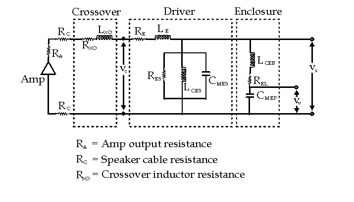

On a typical speaker , you have an quite a complex electrical equivalent (below).
Not just a big power resistor or simple R/C load usually tested with.
An amp with low THD into a resistor is fine .... but would this
be degraded by all those L/C/R's ?
Not to mention damping factor (and speaker wire).
I'm sure you lose a whole lot of them PPM out at the other end of that
speaker wire , and most likely within the X-over.
Hey , my amps have a separate NFB wire - but would I want a 3'rd wire right
at the woofers (+) terminal ?
PS - could at least eliminate the speaker
wire (with NFB).
