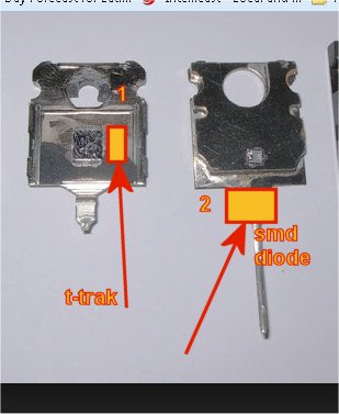

been sensing top of output transistors for over 30 yrs, also to-92 glued to collector lead, much faster than waiting for heatsink and since low power is in the path the thermal resistance does not develop much delta.

A.The ThermalTrak diode basically measures the heat sink temp.
B. BTW, have heard rumours that ThermalTraks are going to be discontinued. Anyone know anything?
A. measures the slug temp. that would be much faster because of distance
(below - #1) and not having the insulator/heatsink thermal resistance.
(below # 2) is the "Bonsai technique". A SMD diode on the PCB lowered
onto the collector pins . Slighty more distance . That "best' HK990
sensor design would most likely be nearly perfect with this implementation.
Through plastic or the extrusion , you could never get fast responses.
ON's marketing - "eliminate thermal equilibrium lag time" and
"Superior Sound Quality Through Improved Dynamic Temperature response" ..
The former is a lie , it just reduces it. The latter my be true compared to the output
stage that only has the sensor on the heatsink or plastic.
B .The NJL3281D is dead (obsolete). They have the "G" version to-264.
NJL3281G = active/final.
Even if they do discontinue , just add the two SMD pads to any T-trak PCB design -
find a diode with similar Tc - futureproof !
OS

I am comparing to the way I do it, which is bolting the KSC3503 on top of the MJW with a single screw. Of cause with heatsink compound in between.
You get more loss through the plastic. There is no way around the plastic
vs copper thermal resistance comparison.
3503 ? I've tried BD139 /3503 / and the 340.
They all had different Tc's. The 340 is the best , BD and 3503 , I would
end up too much NTC >50C. Sensor don't need to be high Ft , it's just a decoupled shunt.
OS

With all due respect, you are completely wrong. It is well-explained in my book. The ThermalTrak diode responds to the temperature of the common header that the transistor itself is attached to. This is NOT the same as the heat sink temperature at all. The temperature sensed by the ThermalTrak diode includes most of the junction temperature rise above the heat sink temperature, and responds much more quickly. It is thermally "closer" to the power transistor junction than the junction of a bias spreader transistor mounted to the package of the power transistor.

I don't think this is correct. The ThermalTrack diode is a separate chip, but it is placed on the same collector substrate as the power chip. The thermal impedance between the diode and the power silicon chip is much lower than the thermal impedance between the diode and the heatsink.
You can easily verify this (I did) by pulsing the ThermalTrack power device and measuring the diode response (direct bias voltage). If the power pulses are apart (say) 10 seconds or so, you can see the diode response following, while the heat sink remains pretty much at room temperature all along.
