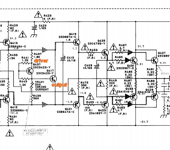

Point taken, I was also thinking the comments from Ostripper and others that they feel the sound open up on higher rail voltages. That I have to lower the bias current and raise the Re to meet Oliver's condition. Is there any truth about higher rail voltage give better sound? If so, why?
I read p300 and 301 many times, you specifically said this is for a single transistor. If you look at equation 15.2, the gm calculation is for single transistor and so is the thermal resistance 1.1deg/W is for a single transistor. So I assume you meant this is the worst case in hogging that one transistor hog up all the current. That if the parallel transistors are sharing current, it is going to be a lot more forgiving.

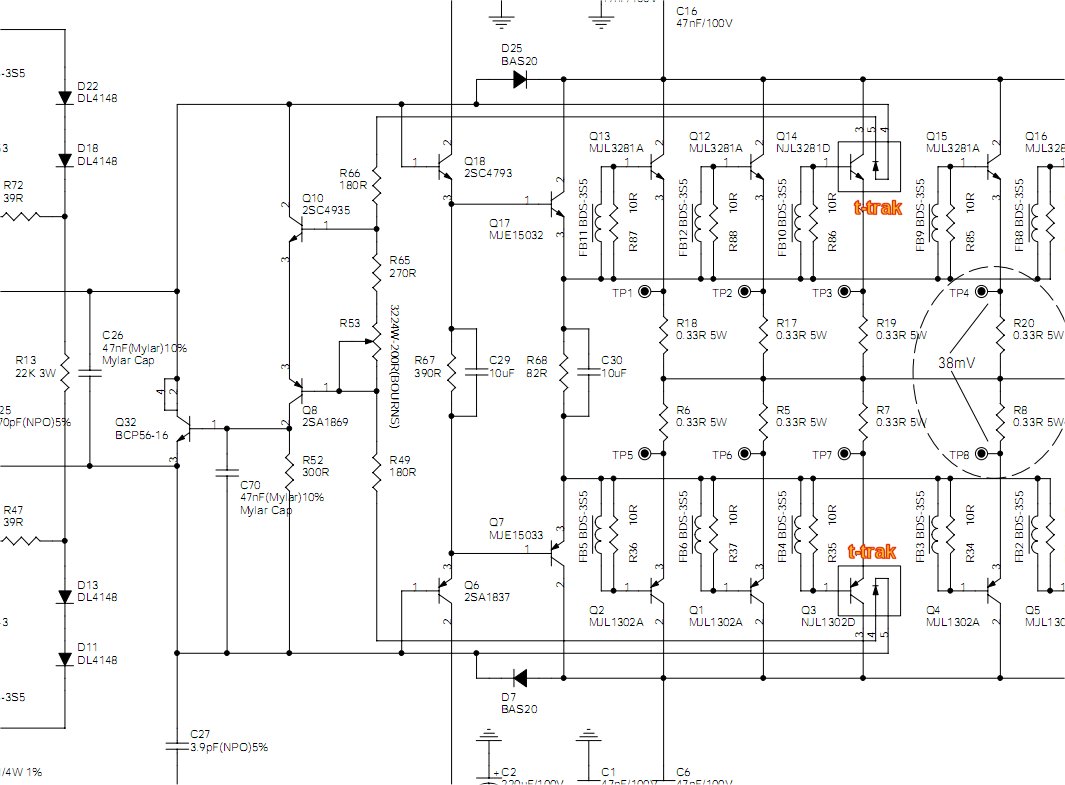

Ha ha, it's 20 years late from Self, but I did post drawings and pictures in #5602 and #5604 in this thread that I layout to bolt the bias spreader KSC3503 on top of the big TO-264 power transistor. #5602 have the drawing showing that. #5604 show how I have the NPN pre-driver bolted with the PNP driver together on a separate heatsink.http://www.diyaudio.com/forums/solid-state/171159-bob-cordells-power-amplifier-book-561.html
Don't worry about credit, I just thought it's common sense that you cannot track faster and closer than right on top. I don't like the thermal track as it's only a diode and you can only use one of them, it's not much better.

Member Bonsai's approach of attaching the sensor to the collector lead
might be the closest to a real thermal-trak.
And for an EF3 , having the secondary dynamic sensor on the drivers is the
#2 best approach (below 1).
I've even had the privilege to test and observe the very best (below 2).
Nothing short of amazing thermal stability , here !!

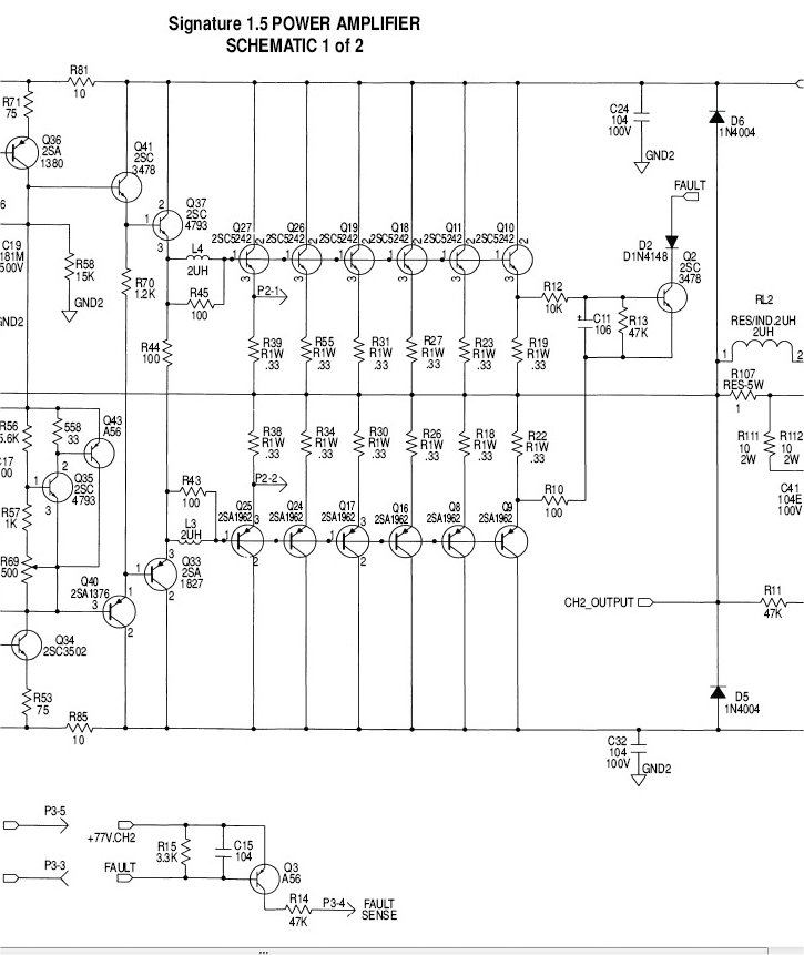

I suppose , for a hobbyist (and an EF2) , Doug's way is best.
Overload and thermal stability are quite important first steps , we can
always design uber low THD in after (it has to survive
PS - Alan - #2 pix is one of the most expensive , highly reviewed "badest" amps out there ...
Note what they are using for Re !
OS
