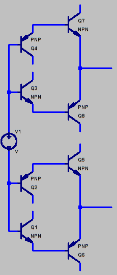

Alan, you might try two diamond buffers, one for the positive outputs and one for the negative outputs. That way each gets indefinite current drive in either direction.
I don't follow you

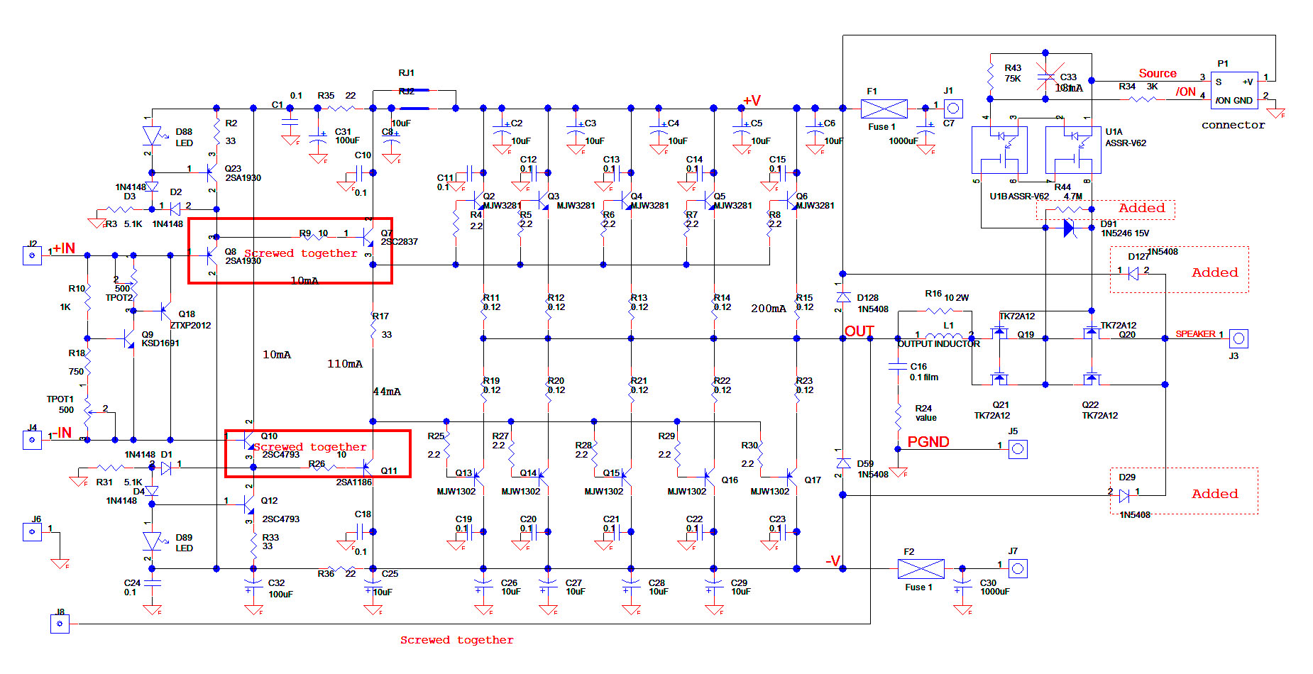

Hi Mr. Cordell
I need to change out the pre-driver of my 3EF folded pre-driver OPS. I need to replace the KSC3503/KSA1381 with 2SC4793 and 2SA1930 to get lower Vbe. But the Cob increased from 2.6pF of the KS to about 26pF of the 2S transistors. But I don't think it would be a problem of loading the VAS.
I want to run it by you on my conclusion that it's ok to change the transistors. I am referencing to page 196 and page 437 of your book:
input capacitance C\pi = Cje+ diffusion capacitance where
difusion capacitance = gm/(2 X \pi X fT)
If I use 26mA collector current, gm=1, so diffusion capacitance =1/((2 X \pi X fT). If fT=100MHz, capacitance is 1600pF. So the diffusion capacitance is so much bigger than the Cob that if really does not matter whether it's 2.6pF or 26pF.....Hell, even 260pF!!!
For higher current and lower fT drivers and output transistors, the Cob is irrelevant as the diffusion capacitance is so so much higher than a few hundred pF of the big transistors.
I just want to confirm with you on this point. I don't need to choose transistor for EF base on Cob.

Hi Mr. Cordell
Thanks for your reply. It's a long story. I designed a 3EF Diamond OPS pcb, I found I need very low bias spreader voltage. Attached is my OPS schematic. I have to use the CFP spreader because it works really good in adjusting tempco by balancing TPOT2 and the TPOT1 to get the right compensation. The problem is the CFP needs more headroom to prevent the transistors from saturating. The spreader voltage is down to 1.1V or less. I had problem of the spreader saturated and could not be adjusted. I need transistors with Vbe to gain back the headroom.
I did post here to ask you what parameters in data sheet will give me the insight which has lower Vbe. After experimenting, I conclude that those that has higher current capability gives lower Vbe. I since found all the transistors that I needed and it worked beautifully. I got the spreader voltage up to 1.2V and I tested running at 140mA each stage and the voltage across the emitter resistor of the power transistor stay at 30mV within 1mV from stone cold to not touchable hot. I even drive the circuit with 1.5MHz that increase the supply current to over 2.5A for 20seconds and stop to measure. The voltage of the emitter resistor increase to 35mV but back down to 30mV again within 20 seconds. Thermal circuit really works.
To answer your question, in order to get the headroom of the spreader, I had to change the 3503/1381 to 2SC4793/2SA1930. the Vbe of 3503/1381 are 0.66V, being a folded EF, this really eat up the headroom of the bias spreader. The Vbe of the larger 2Sxxxxx transistor is 0.58V. Just by changing these, I gain 160mV head room!!! This together with using transistors with low Vbe in the spreader circuit led to my success in thermal compensation of this OPS.
This bring back to my post. The Cob of the bigger 2Sxxxxx is 26pF vs 2.6pF of the KSC/KSA. This increased the loading of the VAS and hurts slew rate. So before I try to use the KSC/KSA again, I would like to make sure that this extra capacitance does matter. Sadly, being a folded EF, the max current is set by the CCS to about 35mA. So gm is about 35/26=1.35. Diffusion capacitance=1.35/(6.28 X 100EE6)=2.15nF. Using 0.99 as you suggested, the input capacitance is 2150pF/100=21.5pF actually loading the VAS. So comparing KSC/KSA to the 2Sxxxxx, the capacitance increased from (2.6+21.5)pF to (26+21.5)pF, which is a little more than double. So, now, I want to see whether I can squeeze out a little more headroom from other part and bring back the KSC/KSA. I am ordering the NJW0281/0302 and 2SC5242/2SA1962 to test the Vbe. NJW looks promising as the data sheet shows the Vbe is higher the MJL3281/1302 that I am using. I can pick up about 80mV( I hope) of headroom.

Why do you desire A diamond configuration, does it bring any benefits over a normal 3EF. As I see it you only make things more complicated and as you have expience less maneuverability when it comes to VBE and thermal compensation.
It is more a layout problem that sway me to this. Layout is everything. If you do normal 3EF, you are pretty much forced to put the drivers and predrivers in the middle of the pcb with big power transistors on both sides. You cannot put the drivers and predrivers at the end as the temperature will be very different than the big transistors.
Also, because of the high current, it is not practical to have alternate NPN PNP power transistors to keep the current local. You are forced to have NPN on one side and PNP on the other side. This will cause severe current running across the pcb with the more sensitive circuit in the middle catching all the cross fire. The only other way is to have the spreader sense both the power transistors and the drivers separately to compensate. That really complicate things.
With Diamond, I can isolate the drivers and predrivers and cancel their tempco by screwing them together on a separate heat sink. I only need to compensate the power transistor alone. I managed to put the drivers and predrivers on one side of the pcb and alternate NPN PNP power transistors.
I got it working, thermal compensation is very good when I fix everything. Bias is rock solid from stone cold to not touchable hot. Normal 3EF need to compensate all the transistors, here all drivers and predrivers are self compensated. Because the drivers are bolted together and the spreader is bolted on top of the power transistors, the thermal response is very good. The voltage across the emitter stay to within 1mV from stone cold to not touchable hot. I simulated short high power passage by running 8Vpp 1.7MHz input to ramp the supply current to over 2.5A for 20 seconds before removing the signal, then immediately monitor the voltage across the emitter resistor. It went from 30mV to 35mV only and back down in 20 second after I remove the signal. I think this is very good. I don't think you can get this that easy with the normal 3EF.
There is a slight advantage of gaining 1.4V headroom for the rail also.

Hi Alan,
You've touched on many things here, and there are many issues. First of all, your suggestion for me to discuss further in my second edition the use of low-voltage bias spreaders (e.g., about 2Vbe) is a good one. The spread of only 2Vbe does limit some options in terms of spreader design and headroom options.
That having been said, selecting transistors in the pre-driver, driver and output stage for Vbe is just not the way to go, in my opinion.
Your use of the CFP bias spreader in this case seems to be at the heart of your problems, as it needs more headroom than the simple one-transistor Vbe multiplier. You may have to forego the CFP bias spreader. Its main advantages are its lower impedance, reducing or eliminating the need for the compensation resistor in the collector that is often used, and its higher current gain that reduces the base current drawn from the Vbe multiplier resistive divider. I have not thought carefully enough about your claim that the CFP gives better temperature compensation, but it may be some sort of second-order effect. It is not clear why the second pot helps. Beware of any approach that depends on transistor current gain for its behavior. For now, I think you may have to stick with the one-transistor Vbe multiplier with maybe the compensation resistor in the collector. The drop across this compensation resistor does not reduce headroom of the Vbe multiplier transistor.
Bear in mind that there are other ways in the folded Triple to increase the needed spread voltage, such as putting small resistors directly in series with the driver emitters. If you are running 100mA through the drivers, even 1 ohm will buy you a total of 200mV for the spreader. If you want to go even further, you can put a diode in series with each emitter; the diode dissipates very little, so its tempco will only slightly come into play as a function of the ambient temperature of the board.
The high frequency signal collapse you speak of should not be an issue of concern. Large signal operation at 1 MHz is completely unrealistic. Also, it sounds like you were discussing having not enough current to drive the bases of the drivers, as dictated by the current sources for the pre-drivers.
As far as available current to drive the output transistor bases at high frequencies, the issue is the same whether it is a standard 3EF Triple or a triple with a folded pre-driver.

Hi Mr. Cordell.
The reason I choose the CFP spreader is because I can adjust the tempco. I need two trim pot and I can adjust tempco and bias current. I don't think you can do it with one transistor. I tried with one transistor and the bias current kept going up. With two trim pot, it's easy to trim the pot to never turn on the PNP and the spreader becomes a single transistor. It does not work. All the big transistor has very low Vbe, the spreader is going to be only 1.1V or less realistically. You won't have the multiply ratio to get the right tempco. You have -4mV/deg C to compensate, you can only get -4mV/deg if the bias spreader is 1.4V.
The idea of adding a resistor at the emitter of the driver transistor is a good one. But one thing concern me is I have 5 pairs of output transistor. The base stop to each power transistor is 2.2ohm. I I use 1ohm like you suggested, that is equivalent of changing the 2.2ohm to 2.2+5=7.2ohm. This is because I have 5 pair in parallel. I think 0.5ohm will be a good one, this will be equivalent to 4.7ohm base stop. What do you think? I can up the current of the driver to 50mA, that will increase the spreader voltage by 50mV. That will help a little and I still stay with base stop equivalent to 4.7ohm.
I know choosing by Vbe is not the best way, but even after I get the extra 50mV, I still need a little more. I really want to go back to the KSC/KSA for lower input capacitance to put less loading to the VAS. I still want to order the NJW0302/0281 as the data sheet show it's going to have higher Vbe than the MJL1302/3281 that I am currently using. I have 5 pairs of output transistor, I can afford to use a lower power transistor and not worry about the SOA.....I hope!!!

Can you explain in detail how you use the CFP to change the tempco without depending on one of the transistors being moved to an abnormal operating point (e.g. quasi-saturation or starved or something like that)?
Assuming that the input transistor of the CFP is mounted on the output transistor, one will expect to get about 2.2mV/C tempco slope of the temperature of that transistor, times the Vbe multiplier ratio. That ratio would normally be about 2 to achieve the needed spreader voltage. The tempco in that situation would be about 4.4mV/C
Assuming that the mV/C number and/or the Vbe multiplication number are different for various reasons, one may need to have that 4.4mV/C number be different. I assume this is the tempco adjustment you are talking about.
Placing a 1-ohm resistor in series with the emitter of the driver is not quite the same as effectively increasing the base stoppers by 5 ohms, since ALL of the output transistor bases see the same effect of the added 1-ohm resistor. This means that current hogging stability is not degraded in the same way.
With such a large amplifier with 5 output pairs you probably should indeed increase the driver bias current to 100mA - and make sure you have enough heat sink on it.
