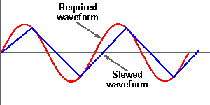

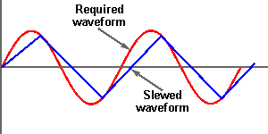

Before I forget ---- Regarding SR margin ---
As we get closer to the amps SR, the waveform begins to distort... bending more into triangle shape. We know it takes very little waveform change to a sine wave to produce harmonics at -100dBv.
To keep the HF harmonic distortion as low as possible, then just barely approaching SR of amp would start increasing distortion. As there is often out of band HF at significant level going into PA, I would consider >20KHz (50KHz-100KHz?) in SR calc.
And as loudspeaker loads vary in Z, a better SR calc number might replace the V in SR formula (2 pi f Vp) with (2*P*Z)^1/2. A healthy SR margin will assure lowest distortion for all conditions.
![op-amp-slew-rate-02.gif op-amp-slew-rate-02.gif](https://www.diyaudio.com/community/data/attachments/529/529387-246d82237b344cd70626b6dc91a8b310.jpg)
THx- RNMarsh

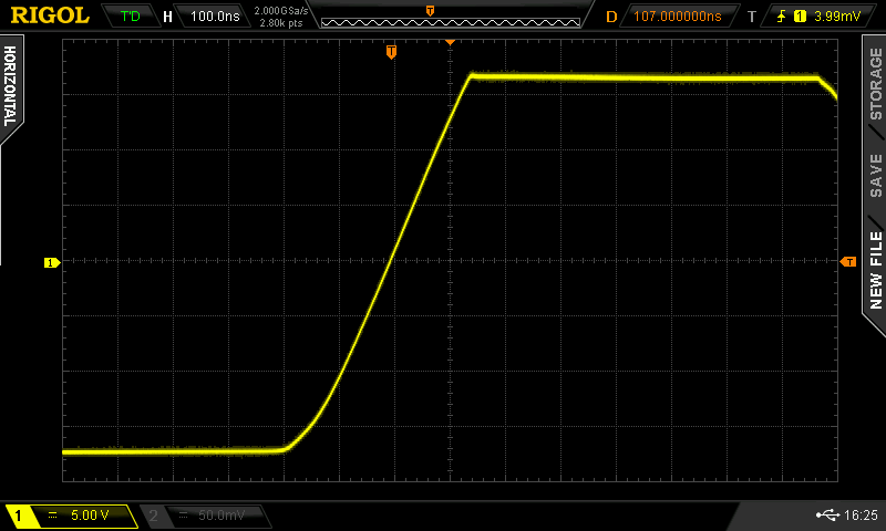

Speaking of opamps, here's one I built yesterday. All bipolar, conventional voltage feedback amplifier (single diffpair, then NPN gain stage, then complementary EF output stage) using the Sanyo / ON Semi 2SC6043 / 2SA2127 super fast, low voltage BJTs.
Faster than the heavenly NE5534A (0.87 V / us / V) which people here seem to absolutely love.
_
- 20V supply rails, 35 V slew in 320 nsec = 109V/usec = 5.4 V / us / volt of supply rail.
_
