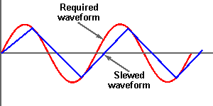

Before I forget ---- Regarding SR margin ---
As we get closer to the amps SR, the waveform begins to distort... bending more into triangle shape. We know it takes very little waveform change to a sine wave to produce harmonics at -100dBv.
To keep the HF harmonic distortion as low as possible, then just barely approaching SR of amp would start increasing distortion. As there is often out of band HF at significant level going into PA, I would consider >20KHz (50KHz-100KHz?) in SR calc.
And as loudspeaker loads vary in Z, a better SR calc number might replace the V in SR formula (2 pi f Vp) with (2*P*Z)^1/2. A healthy SR margin will assure lowest distortion for all conditions.
THx- RNMarsh
This is largely true, and I and others have always advocated this. When an amplifier goes into slew rate limiting, as depicted in your drawing, this is analogous to hard clipping of an amplifier in the rate-of-change domain. Like amplifier amplitude-related distortion, smaller degrees of distortion increase begin to appear long before clipping or slew limiting. This is especially the case for individual stages where their distortion behavior is considered in the open loop. Also, think of "soft" clipping and "soft" slew rate limiting. So in a conventional arrangement, margin against slew rate limiting definitely plays a role in reducing distortion.
This is an eminently measurable phenomena. This is one reason why 20 kHz THD at high amplitude is a good measurement for characterizing this. Obviously THD at even higher frequencies is desirable as well, but not as easy to accurately measure with many analyzers (they need more residual bandwidth in order not to cut into the amplitude of the harmonics).
19+20kHz CCIF is also a good measurement for characterizing HF performance, as it causes the distortion products to land at LOWER frequencies that can be measured with a spectrum analyzer. The challenge here is that spectrum analyzers that have 120 dB dynamic range are not readily available at reasonable prices. Also, 19+20kHz CCIF tends to produce smaller levels of spectral components than THD-20 for a given amplifier and peak operating level. Many of the newer APs do a pretty good job in this area, and one should look at John Atkinson's amplifier review measurements, which very fortunately usually include 19+20 kHz CCIF.
The caveat to slew rate margin reducing HF distortion is slew on demand circuits that result from current on demand circuit topologies. Slew on demand almost always depends on the circuitry somewhere going into a somewhat different operating mode, sort of like leaving class A and going into class B operation in the IPS or VAS.
So if you are claiming that slew rate margin that is achieved through current on demand will enhance HF distortion behavior, you will probably be disappointed. The slew rate margin that is achieved without or before current on demand behavior is what really counts in this regard.
In my view, a power amplifier should usually have at least 50 v/us slew rate achieved without current on demand, and this is not difficult to achieve in either VFA or CFA power amplifiers.

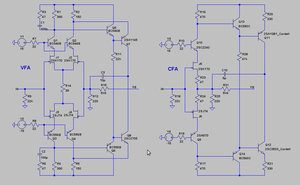

Mr. Cordell, I believe what you are saying is, in general, incorrect. It applies only in the cases where the current is limited by a bias current. Once the bias current limit is reached, the amplifier enters in a non linear region as you say, the loop gain drops and there's nothing to linearize the amplifier. This is essentially a large signal behavior.
Do the following gedanken experiment. Imagine you are looking at (a) the output of a long tail pair, Miller compensated VFA amplifier, and (b) the output of a standard CFA with diamond buffer at the input, also Miller compensated. The input signal is a square wave with zero rise and fall times, of variable amplitude.
Set the pulse generator to a very low level, say 1mV. Up to a phase shift, what you will see at the output is a signal with exponential rise and fall times, the rise time being determined by the amplifier bandwidth Tr[nS]=0.35/BW[MHz] This rise time is the same if you double the input level to 2mV, so that the apparent slew rate will double. This happens if you further increase the input amplitude, until you will reach the slewing limit. From this point further, the slew rate will be constant with increasing the input level and is given by the rate of charging the Miller cap by twice the input stage bias current, SR=2*Ibias/Cmiller. At this point, indeed the input stage is in some sort of class B non linearity, since all the bias current is flowing through Cmiller.
Now look at (b). As the current charging the Miller cap is essentially Vout/Rfeedback, there is virtually no limit. Whatever amplitude the input signal has, if Rf is small enough, the Miller cap will charge at a higher rate, proportional to the input signal. Therefore, the property mentioned above (of the apparent slew rate increasing with the input signal) is conserved up to the maximum output voltage swing. And no stage in the amplifier is, in this case, under any circumstances, entering in nonlinearities.
I'm attaching a classic CFA schematic with a closed loop gain of 6 (sorry, no time to fit a bias scheme for vertical mosfets) and the results for a 100mVpp input and the 6Vpp input, both 500KHz. As you see, the rise time is approximately constant and the apparent slew rate is proportional to the input signal amplitude. Theoretically, if there's nothing else to charge but the Miller cap, this proportionality will hold until the amplifier output reaches the maximum swing (otherwise said, until the amplifier clips).
In the real world though, there's more than the Miller cap, so from a certain input level the CFA will indeed enter in slewing limitation, some active devices will enter in nonlinearities, and the proportionality is lost. This can be avoided to a certain degree by a more advanced CFA topology and careful design, hence the CFA op amps with thousands of V/uS at full output.
The bottom line is that an ideal Miller compensated CFA will never get into slewing limitations/distortions. This is in contrast to an ideal Miller compensated long tail pair basic VFA, which will, sooner or later, enter into slewing limitations. Of course, there are ways to avoid slewing limitations in a VFA, also possible to implement current on demand in a VFA.
