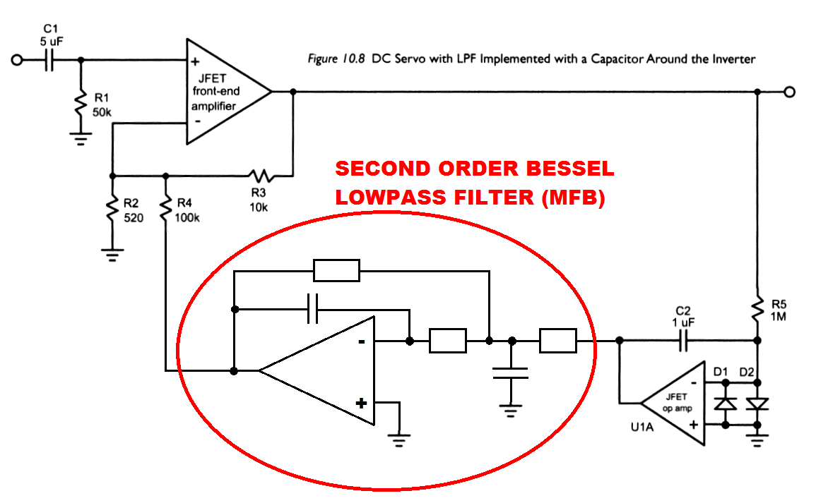

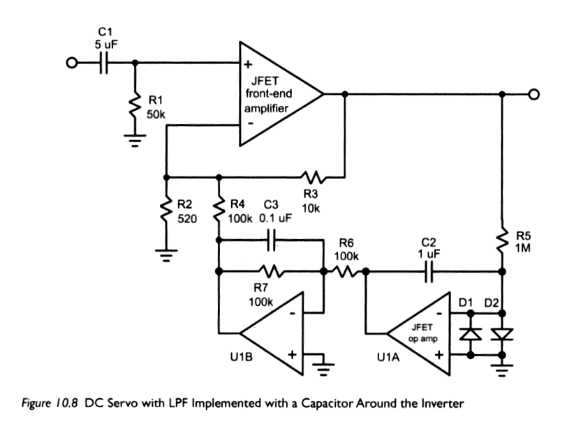

Second Edition: Question / observation about Fig. 10.8 , DC Servos
Hi Bob,
I'm really loving the new edition. Congratulations on a teriffic update to a classic book!
I'd like to offer an observation about the noninverting DC servo shown in Figure 10.8, attached below as Figure 1. My observation is a standard, perhaps hackneyed, religious axiom in DIYaudio: if some is good then more is better! Specifically your opamp U1B implements a first order lowpass filter. But if one is good then two is better (!). Why not use an inverting filter topology like Multiple FeedBack to build a second order lowpass filter? A diagram is shown in the attached Figure 2 below. Expand your browser window to full screen and click the white "X" at lower left to see the images full size.
I wrote the word "Bessel" just to start an argument; I don't think it actually matters whether the filter is Butterworth (zeta=0.5) or Bessel (zeta=0.833) or any other specific "alignment". In my opinion the important details are the cutoff frequency and the order of the filter. Set the cutoff frequency to match the cutoff in Bob Cordell's book, 2nd edition, U1B of Fig 10.8. Set the order of the filter to be two. Done!
What do you think about it?

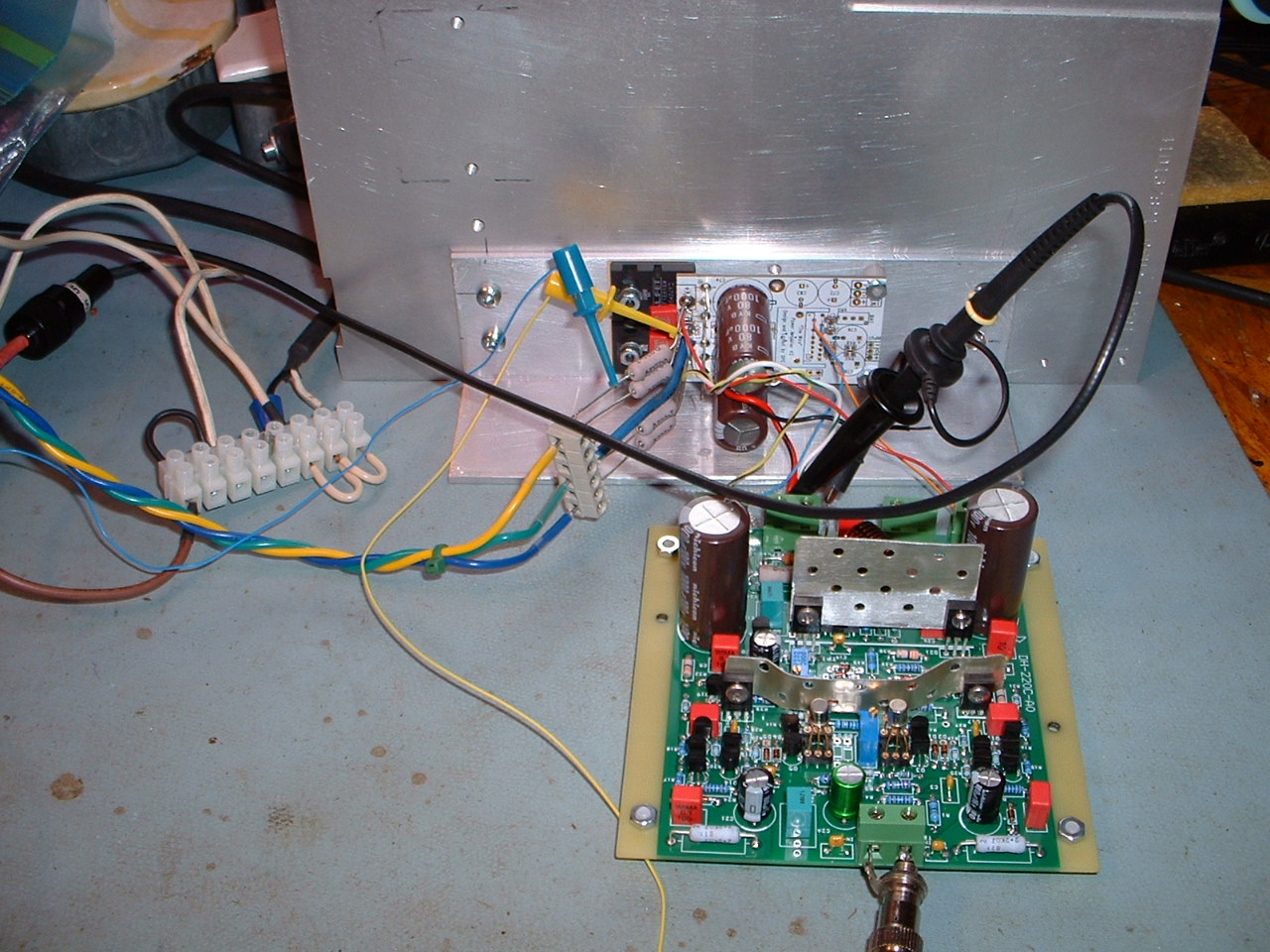

FYI, I have the amplifier, called "BC-1" in chapter 5 built & operational.
I approached Bob earlier asking if there would be something to build in the new book. The answer was yes and no, there is a complete design but no pcb's available for easy assembly. So, I took it upon myself with Bob's help and encouragement to design a set of pcb's for BC-1. This was done in anticipation that their maybe some interest in book owners wanting to buildup the BC-1 amplifier.
I have sent the pcb's to Bob Cordell for evaluation. Bob graciously offered to review, and now evaluate my design implementation and the build.
Once Bob has given them his approval I will be able to release them for others to use.
I will attach a pic of the set of pcb's in operation. There is a Mouser BOM in a shopping cart in which you will be able to order the parts against. It will be a complete amp with out the chassis and mechanical bits. A 3 board set, a simple & cost effective, rectifier/filter, BC-1 (AFE), BC-1(OPS).

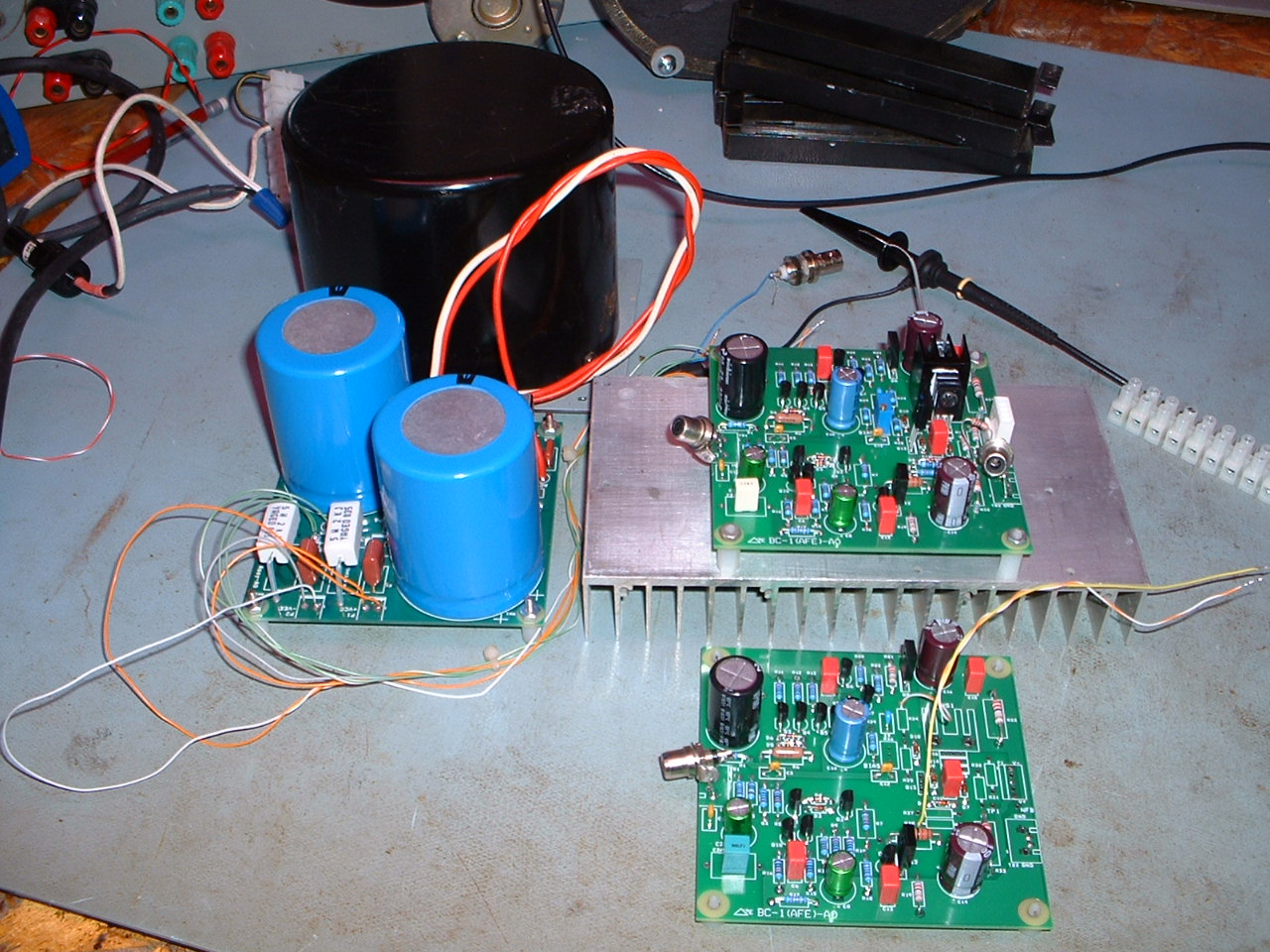

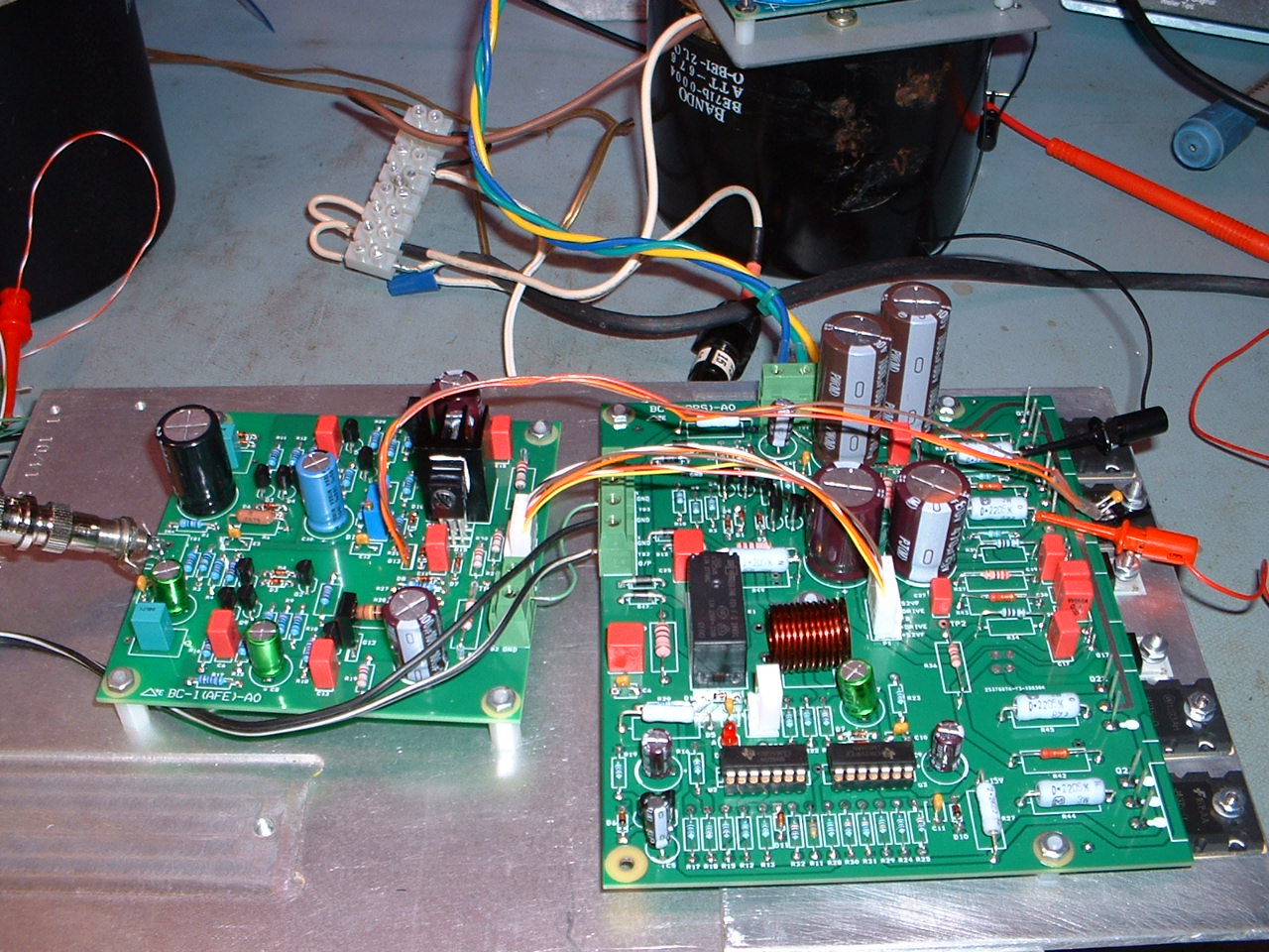

Since I was on a roll I also did up the DH-200C design as shown in chapters 9 & 14. Bob is also evaluating that one too, like Bob needs more work, especially from me

Bob wrote to me,
I wound mine on a deep socket that is slightly smaller than 1/2" (10-11-12mm?)
Bob wrote to me,
With respect to the output coil, if convenient, leave a little extra space around it,especially in the length direction, and err on the larger side regarding the spacing of its pads. Right now the coil is 12 turns of 18 AWG, which comes to about 0.5 inch length if tight wound (18 AWG is 0.04" dia), so I'm guessing you are allowing 0.5 or 0.6 in for the pad spacing, the latter being wise. Also, keep in mind that the pads should be at diagonally opposite corners of the footprint rectangle that the coil occupies (coil diameter is 0.5"). That footprint rectangle might therefore want to be something like 0.6 X 0.6. If someone wanted to use 16 AWG, I note that 16 AWG diameter is 0.051 and that 12 turns would come to 0.061, which is about 0.1" longer than an 18 AWG coil.
