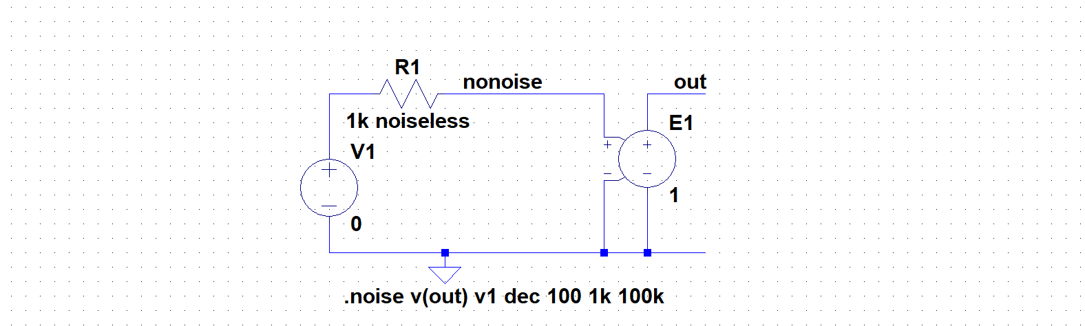

Noiseless resistors in LTSpice
In the latest version of his book, Bob shows using a transconductor to make a noiseless resistor. I had this vague notion that LTSpice had another way that I had used in the past...
This url describes appending the word noiseless after the resistor value to make a noiseless resistor.
Noise Analysis Using LTspice Tutorial
Sure enough...it works great! Lots of hidden stuff in LTSpice...
BTW Bob ---I'm certainly enjoying reading your latest magnum opus! Wow! Congrats!
