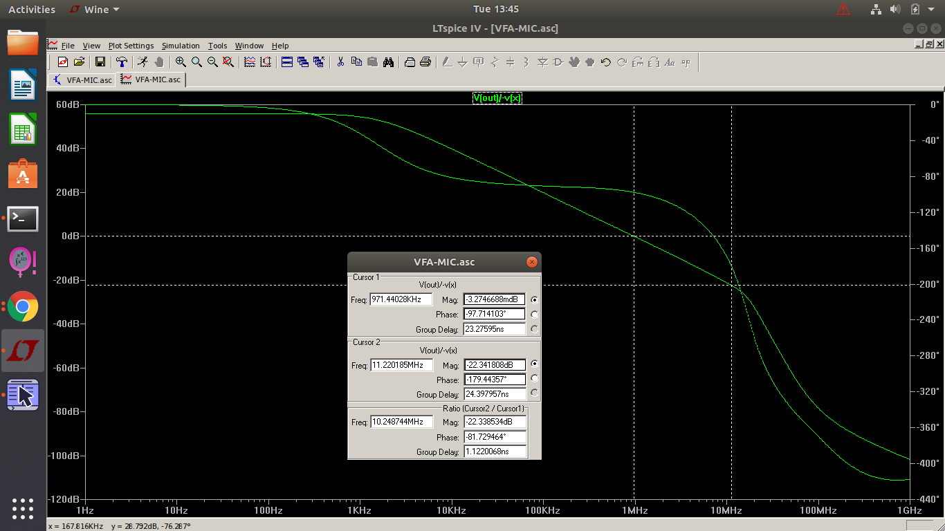

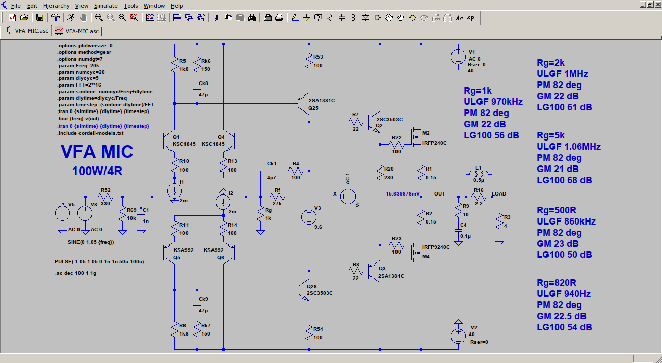

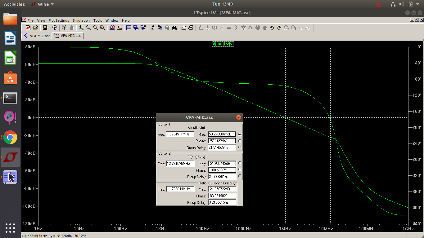

As mentioned in the article, one of the important distinguishing features of the CFA is that, to first order, the loop gain does not change when the closed loop gain is changed by changing the value of the feedback shunt resistor, here Rg (it DOES change if the closed loop gain is changed by changing the value of the feedback resistor).
this is also true for MIC compensated VFA
This is a different mechanism LKA. In a high loop gain CFA and a high loop gain VFA you can use TPC or OIC or one of the other more modern compensation techniques to have a flat, wideband, loop gain. Look at dadod's amplifier to see this. The open loop corner frequency of these high gain CFA's is LOW - just like a VFA.
In a moderate loop gain CFA, you are not getting a flat, wide band loop gain because of the compensation - it just is very wide with low phase shift (c.f. low OLG) through the amplifier so you only need light compensation to ensure the output stage pole falls below the ULGF in magnitude terms. This is exactly the case with the sx-Amp were the loop gain bandwidth is 60 kHz.
maybe different mechanism but the result is similar
VFA MIC schematic
LG Rg=1k
LG Rg=2k
The buffer is a voltage source of low impedance. It does not shunt Rg, it delivers current into Rg in parallel with current from Rf.This is something I have difficulty to understand. You (and others) showed that there's no appreciable signal current going through Rg, it being shunted by the very low buffer output impedance.
