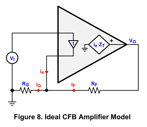

Assuming this is the major trap in analysing how an input stage works.Assuming ideal transistors and ignoring base current errors, the voltage at the output of the diamond buffer (DB) emitter must equal the non-inverting input voltage.
Refering to Renesas figure below :I know some people will say 'ah you see a CFA is just a VFA because you've been talking about voltages' but its not - you are directly subtracting currents at the DB inverting input
Ig = Ie + If
You interpret this as :
Ie = Ig - If
Ie being almost equal to Ic delivered by the input stage.
But Ie is not determined by this difference of currents between Ig and If.
Ie is determine by the voltage between the non inverting input and the inverting input. Otherwise said, it is under the control of Vbes of the input stage.
You see, it is just a VFA.
In the name of some people.
"The bandwidth independent gain effect/property relies causally on the (small signal) modulation of the loop gain (open loop gain, too) by the feedback resistor. "
Are you referring here to the small signal DB gm changes?
I mean, changing the closed loop gain, by changing the feedback network resistor (within small closed loop gain limits), also changes the amp open loop gain, so that the bandwidth and closed loop gain are no longer related through the GBW. This is a small signal mechanism, nothing to do with "current on demand".
In a VFA, changing the closed loop gain does not change the amp open loop gain, therefore the GBW constraint holds.

Why would you change the feedback resistor in a CFA? You optimize it for overshoot or phase margin (whatever you choose) and then adjust Rg to set the correct gain. The gm is set by the feedback resistor in a CFA (unlike a VFA).
On a VFA, pole splitting aka dominant pole compensation means the OLG drops off at 20 dB/decade. On a CFA (unless it’s high OLG as mentioned in an earlier post) you don’t have to apply pole splitting so you get more bandwidth available.
