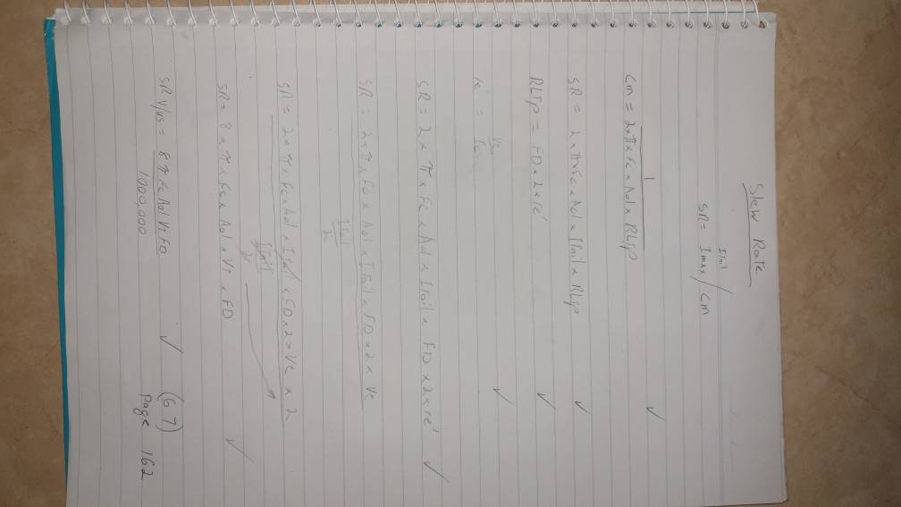

If you substitute equation (6.6) into equation (6.4) you get equation (6.7) exactly, with no missing factors of two.
Thanks Mark, I'll check it out tonight.
Can you do me a favor is Imax the same as Itail ?
Oh. I see my mistake Itail does equal Imax but re' is not caculated on the quiescent current but at Itail or Imax.Thanks Mark, I'll check it out tonight.
So re' is really re' (max), that's were I went wrong. But this was a great learning experience so its all good.
Now I'm really confused because I just read this at the end of chapter 2.
the value for Itail is 2mA and its saying that only 1mA will be available to charge or discharge the capacitor from the bias point which is 1mA.
Notice that the input stage can never deliver more than ±1 mA with respect to its nominal bias point. If all of this 1-mA swing goes into charging or discharging C1, the maximum voltage rate of change across C1 will be 1 mA/300 pF = 3.3 V/μs. This
Could someone please clear this up for me. It seams now that I was wrong again. I(tail) does not equal I(max) instead I(max) = I(tail) - I(quiescent)
Sorry to ask what to most of you is probably a basic thing. But I must be missing something. If you turn to page 162 it says The LTP of Figure 6.13 etc... When you look at figure 6.13 it has a IPS gm of 2ms. and a I(max) of 1mA. So I assume that I(tail) = 2mA
Now if you turn to page 238 you will see a schematic which seams to match the Re and re' values. It has a I(tail) of 2mA but it has a IPS gm of 4ms.
Bob would you mind clearing this up for me a its really got me stuck.

Imax, the magnitude of current available to charge or discharge the Miller capacitor, depends on the type of load circuit that is used to load the IPS LTP. In circuits where the load is a simple resistor, the net maximum current available to charge the capacitor is Itail - Iquiescent of the LTP, since the load resistor is conducting a nominal amount of current that is 1/2 I tail. This means that Imax will be 1/2 I tail.
The situation is different if the LTP is loaded with a current mirror. In this case it is easy to see that Imax will equal Itail because all of the tail current can be routed to the Miller capacitor when either of the LTP transistors is fully on and the other is off.
Bob
Thanks Bob, now it makes sense why it appeared that the value of Imax was not consistent.
So just to ensure that I have got this right now.
In the case where the LTP uses a current mirror where Itail is 1mA the re' of each input differential pair transistor in their quiescent state will be Vt / Ic => 26/0.5 => 52 and Vt / Ic => 26/1 => 26 in the condition where Imax equals Itail. Which is the point at which the LTP it slew rate limited by Imax in this case 1mA.
