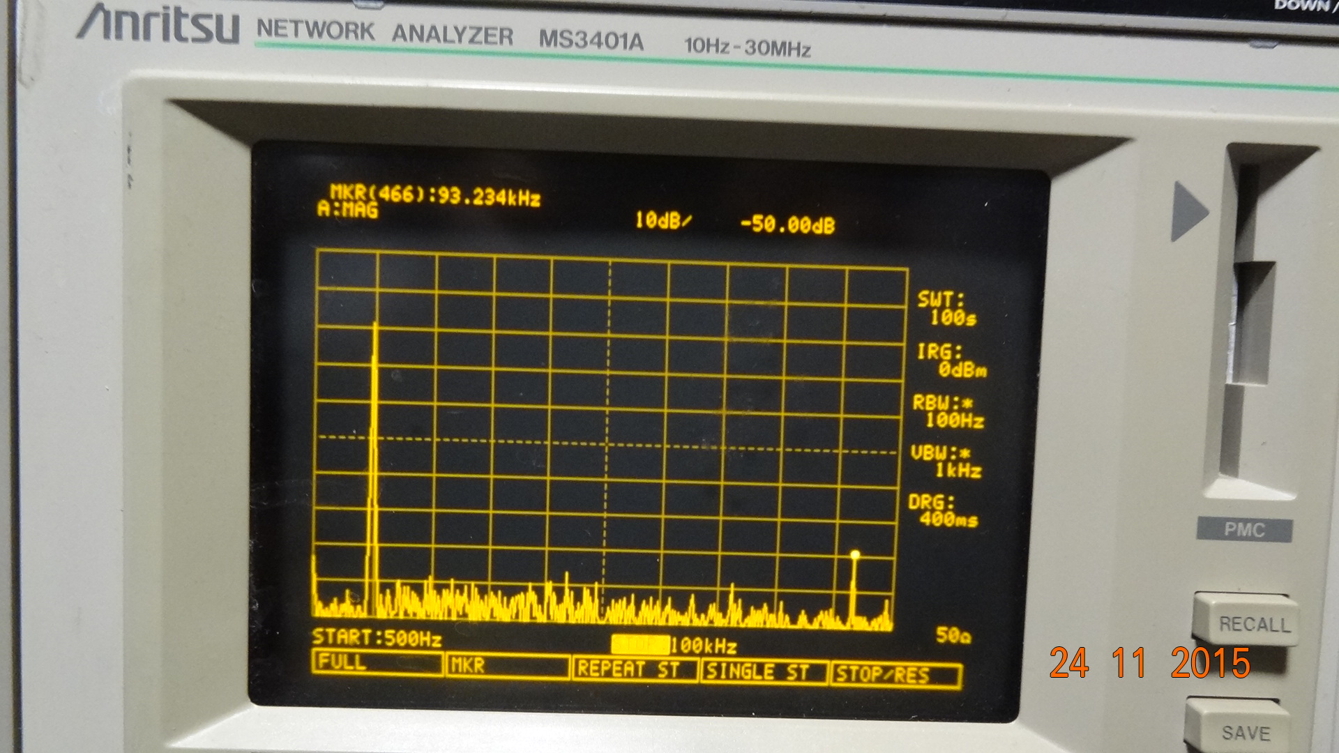

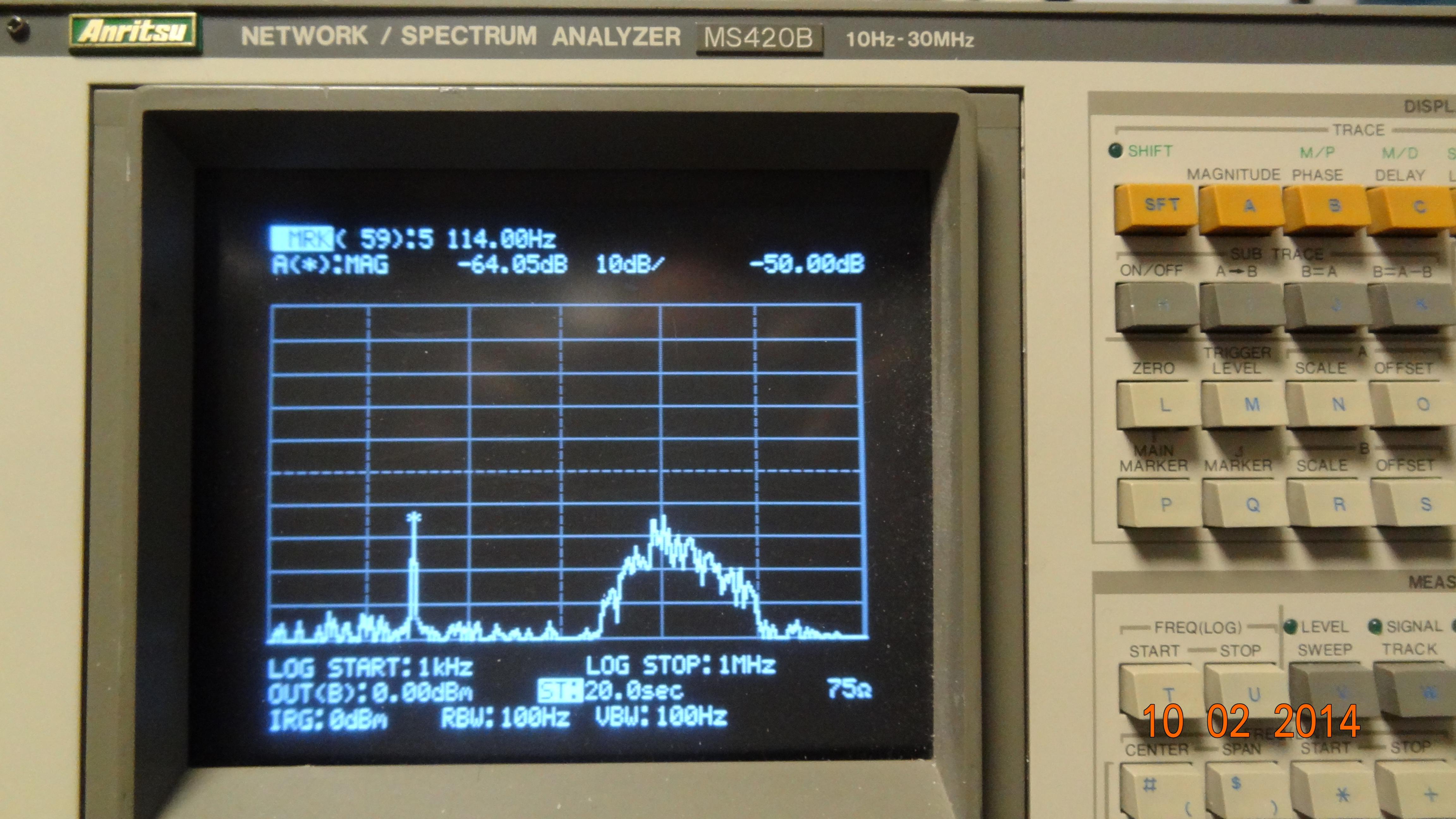

Well, maybe you can look at some yourself, including DVD/CD combo players and see how well assumptions that nothing exists within amplifier BW is out there to be amplified by PA gain.
Sometimes there have been idle tones just there all the time within audio band and only 65 dB down, for example. Whats that doing there?
here you see an idle tone. Then afterwards some Stuff comes thru. Also well within some amps BW. [ Note the measurement BW is 1KHz to 1 MHz log.]
I have lots of this stuff that should not be there IS there.
To the degree yours does also, it is a potential problem for insufficient SR amps (IM). Take it for what is worth.

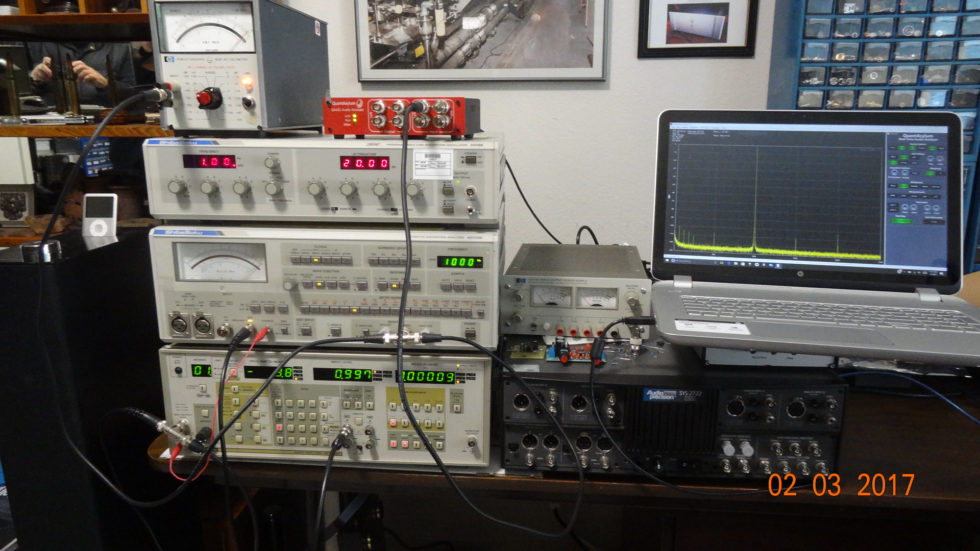

My basic distortion T&M. Partial... no network analyzers etal....

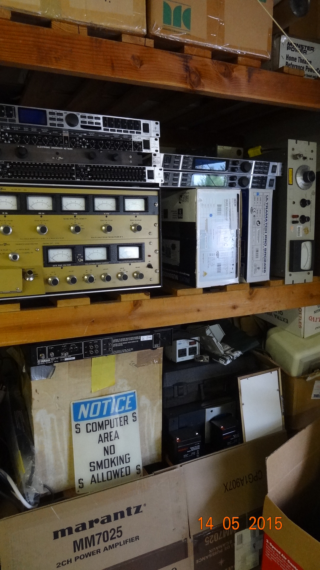

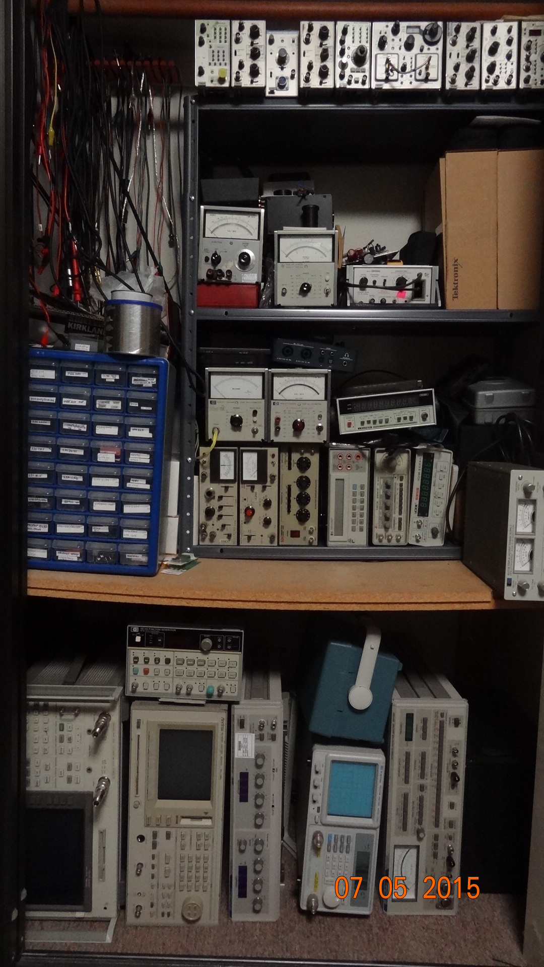

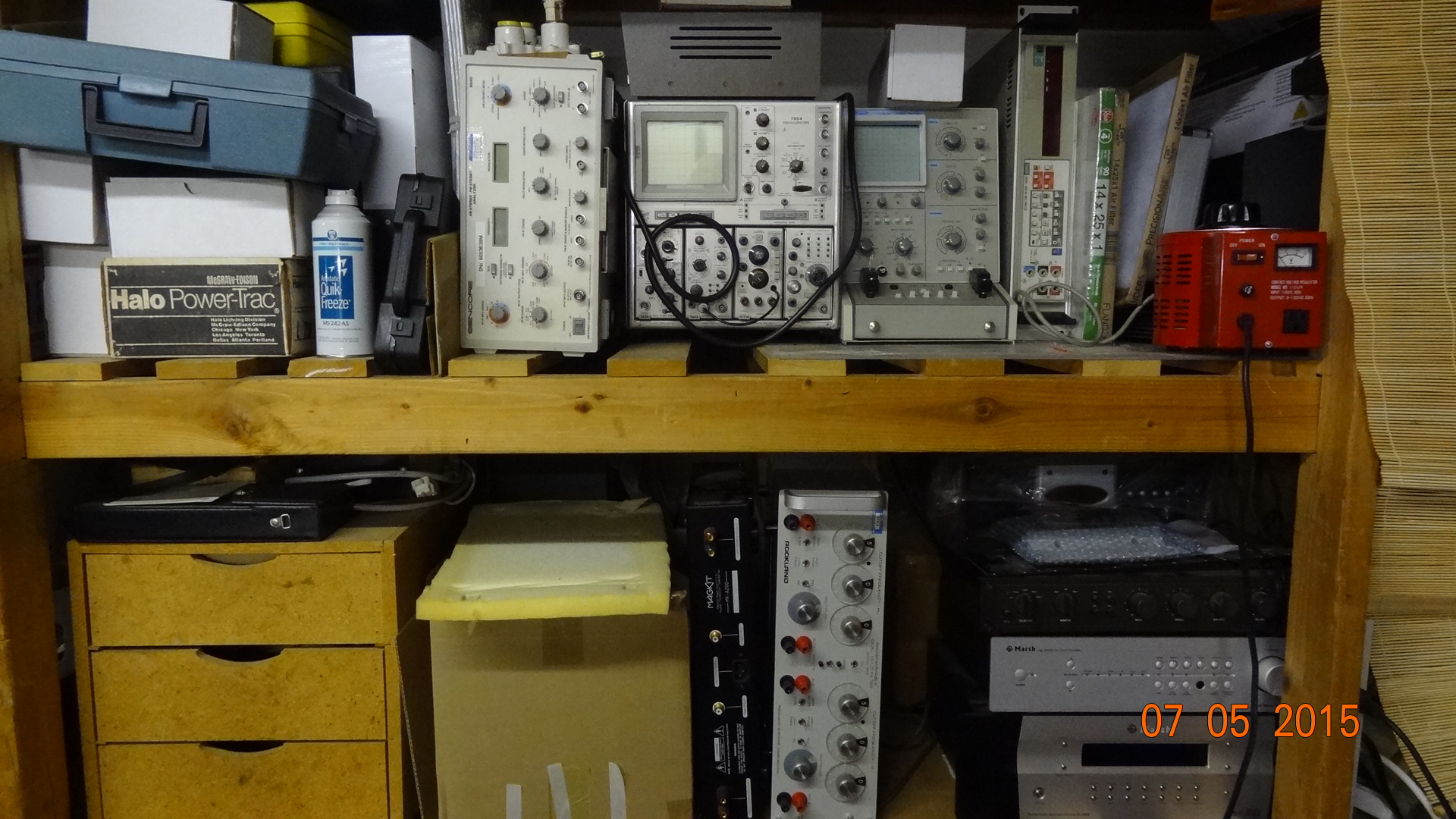

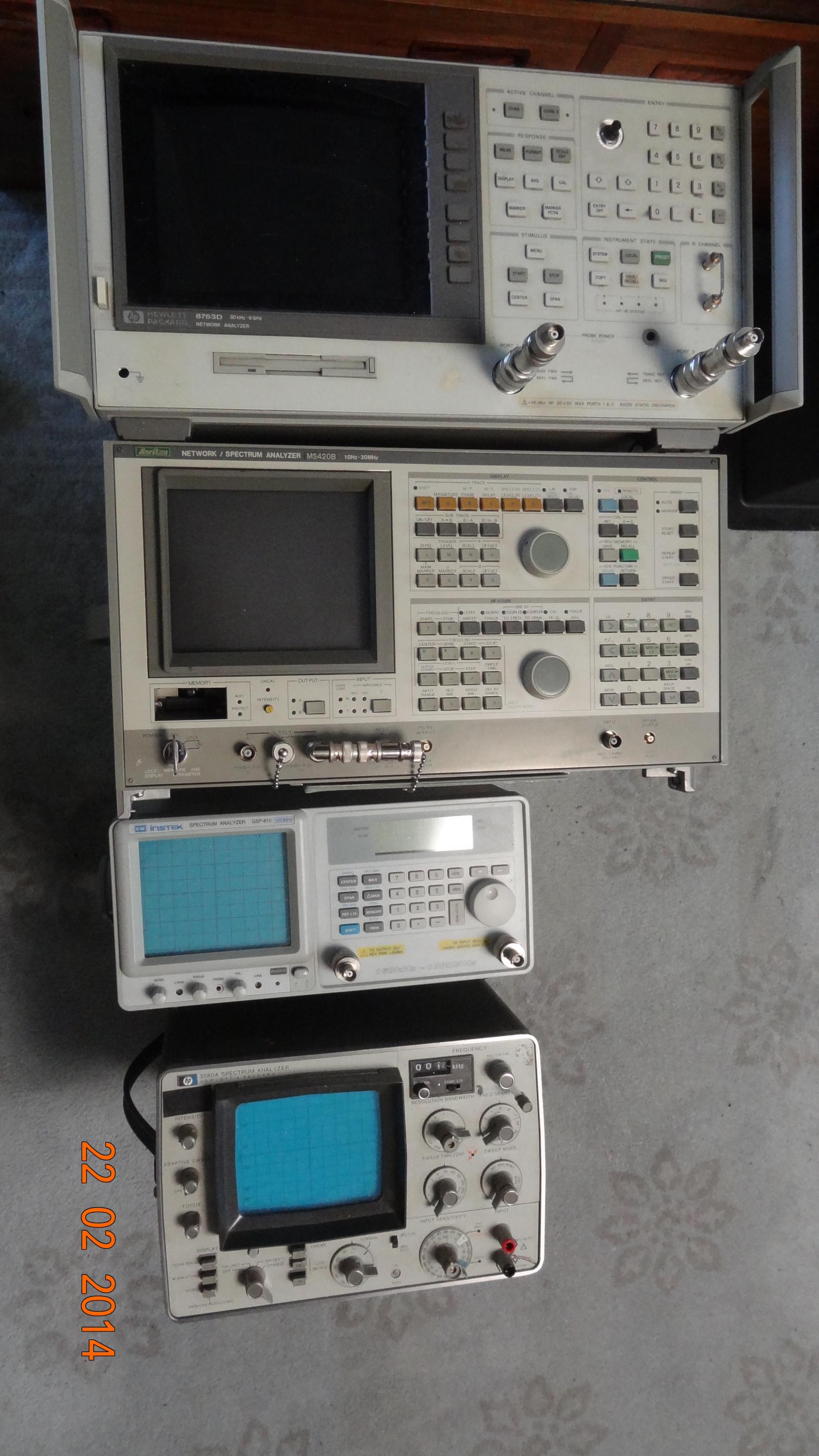

Yes, I have amassed some other serious test gear to satisfy my curiosities and support the hobby. Could go into the rental business 🙂
etc etc etc
-RNM

Maybe not so far down.... -60 into x10 preamp for source selection and x30 PA. But thats another way to look at it.

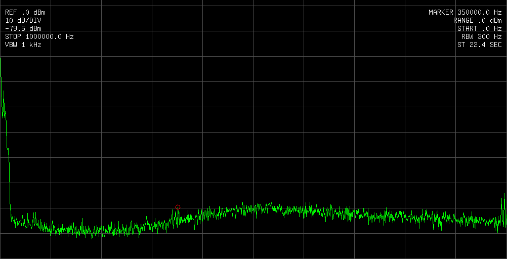

Attached a spectrum dump directly taken at RCA output during playing a song with maximum volume...
As one can see, the output is good filtered - mostly no sampling artifacts in HF range.
BR, Toni

Unfiltered! My HP3585A was directly attached using the 1MOhm input.
The sound card was running with this parameters during the screen shot:
Code:
Setting from alsamixer:
DSP Program [High attenuation with de-emphasis] (see PCM5122 datasheet for details pg. 21 and 83)
From soundcard:
root@raspberrypi:/proc/asound/card0/pcm0p/sub0# cat hw_params
access: RW_INTERLEAVED
format: S24_LE
subformat: STD
channels: 2
rate: 44100 (352800/8)
period_size: 4410
buffer_size: 22050
8 x oversampling ...
=> that may be the cause for the small peak at cursor position ~ 350kHz.
BR, Toni

I see a marker at 35,000 Hz, so it looks clean. I'm surprised it does, but maybe the reconstruction filter is part of the chip these days. However, on the earl;y chips like the TDA1541A and other NOS chips used in those designs, I expect a very strong 44.1 KHz signal on those if not filtered by the viscous filters needed there (like 7th and 8th order filters!).
