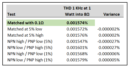

I did a quick simulation in LTSpice with a three stage Class AB amplifier with a two pair CFP output stage using 0.1Ω emitter resistors. Based on the simulation, there is a small effect on distortion. I compared it against matched values scenarios that were 5% high or low to factor out any differences from the change in absolute value. Bias levels were adjusted in the matched high and low scenarios to eliminate distortion changes due to bias changes.
Interesting results. Could you possibly check what would happen if the beta was increased by 50 in all tests except for the first baseline measurement.
This may help understand what may happen when using the MJL4281A/MJL4302A
I should have mentioned that the simulation I ran this under uses lateral MOSFETs. A design I've been tinkering with.
It might be interesting to run this again with a BJT OPS and with CFP vs EF to see how they compare. I could also try Bob's various models (4281/4302, 3281/1302 and 21193/21194) along with different absolute emitter resistor values (0.1, 0.22, 0.33).
Just for fun. Looks like a busy evening tonight 🙂

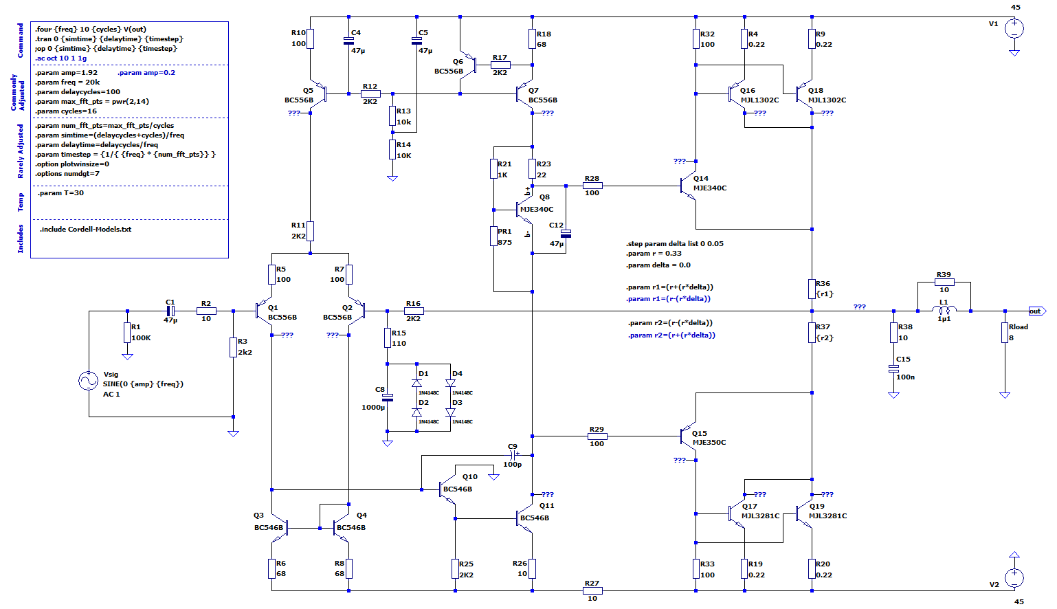

I switched over to a simple version of the Douglas Self's blameless load invariant. I ran the analysis with 0.1R and 0.33R emitter resistors at various frequencies and output levels with 1202/3281 and 21193/21194 output devices.
Interesting result. Green highlighting indicates the lowest distortion level for each test. I don't think there's anything conclusive to gleam. Unless the approach or file I'm using is flawed. I attached the LTSpice asc files in case anyone else wants to tinker (or find those flaws).

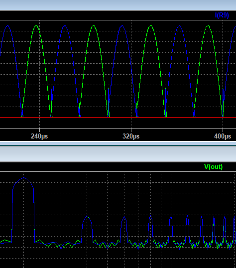

There are pretty significant turn-on/turn-off artifacts in the output stage that are causing crossover distortion. I show these, and the FFT. I like seeing the FFT because that gives more hints about what is going on than just a THD number.
