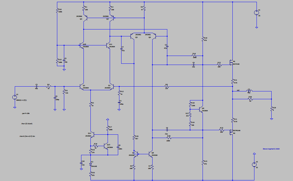

Anyone tried building up an amplifier using Cordell's complemetary diff + current mirror + VAS.
Refer to page 136-139. I built this circuit physically. Of course in LTSpice it works perfectly.
Changed the tail current to 2mA per side.
Changed R5 and R6 to 348R.
Changed R1-R4 to 113R
My VAS uses cascodes at each side using a blue LED as the common base bias voltage.
Simple triplet on the output stage.
The problem exists whether the triplet is engaged or not.
The voltage at the base of Q9/Q11 is much higher than that at the collectors of Q2/Q4.
In Spice they are the same.
Running 16mA up my VAS

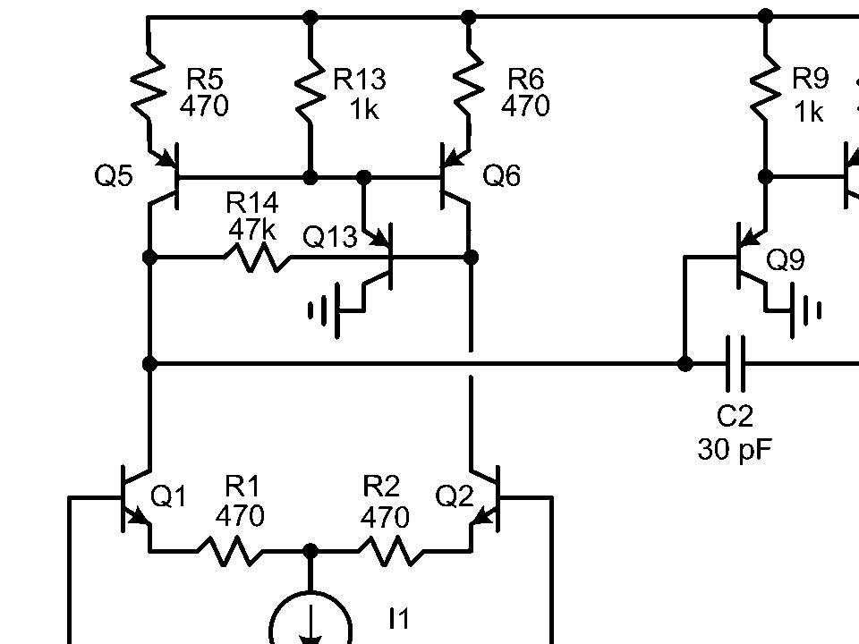

Is this "Figure 7.9 Complementary differential input stage with current mirror loads suffers quiescent bias instability." ??
I'd guess you have quiescent bias instability.
I don't know what point in changing Cordell's values. Using book values, "collectors of Q2" is 1.1V down from the rail. "base of Q9" (collector of Q1) is..... undefined. It could be 0.6V from the rail or a hair below zero volts from common. Q10 could be flowing dead-zero or 2 Amps (@44V rail).
IF it were happy (but we have not caused this to be so) and magically cause 16mA in Vas, then Q9 Base would be 1.55V from rail. I do not know what "much higher" you are seeing. 400mV? 4V? -4V??
Or did you get to the one with R14? (I missed that at first.) You do not say what you changed R14 to. It may matter. I'm also overlooking this LED stuff.

Referring to fig 7.10.
Volt drops across R5 and R6 are the same.
The volt drop from +Vcc to collector Q2 is as expected and calculated.
The volt drop from +Vcc to collector of Q1 is NOT the same as that for Q2.
There is no circuit mechanism that can predict this or am I missing something.

Just say no to complimentary LTP.
The problem originates in the fact that the offset voltage of the NPN LTP and the PNP LTP are unlikely to be exactly the same so they drive the two VAS away from each other and to too much or too little VAS current. Perhaps if the they had separate feedback from the OPS emitter resistors, this could work, but you would need a pot instead of two LPT degeneration resistors on one side, which would adjust the one of the offsets to match the other and set the VAS current and the output idle bias. But then you have a problem under signal where the difference between the two LTP becomes a difference at the OPS and the idle current rises as you slew away from zero output.
No, complimentary LTP is just a bad idea. Using resistors instead of a current mirror works but not well, the VAS has to have degeneration. I do like the P-P VAS driven from a single LTP where the combined VAS current is a constant current.
Cordell
In order to define the current through Q9 and Q11 the volt drop from the +Vcc rail to Q1 collector (-Vcc rail to Q7 collector) MUST 100% be defined both in calculation and in practice.
This affects the volt drop across R9 and R11 and these ultimately define the volt drop across R10 and R12 and thus the VAS standing current.
I have built both Bob's circuit and mine and they exhibity the same issue that VAS current is not definded.
I understand fully the volt drop across say R6 as 50% diff current x 470R.
I also understand the 2 x Vbe drops to get to the voltage at Q2/Q8's collectors.
But there is nothing which allows you to calculate the voltage between the rails and Q1 and Q3's collectors.

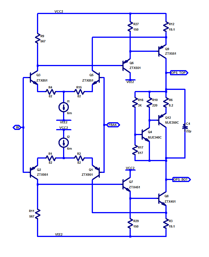

A complimentary LTP is not a bad idea, but you need to know how to handle it. As Bob Cordell already said: "the VAS bias current in this circuit is undefined".[...]
Many people, even a guy like Randy Slone don't realise this. Have a look here.
What you simply need is a "common mode control loop" (CMCL), comprising four additional trannies.
E.
I used resistive loading in my original 200 W amp from 2007 and then again in 2012 on the e-Amp. Both were complementary LTP designs and I had no balance issues. With mirror loaded LTP’s, , the balance issue is exacerbated so you need a CMCL. If the thought of 4 extra trannies fills you with trepidation, you can always slightly unbalance one of the pairs for a penalty of a few ppm.
Do the Lender trick with the first stage to second stage connection. Voila, you get a push-pull VAS with well defined bias currents in both stages. You also get more gain than either resistor loads or folded cascode. (however less gain than a current mirror)
