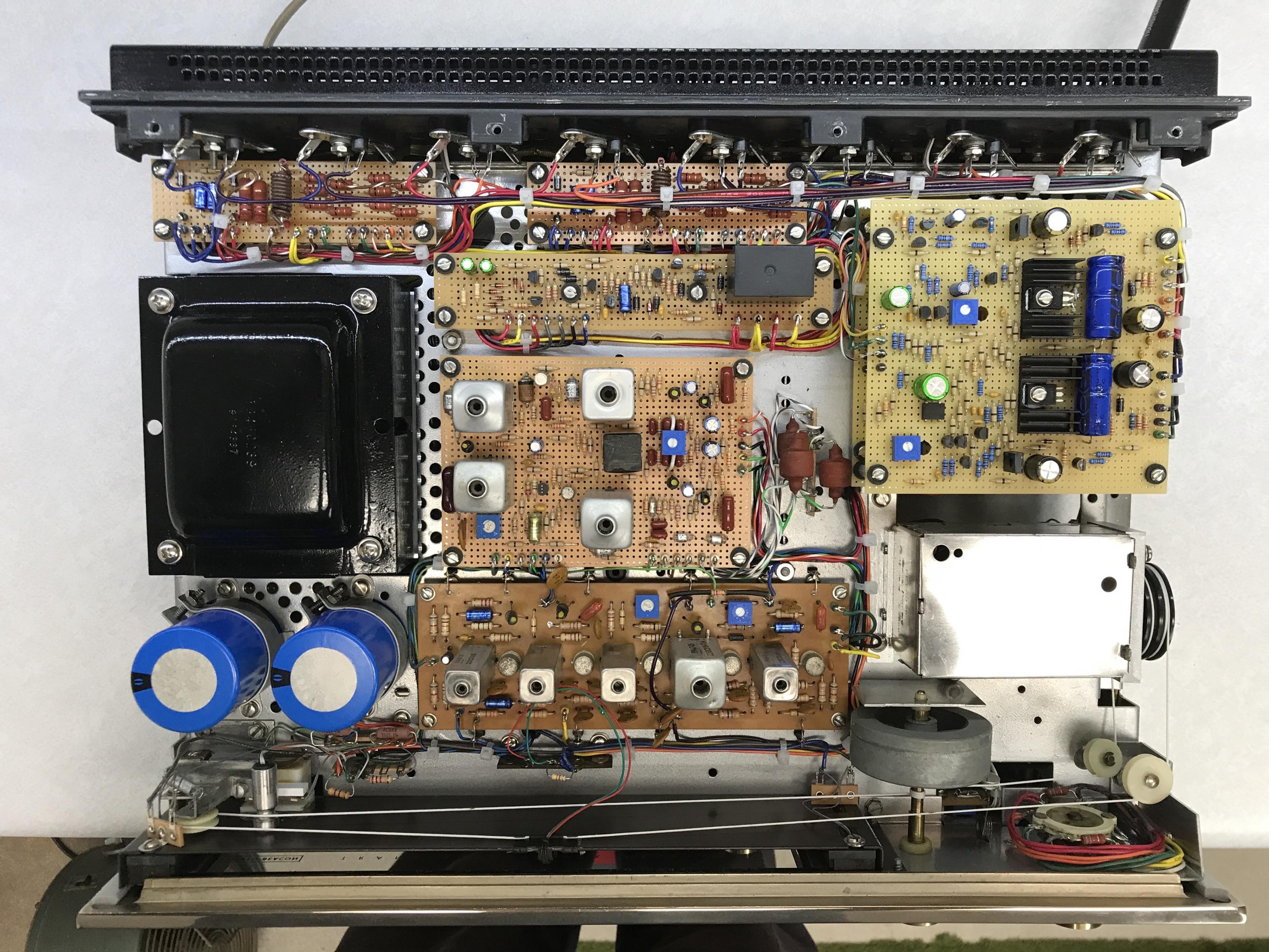

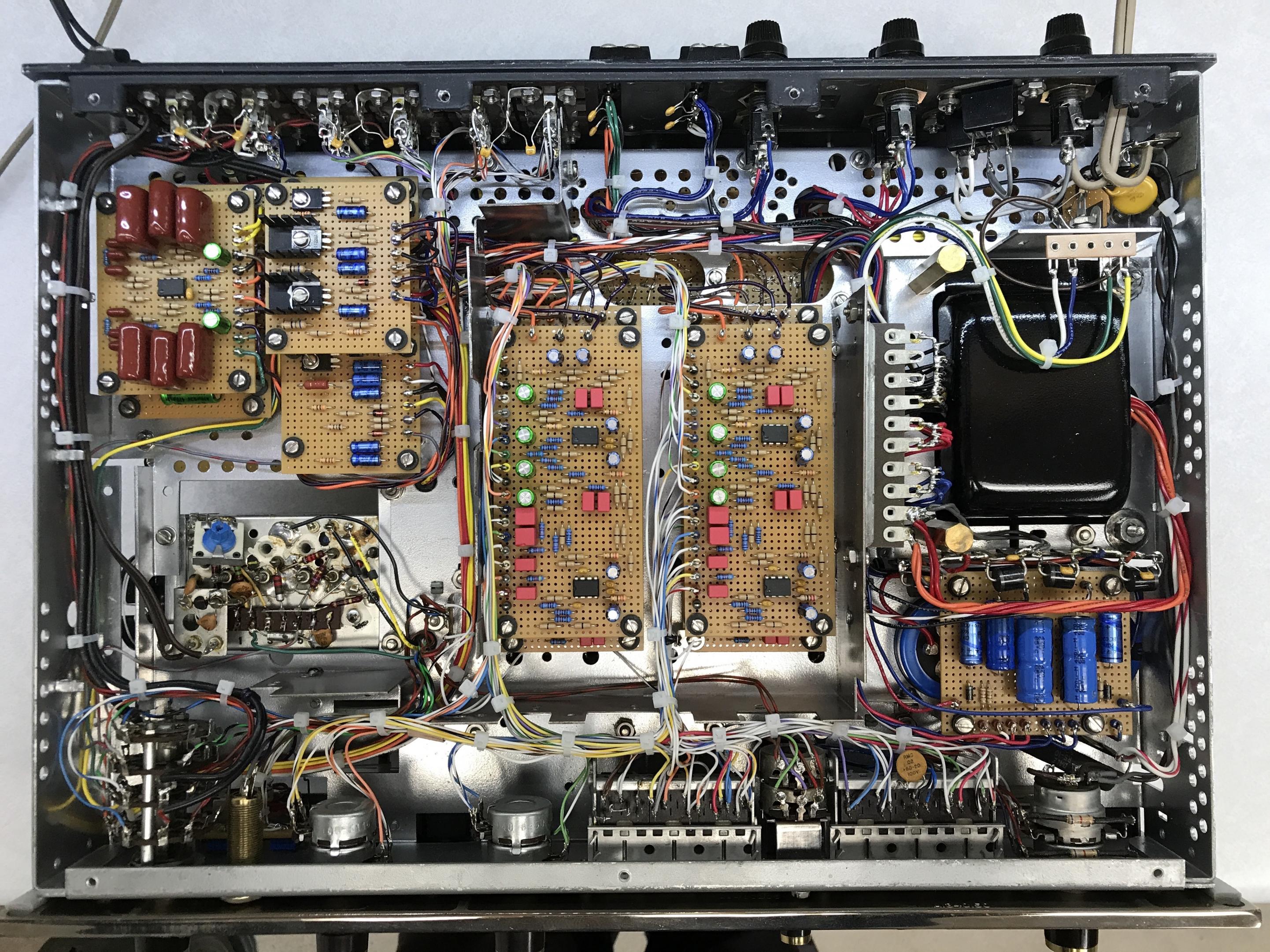

Since my application has been retrofitting vintage equipment, using the existing power supply, headroom is an issue. In one case, the transformer does have a 6.3 V winding (measures close to 7 V) that is not in use. If there were a second such winding, they could be added in series with the main winding, adding almost 10 V to the rails.
Here is an interesting oddball idea: Connect the 7 V winding so the transformer is changed from 30-0-30 to 37-0-30. The result would be 1/2 wave rectification until voltage dropped to where the lower voltage winding would start picking up some of the load.

Again, this amplifier is an upgrade to a vintage receiver. Transformer is conventional, not a toroid. Very little space to add circuitry. Boards are already stacked. It is already good for slightly over 50 watts per channel. Any significant improvement (100 watts) would require about 12 volts more on the rails.

Anatech, You are correct and any discussion of increased power is only discussion. The original unit is a Fisher 600-T and the original power amplifier was 4 PNP germanium transistors per channel in series to handle the voltage. The circuit was essentially from an early RCA transistor manual. What makes this good for the upgrade is that there are 8 positions on the back panel heat sink for TO-3 transistors, so parallel devices was an obvious choice.
