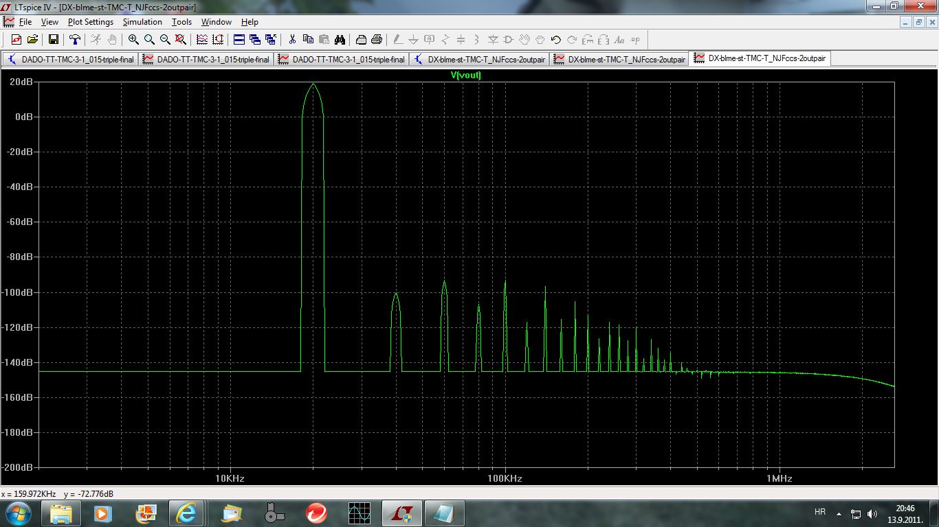

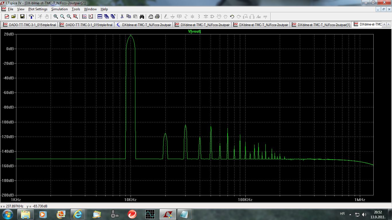

"I surmise that, since the amplifier’s distortion was never negligible, making
it constant across the audio band makes it fly under the psychoacoustic radar more easily."
That is what Putzeys says and probably I took it wrongly. In that exsample the amp distortion was never negligible. But in the case of my amp, in my opinion, distortion was negligible without gain redution at low frequences and stayed negligible with the gain reduction. A bonus is better phase behavior, I was afraid a bit of instabillity.
At Loop Gain diagram you can see that there is more then 60dB of negative feedback.
dado

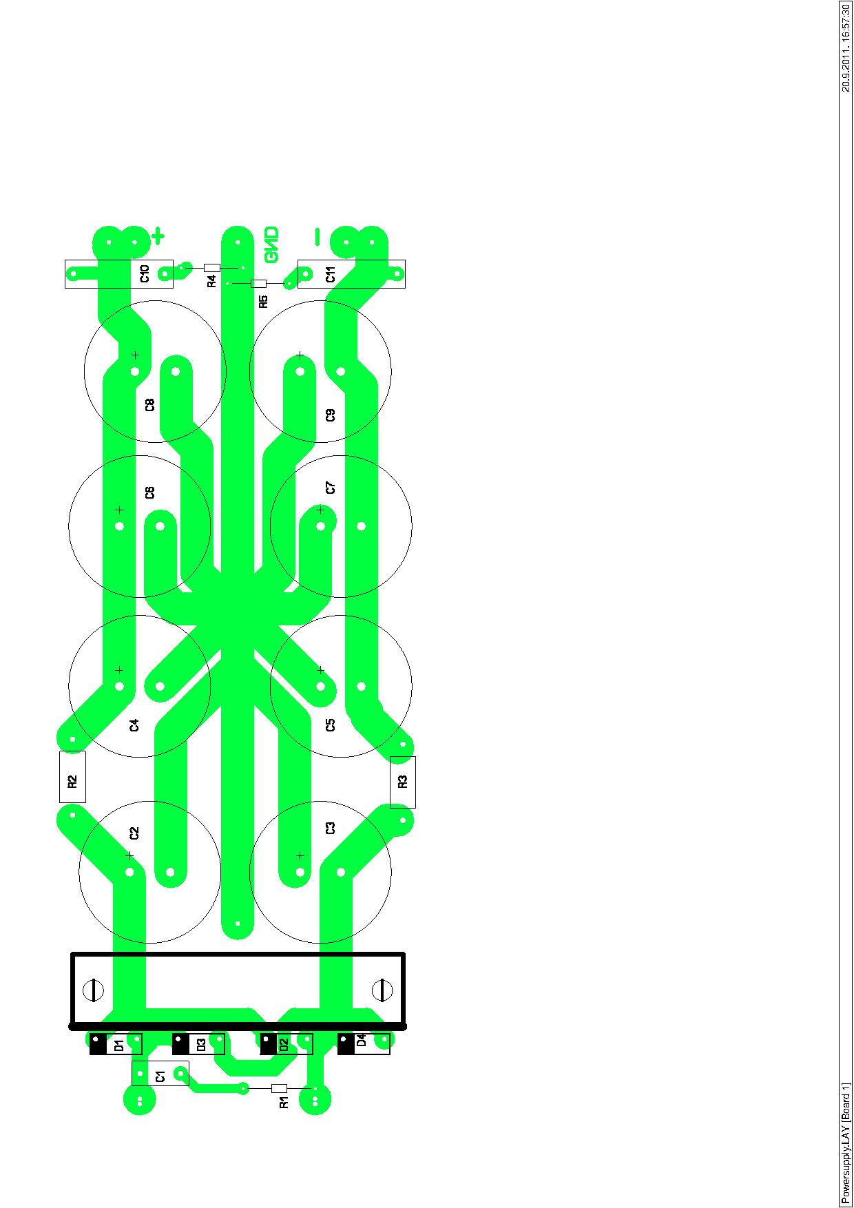

Hi all, Dado,
The best way for a beginner like me to tell if an amp gives musical results is building one... For an engineer or technical, the scheme is essential, but I presume not the last word in case of doubt. After building the JLH 80W, whose sound is already very rewarding in the stereo version, I’d like to go further, in a double mono version this time. I don’t intend to build lots of amplifiers because I've no other skills than Ohms law and there are enough to do to improve the whole system before. However I guess this is a good one, doesn’t it ? Let’s go, for it with your help... For me, this is a challenge.
Could you prepare, Dado, one image for a power supply and amplifier PCBs ? I could then eventually try to design a PCB from them. I’ll prepare a list of components for it, but I’m not sure what is the last version.
Thanks !
Nicola
Hi all, Dado,
Thanks !
Nicola
OK I will check all again as same time passed after I finished my amp. For power supply I will suggest what I used and then you can make dual mono. I'll be back soon.

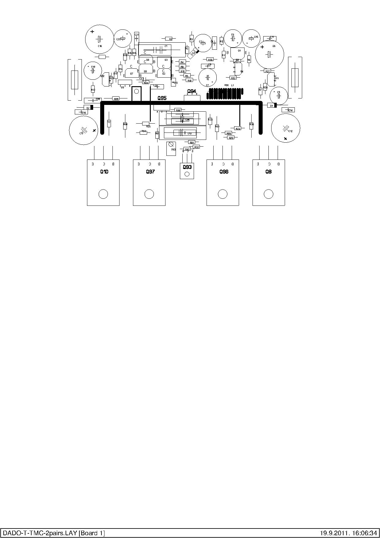

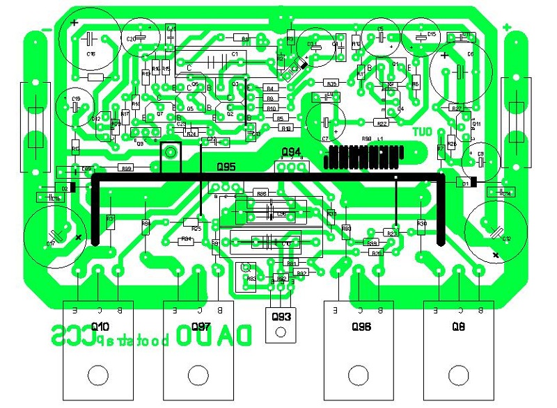

Hi vac231,
Here are PCB layout and PCB to be used for PCB making. Mirrored one is for the photo way to produce PCB and other one is if you whant to use hot iron and laser printer method.
Please check before you start to make PCB and report all errors. Just to remember that on the PCB layout R20 is combination of NFET and resistor, I attached the photo again.
dado

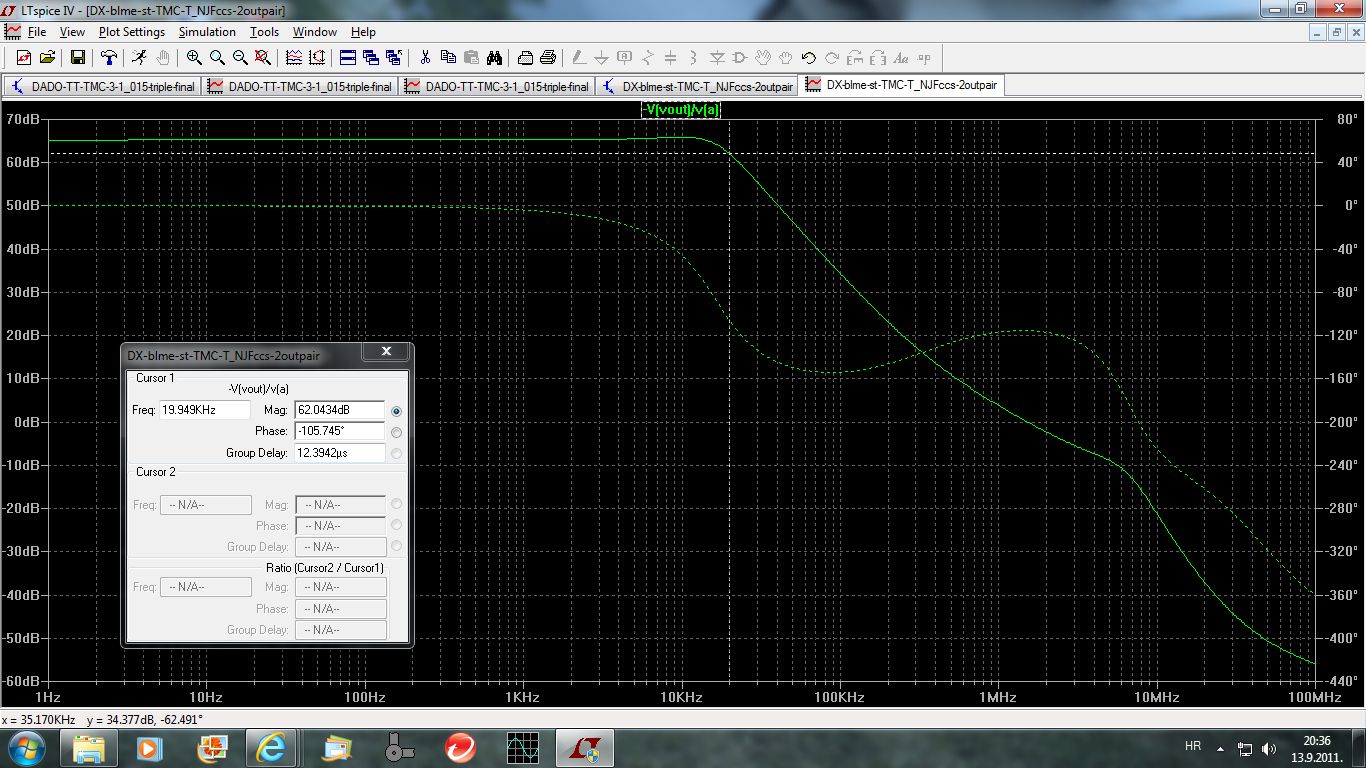

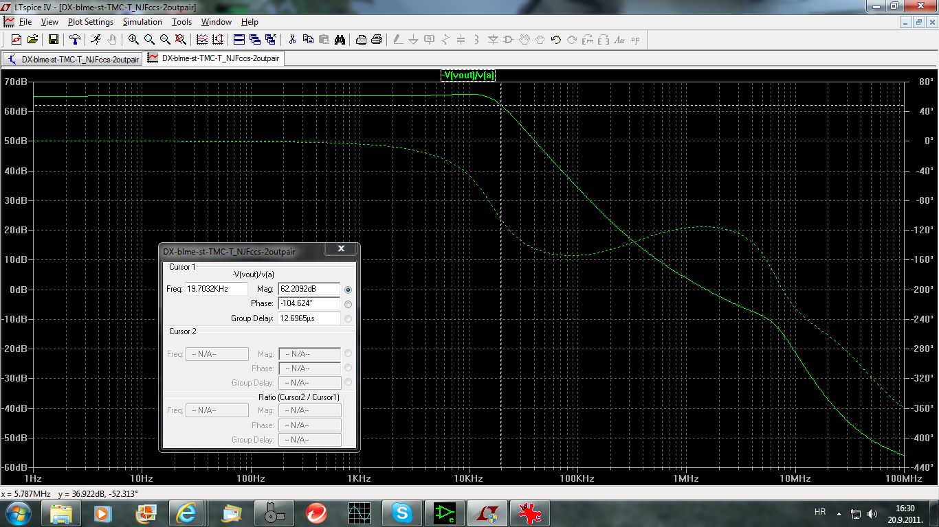

Oh in that case I wouldn't bother with things like flattening loop gain. I merely noticed that it was perhaps the least "scientific" bit that was lifted from the F article.
Here on this forum you can find a lot non "scientific" explanation. I took that part from from the F article as here this amp was made before I have found yor article and what you said looked resonable to me. I suppose you meant it for an amplifier whit not so low distortion.
Main reason I used it, was better phase behavior then whitout it. Distortion was quite low already.

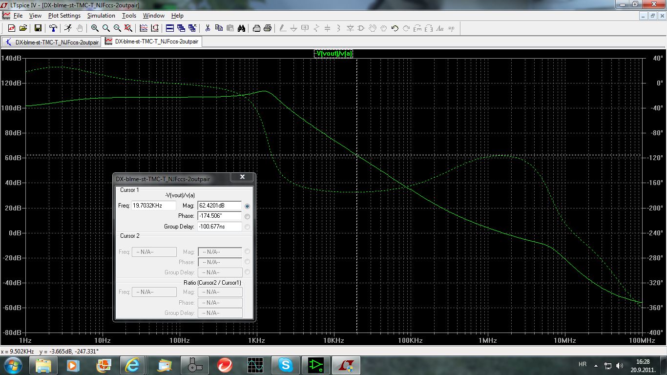

Here are two Loop Gain diagram, one without local VAS FB and one with it.
First one shows phase drop to -174 degree at 20kHz and second one only -154 degree at 80kHz. Phase margin is the same, 65 degree at 2MHz, where the gain drop to zero.
Anyhow I tried both way and I could not hear diference, just I expext the second one could be more stable.
Dado

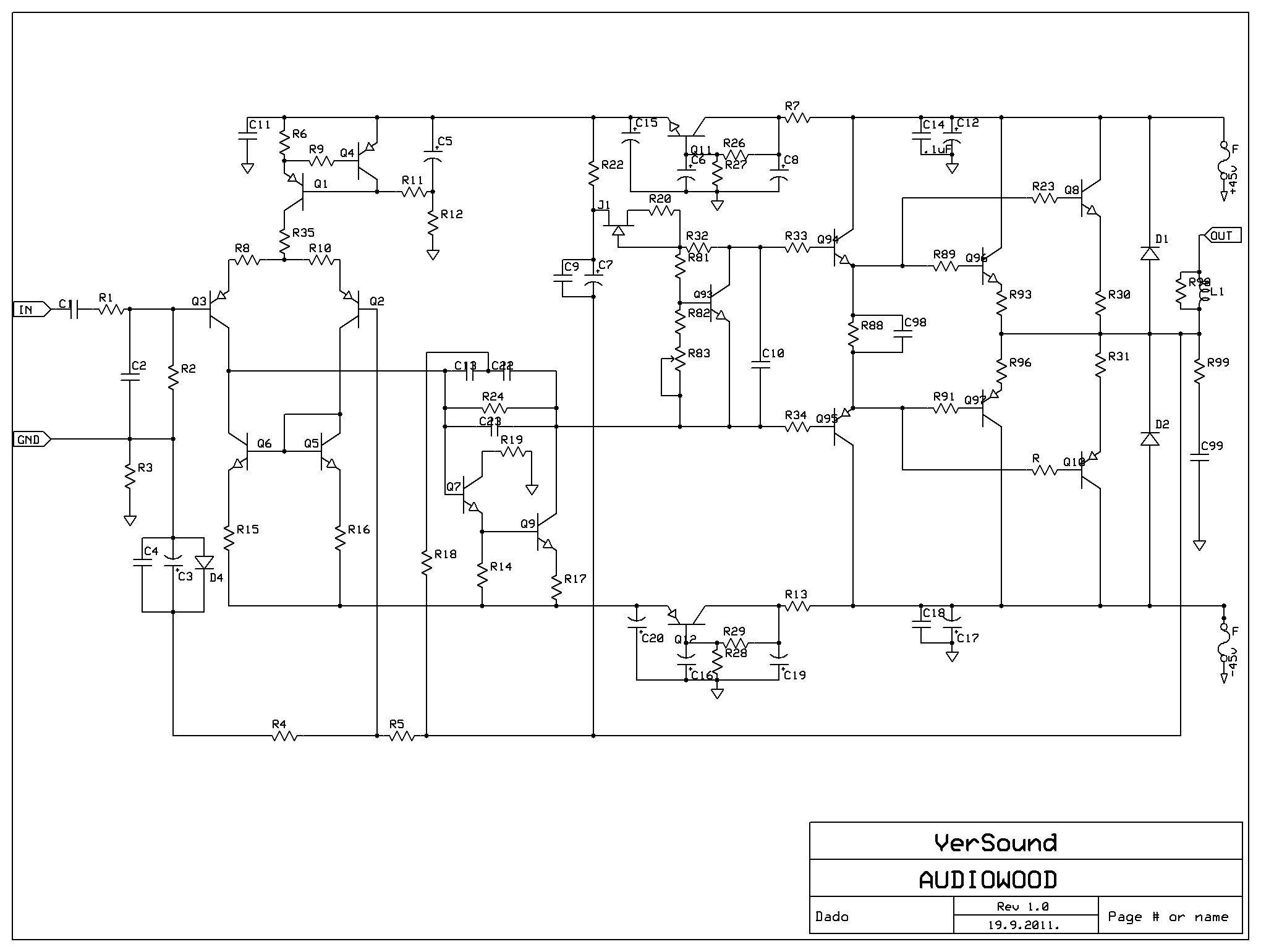

Hi Dado,
I checked your BOM with my list based on your previous schema. That’s OK for almost all components (I saw some changes in capacitor and resistor values).
I’ve some questions :
a) In your previous schema, Q11 was BC556B and Q12 BC546B. In your last schema, values are inverted. What is correct ?
b) D01 and D02 are MUR460 in your previous schema. I found ON SEMICONDUCTOR MUR460G. Are other types possible ?
c) Reference for L1 (2uH) ?
d) Q1, Q2, Q3 (2SA970). I found Toshiba 2SA 970BL. OK ?
e) Q5, Q6, Q7 (2SC2240). I found Toshiba 2SC 2240BL. OK ?
f) Q8, Q96 (NJW4281). I found ON SEMICONDUCTOR NJW0281G. OK ?
g) Q10, Q97 (NJW4302). found ON SEMICONDUCTOR NJW0302G. OK ?
h) Q9. I found Fairchild 2SC3503 STU Series with various hFE. Which hFE to choose (40, 60, 100 or 160 ) ?
i) R83 (1K). Is multiturn trimmer and which power handling ?
j) I found that electrolytics C5, C7 and C10 were normal ESR and other C6, C12, C16 and C17 were low ESR. Is that correct ?
k) Can I replace fuses with a special card for DC detection at speaker output, or are this two types of protection complementary ?
l) Are all resistors 0.25W (but R99 3W) ?
Could explain what is the topology difference with JLH 80W amp in simple words ?
Nicola
Hi Nikola,
Here it is:
Q11 - BC546B and Q12 - BC556B I did a new drawing with expresSCH software and made a mistake
Any diode 300-600V and 3A or more.
I used 1.2mm diametar enameled wire and coild it on 7mm dia pencil cca 20 coils.
OK
OK
OK
OK
I used series E 100-200, F is good to 160-320
Look PCB, it vertical type normal one(very low power handling)
Only C5 is not important, all others better to have low ESR. C10 is not elko (0.22uF)
I never use a relay in the audio chain. Off course you can use special card, but if it uses a relay to switch of the loudspeaker
conntact will deteriorate durin the time and I don't like that. You can live fuses it will not have any influence.
R98 should be 2W and R99 3W, all others 0.25W is OK.
Regarding JLH 80W amp, it uses lateral output FETs and uses quite low negative feed back, cca 20dB at 20kHz.
My modification of JLH uses cca 40dB of NFB at 20kHz.
I am still listening this amp, and it is very stable, not so before mdification.
This amp here is classic one with all bipolar transistors, but with very high negative feedback cca 60dB at 20kHz. It is possible to have it so high because it uses different compensatio not standard Miller compensation, so called TMC. If you like to know more about it search this forum, there it was a lot discution about it.
Dado
C3 could be 10V and if you can find with so low voltage you can increase the value even up to 1000uF. D. Self recomandet here high value but best quality you can find, Elna silmic or better.
C5 could be less then 50V but not less then 30V if there is a one with that voltage.
C7 better to be 63V.
all others 50V is good enough.
