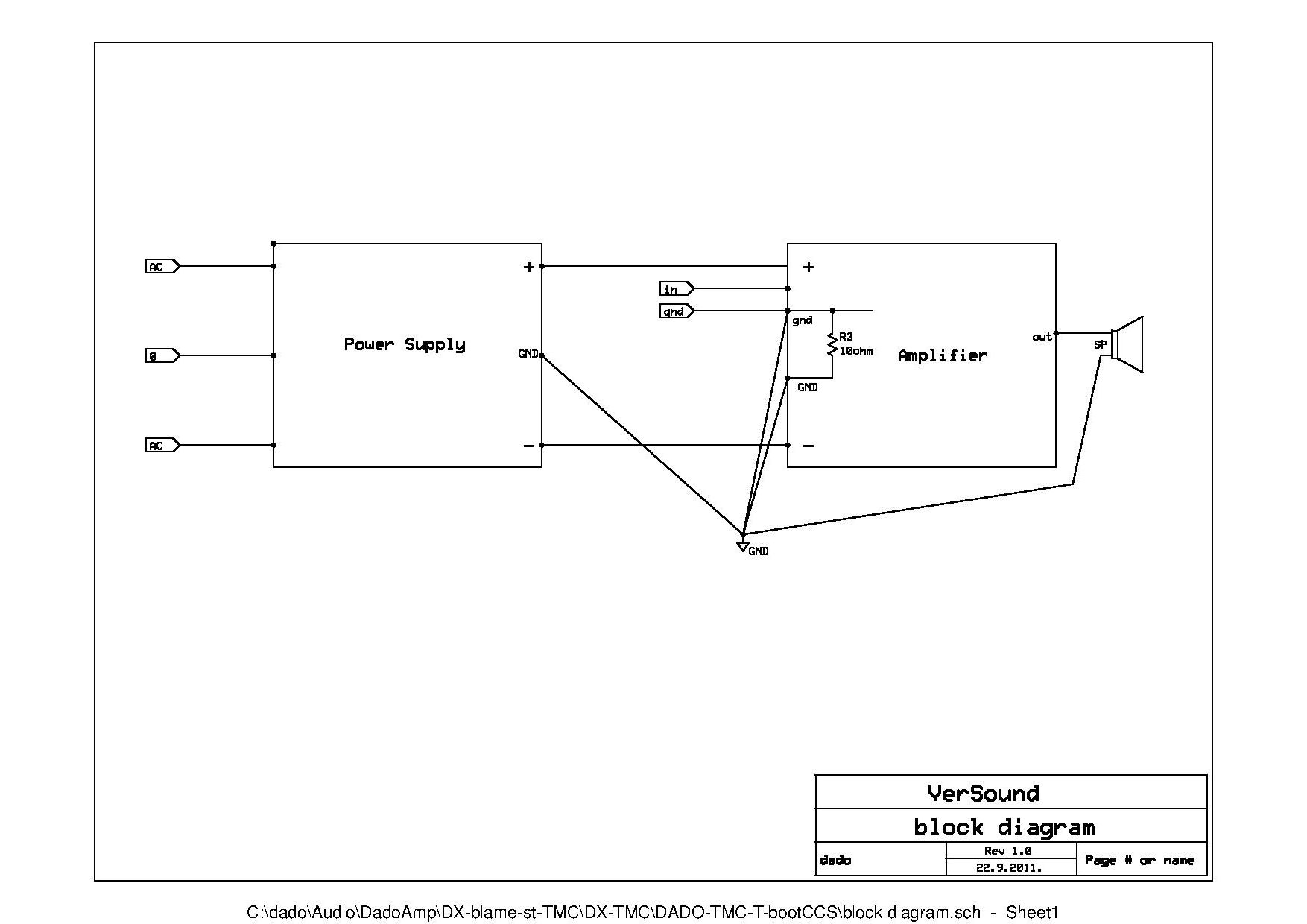

For amp:
Could you please verify where I set the returns (ground) points for speaker output and input cable (see photo below) ?

Regarding the ground connection I will prepare a block diagram of it asap. This is quite important to avoid ground loop and prevent the buzz from 50Hz to enter the amp.

Here is the block diagram of the power supply and amplifier connection.
The GND on the amp is main ground or zero V. The gnd is input ground connected internaly to the main ground via 10 ohm resistor.

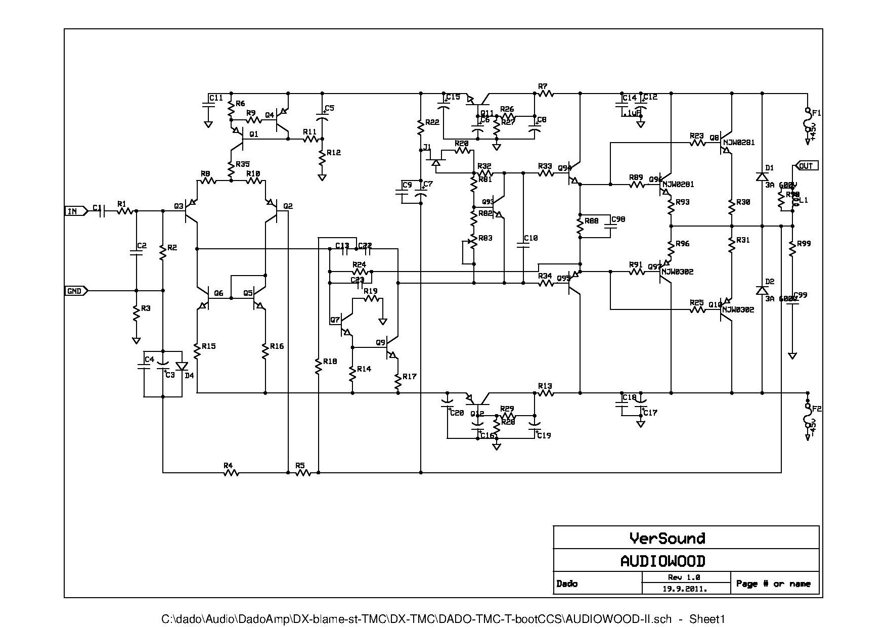

I finished to check layout components with BOM and schema. All is OK. I just noticed R25 is there, but not marked as R25 in both schema and layout. That's all...
About ground loops, I experimented them in my current system when building JLH 80W... I'm very attentive to this chapter and your own experience! I'm reading deeper your block diagram this evening.

Hi Dado,
My mistake for R25. This resistor is written R without number on schema dated 19.09.2011 01:37 PM, but shown in layout (dated 19.09.2011 02:05 PM.)
R28 is shown on layout, but without number (same layout).
You say invert Q10 and Q97, but they seem correct (same layout).

Here is a suggestion to try something. The new schematic shows R24//C23 connected to the emitter of the Q95 instead to the collector of the Q9. This should render a bit lower distortion as will not load the VAS. I simulated it only, no listening was done.
Dado
