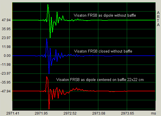

I wrote "reflections" in quotes because it is edge diffraction really. Did you ever compare impulse responses of the same driver in baffles of rather different size?
![FRS8_comp_imp.gif FRS8_comp_imp.gif](https://www.diyaudio.com/community/data/attachments/263/263460-c08f17764efee41b884af6739c19c4a1.jpg)
These are impulse responses of a small FR driver, taken from sweep measurements at 50cm distance. Green for the "naked" driver, blue with a cup on the back not larger than the driver, red with the driver centered on a square baffle.

I believe we were talking about effects happening in the first millisecond:Impulse response of on of my dipole speakers shown below.
So we would need a still higher resolution of your impulse responses to "see" the dipole edge.The problem is how to attenuate it below audible levels. Even the best absorbtion materials placed close enough to the sound source (the speaker cone) will give reflections that are clearly audible.
My point is that you don't hear a separate reflection within 1 ms of the original sound - as would be the case inside a speaker box. What you possibly hear is the decaying resonance which may have built up inside a box.
