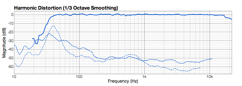

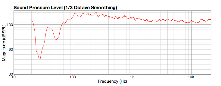

Now we look at Exhibit B,
my most recent model which is an OB panel speaker using a full-range and a woofer in a time-aligned FAST type of arrangement.
Like my reference model, it also uses a lot of DSP to correct the timbral imbalances from the drivers, and in doing so attains 40Hz to 20KHz +/- 0.5dB in anechoic conditions. It is also time-coherent and fairly efficient and has wonderful imaging. Great! And it is fairly constant in its directional characteristics, not exactly CD but close enough. Great!
So guess what happens when you put it in the same lousy room? The sound remains great, WITHOUT the need for ANY room eq or treatments.
Now Joni Mitchel doesn't have a chesty voice anymore! The actual in-room response is within +/- 3dB in the SAME lousy room!
So look at the graphs of anechoic (actual FR w. distortion measurement) vs in-room... almost no need for special room treatment or additional room eq in almost ANY room. The new system is 10X less expensive than my reference, nearly equals it in anechoic performance and is clearly better in most rooms unless one is willing to pay for maybe a week's worth of eq'ing and fine-tuning.
In a head to head comparison, without room eq, it's hands down a better speaker. With room EQ, it's dangerously close to the reference model, at 1/10th the price.
Does this mean OB is necessarily better? Not at all. But I will venture this opinion informed by experience: when properly executed, a good OB speaker will be MUCH easier to use and sound much better in many more rooms than most other types, simply because they have much less interaction with the room resonances. (At the frequencies where they count the most!)
OB rules!

So look at the graphs of anechoic (actual FR w. distortion measurement) vs in-room... [...] when properly executed, a good OB speaker will be MUCH easier to use and sound much better in many more rooms than most other types, simply because they have much less interaction with the room resonances. (At the frequencies where they count the most!)
OB rules!
Your graphs seem to indicate the opposite is true? The in-room response looks pretty scary below 100Hz, even with such a high amount of smoothing.

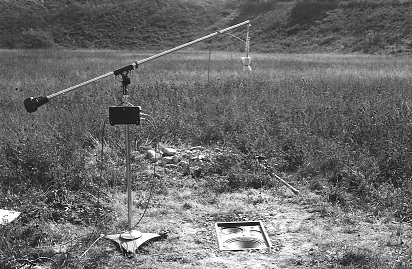

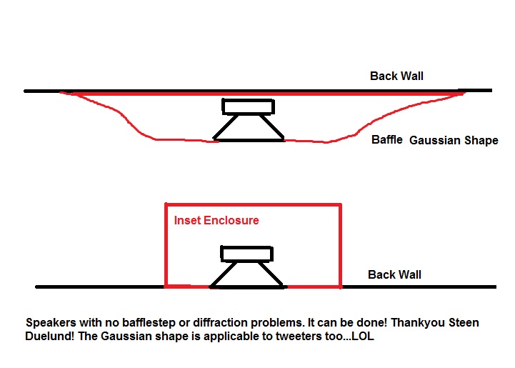

Steen Duelund: How to build to the limits of possibility favours overdamped (Q= 0.5) closed box. Not quite acoustic suspension, the box is bigger, but strong magnet and low Fs and Qt. I suppose this is as near as you get to infinite baffle, but the idea is you can match the 12dB rolloff with the approximate 12dB rise in room resonance.

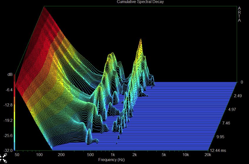

Since the topic is box colouration, diagram 5 illustrates a waterfall of time delay on a cheapish 218x275x400 mm Usher 701 reflex speaker with an unpleasant boxy resonance at around 850Hz. This appears to be all three sides standing waves peaking at the same time, since the box disobeys the classic 0.618:1:1.618 ratio which pushes resonant coincidences up to the 5th harmonic at 2000Hz.
With closed box, it wouldn't be hard to add some damping stuffing, but a reflex, IMO, just has to live with it.
