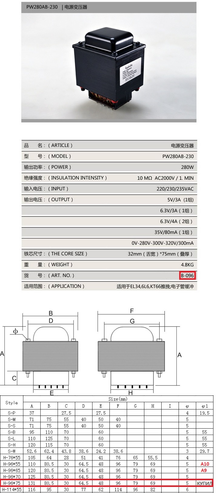

Use 0.35, 96-60 large power core manufacturing, design power of 200W to ensure adequate power and low temperature rise.(HIFI EXQUIS) - IT'S A LIE!
You have a transformer 96-50 Take a look, please BouyyA10 — imgbb.com BoyuuA10 — imgbb.com Bouyy-A10 — imgbb.com
sooner or later it will burn you smoking.

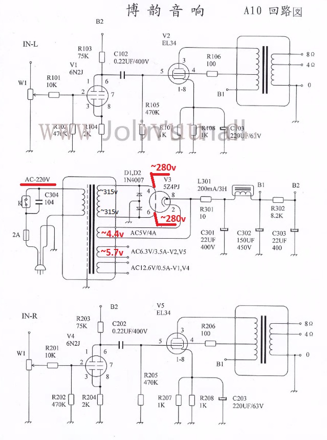

do I have to run the cold mode of the all above treats before, to get a conclusion. please help give me a good schematic, that is safe (SOA) running on the power transformer.
Thanks.
Amplifier circuit one you can see,
For the amplifier to work well and in the cold mode, you need a powerful transformer and not the one that the Chinese shoved. Good, I highlighted in red

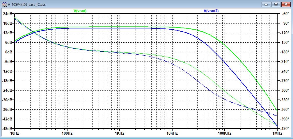

Hello,

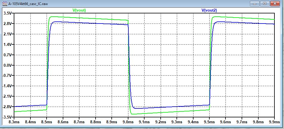

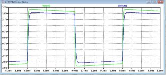

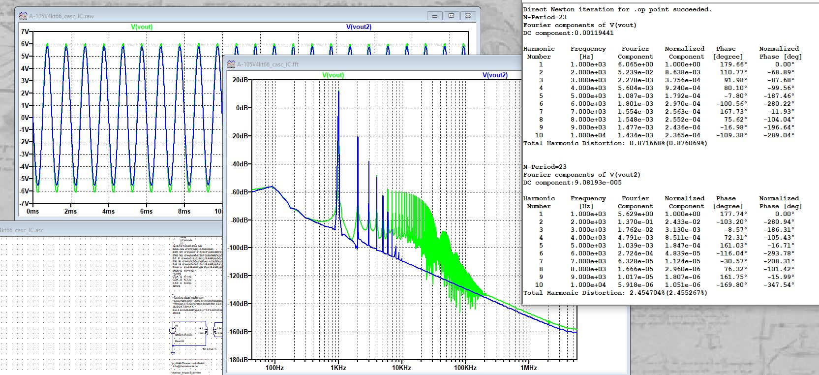

I really liked this thread so far. I have a proposal to cascode the parallel input tube to compensate for the miller capacitances. I propose a simple NPN transistor because of space and power concerns as well as the upper element doesn't add anything to the signal.
Benefits are:
- higher bandwidth
- more linear phase in audio band
- higher slew rate
- lower Rout of first stage (1/3 @same power)
- less distorsion (ok, FFT looks worse)
I simulated it in LTSpice. I add the scematic and some pictures. Green is the cascoded and blue is the original signal. Would this work?

diyHeini,
When you propose a change from one circuit to another, can you please tell us what post # you are changing from... Then please provide us with a schematic of what you are proposing to change to. It is real hard to know what you are proposing from a thread that is 66 posts deep.

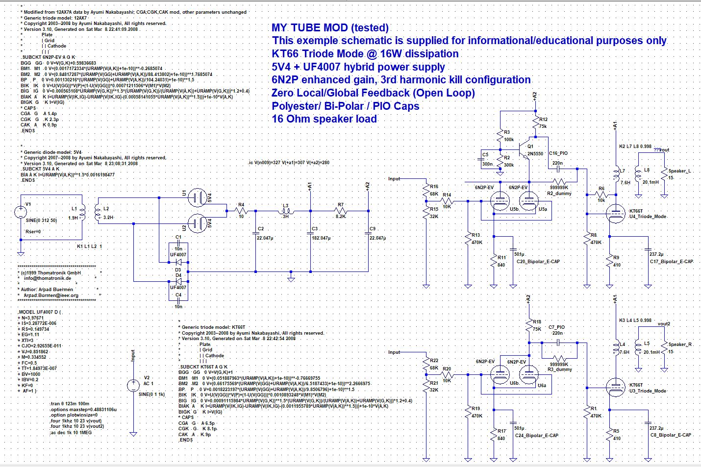

Thanks for your remark! I will correct that.
My generall proposal was a input cascode.
I referred to the schematic posted by ygg-it in post #11.
Here is the LTSpice schematic as a picture.
Cascode input:
C16 220nF and R6 10k will be -3 dB at 72 Hz, and -1 dB at 144Hz. R6 will cause the KT66 to draw very high plate current. It is DC coupled from the plates of the input tubes to the control grid.
Are you using R6 for Schade Negative Feedback? That is what R6 effectively is.
R12 75k? Cascode collector is very high impedance, that is in parallel with R12, 75k That has to drive the KT66 miller capacitance (higher C in triode mode than in Pentode mode). It also has to drive the node of R6, C16, and control grid.
What does R2 dummy resistor do? Are you going to use 100 Ohm grid stopper resistors for each 6N2P grid? R17. There are no individual 1680 Ohm self bias resistors for the two input triode cathodes, current may not be balanced. It will need individual bypass caps.
Non Cascode input:
R20 has to drive the miller C of the input tubes. May need a lower value. Instead take out R20. Put a 1k Ohm grid stopper resistor on each input grid (right at the tube socket tab). R3 Dummy, what does it do? R17. There are no individual 1680 Ohm self bias resistors for the two input triode cathodes, current may not be balanced. It will need individual bypass caps.
The triode input stage is a lower impedance drive for the triode wired KT66, Good.
