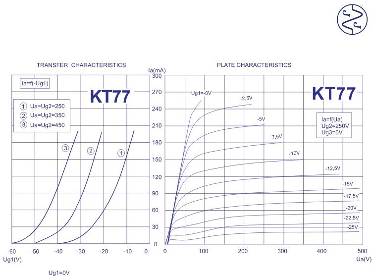

At which supply voltage and bias?
KT77 A.F. BEAM PENTODE
Base: OCTAL
Uf=6,3 V
If=cca 1,4 A
Typical characteristic: Ua=250 V
Ug2=250 V
-Ug1=15 V
Ia=100 mA
Ig2=10 mAS=10,5 mA/V
Ra=23 K
μ=11
