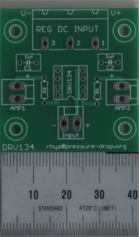

thank you for the measures. I need one more though: what is the size of the drv boards (total size and between holes).

shmulik said:thank you for the measures. I need one more though: what is the size of the drv boards (total size and between holes).
Here you har the drv scan in high def:
http://ignatiusprojects.blogspot.com/

now if you could roll that PCB 90 degrees and show the other dimension that would be perfect, unless it is a square (seems a bit higher than wide on the photo).
I wish the PCBs could be sent over email or downloaded from the forum just like pictures...
42x43,50mm
Here you har the drv new scan in high def:
