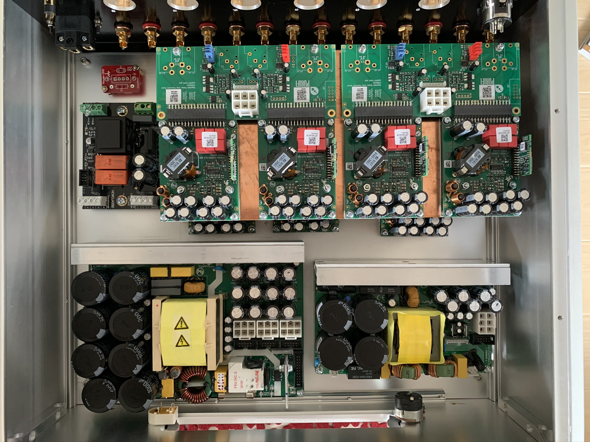

Hi all, I'm new here on this forum and on the verge of building my very first amplifier using these Purifi modules along with the SMPS1200A400 power supply.
I'm reasonably technical, but this is my first time dealing with electronics and I don't have an electronics background.
In my build I would like to add a push button to the front of my case to toggle between standby/on, as well as a 12V trigger input to the back for integration into the rest of my system.
I had emailed Hypex about their soft start module (which would have made integrating a front switch pretty easy) and they said that module doesn't support 12V triggers.
So a few questions:
1. Is a soft start module with inrush current protection really necessary?
2. If yes to 1, does anyone know of a way to integrate a 12V trigger with such a module?
3. If no to 1, what is a good and relatively easy way for a beginner like me to build in a front push-button and 12V trigger? All I know at this point is that I'd need another 12V power supply for the trigger functionality.
Thanks!
So a few questions:
No.
Small, low-power 12 V changeover relay is the simplest solution.
