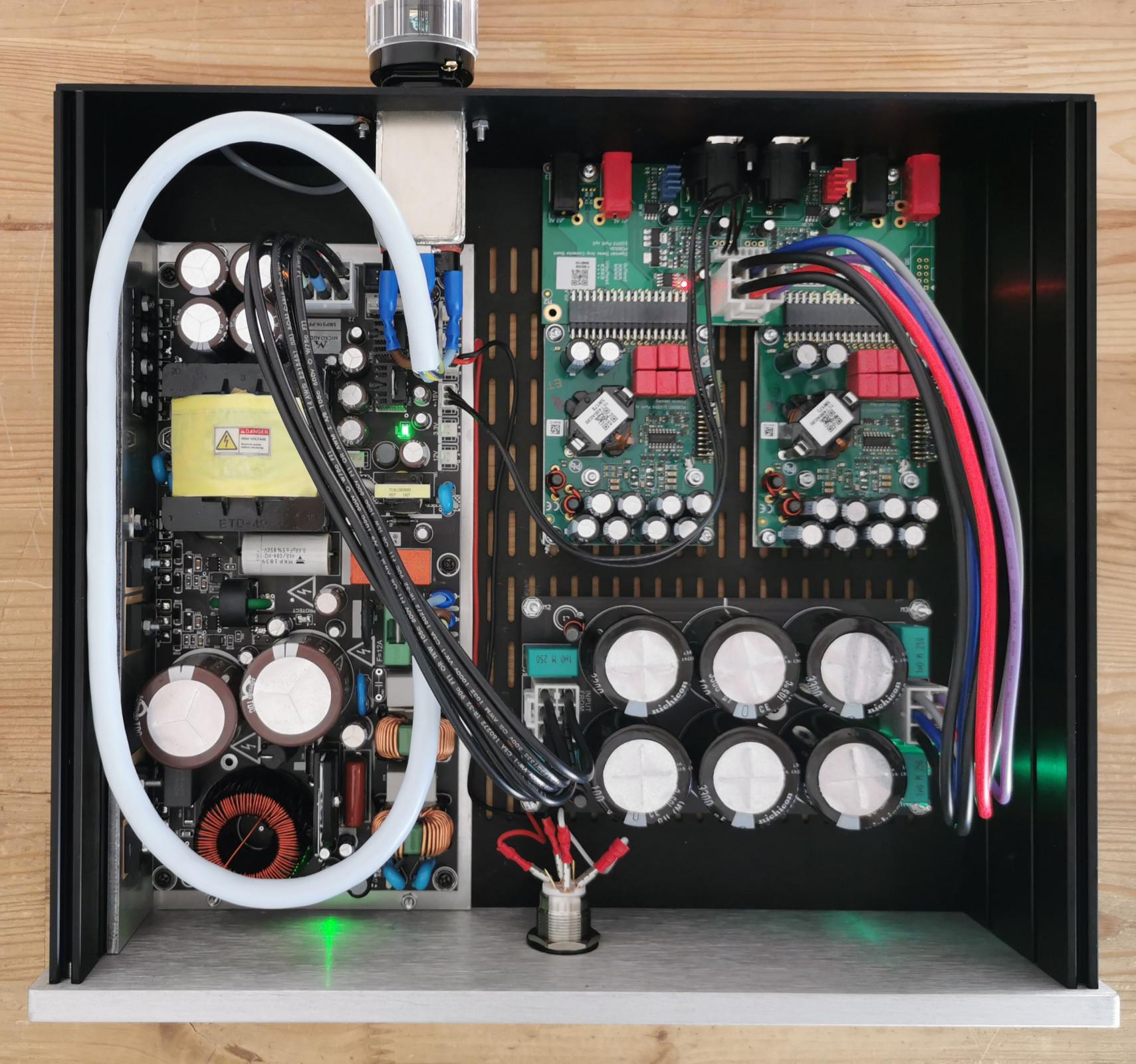

SMPS1K-PFC
Purifi 1ET400A powered with the SMPS1K-PFC.

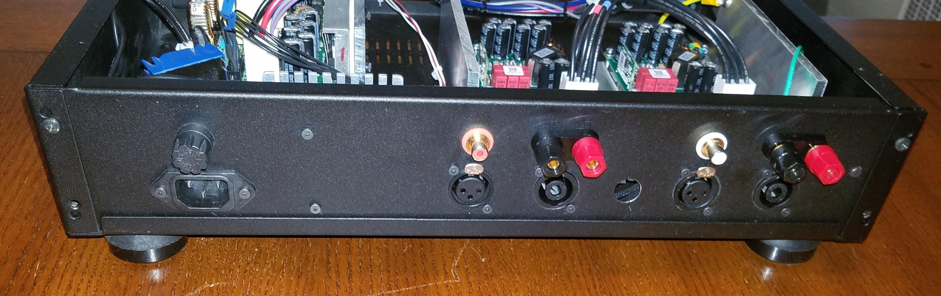

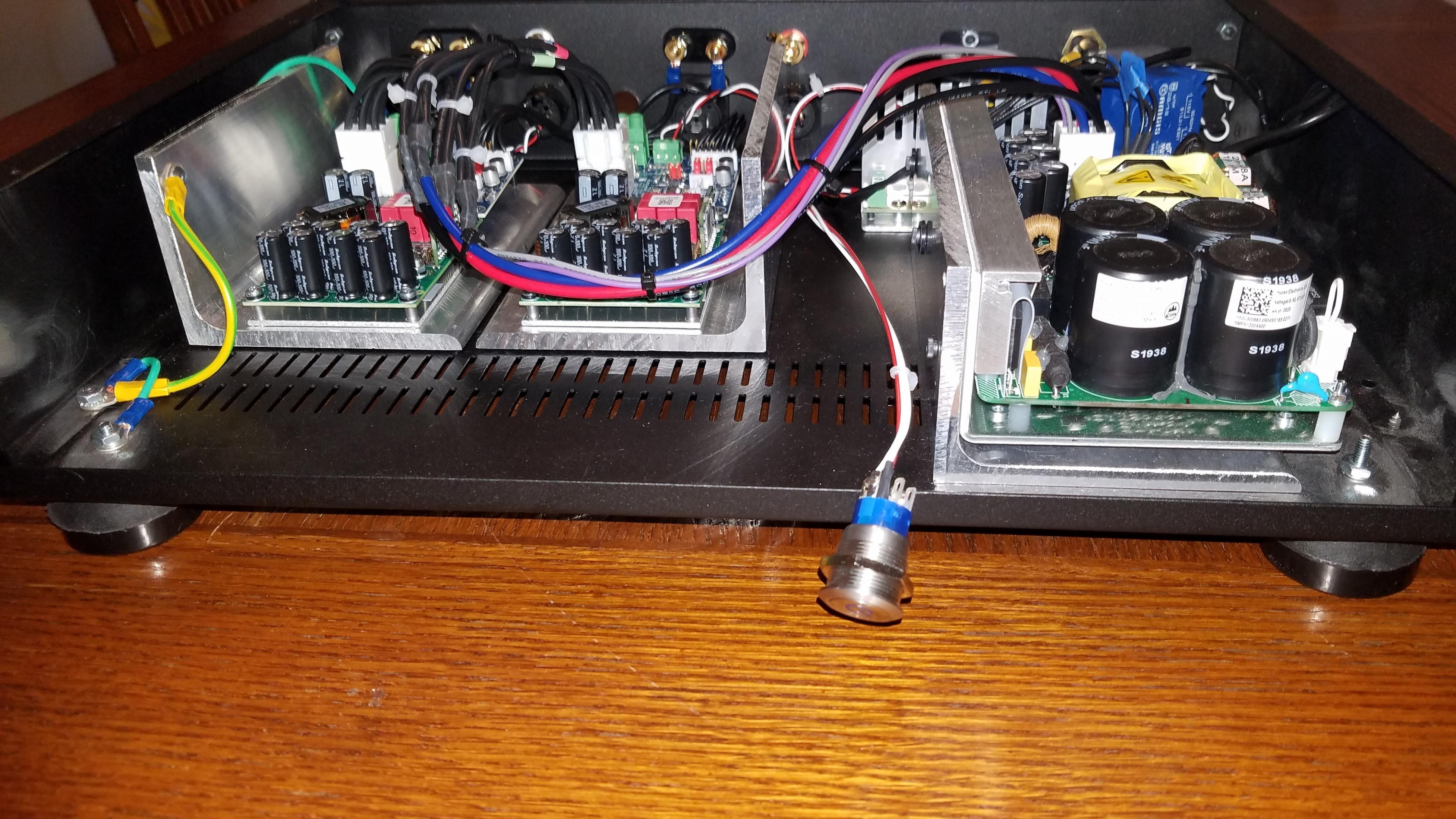

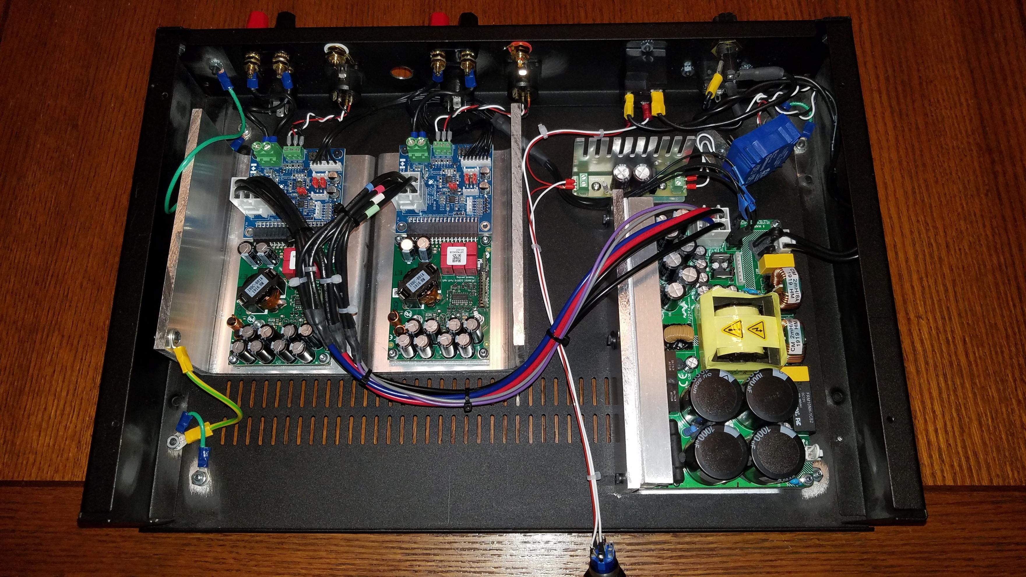

My Purifi Stereo Amplifier Build
So here is my not-quite-finished implementation of a stereo Purifi amp build.
There is more involved in putting one of these together than I expected. A lot more time was spent figuring out the layout and the penetrations pattern than I thought would be necessary. Then there are the little details concerning connectors and such.The connections to the amps themselves ended up being the easiest part.
I made all the penetrations in the back panel myself using a punch and a hand-held drill. I would probably pay to have this done at a machine shop if I were to do it again. The job I did is acceptable, but far from perfect. It would have been a lot easier to add my fittings to a pre-cut panel, and since I already had the drawing it would have been trivial to have this done professionally.
I spent one evening listening to the amp in its current state: No disappointments--the upper-register detail is to me the stand-out improvement, but everything else sound very solid as well. For that listening I was connected directly to my TEAC NT-505, but in future I will be feeding it with my Emotiva AVR pre-amp.
The parts not yet complete are:
  • wiring to the Speakon connectors--As soon as I make some better quality speaker cables with Speakon ends I will be using these in lieu of the banana plugs.
  • Wiring to toggle for SE vs. Balanced input -- the toggle will short the balanced "-" to ground in the case of SE source. But in practice I will be feeding the amp with a balanced source.
  • I already wired up the cool LED switch, but need to have the .75" hole drilled in the 10mm Aluminum front panel for mounting this switch.
It's pretty clear that I borrowed ideas from previous posts on this thread, (i.e Aluminum "L" brackets for heat sink, cool LED switch with relay, etc.) I'm thankful for these good ideas.
The Neurochrome buffers are well thought out, and documentation is extremely good. With these I don't have to worry about soft start, or auto-shutoff in case of high DC, and things like this as they take full advantage of capabilities of the Hypex power supply.
For making the power Y connector between the two buffers and the single PSU I first soldered the pairs of wires from the two buffers after zip-tying them together, then I soldered the appropriate PSU wire to the joined pair. I covered the solder joint with shrink wrap.
I have not yet decided if I need to connect the remote sensing to the speaker post--it's hard to imagine it will make much improvement given the fact that they are already routed to the Neurochrome outputs, and the short connection between those outputs and the speaker binding posts on the amp. I am not considering a connection all the way to the speaker.
I have purchased the Neurochrome external regulator boards, but haven't installed them yet. I will at some point but am not sure I will hear a difference. For now I want to start enjoying my amp as soon as possible.
