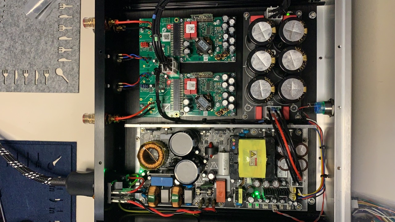

I was doing some testing here with my Connex SMPS 800re and Purifi modules and found a problem. While testing with a "brown noise" file I use for break in/testing, the amp modules started intermittantly cutting out, with the indicator LEDs also going out. It appeared that the amp protection was kicking in. I measured the voltage rails while playing (nominally +/- 65 VDC) and saw the voltage jumping all over the place, including to well over 70 VDC.
I contacted Connex and asked them about it, and they suggested it must be due to power supply pumping, and suggested adding 4700 µF more capacitance to each voltage rail, and then to test again. I have not done that yet...
I would suggest that anyone using the Connex supplies with the Purifi modules, take the time to monitor the main power supply rails while driving the amps at a high level to be sure things are OK!
I am going to order a Hypex supply, and test the Connex SMPS 800re with additional capacitance as well. But even with the Hypex supply, I will continue to use the custom linear I built for the +/- 18 VDC supplies, as it is working perfectly.
And, thank you Purifi for having good protection features built into your modules!

I tried adding the extra capacitance as suggested by Connex, but that did not solve the problem. I ended up using a Hypex SMPS 1200 instead which has no issues. I still end up using my linear +/- 17VDC supply for the input stage and modulator, the amp sounds fantastic. Next experiment is to try some Sonic Imagery discrete opamps in place of the eval board's OPA 1612...

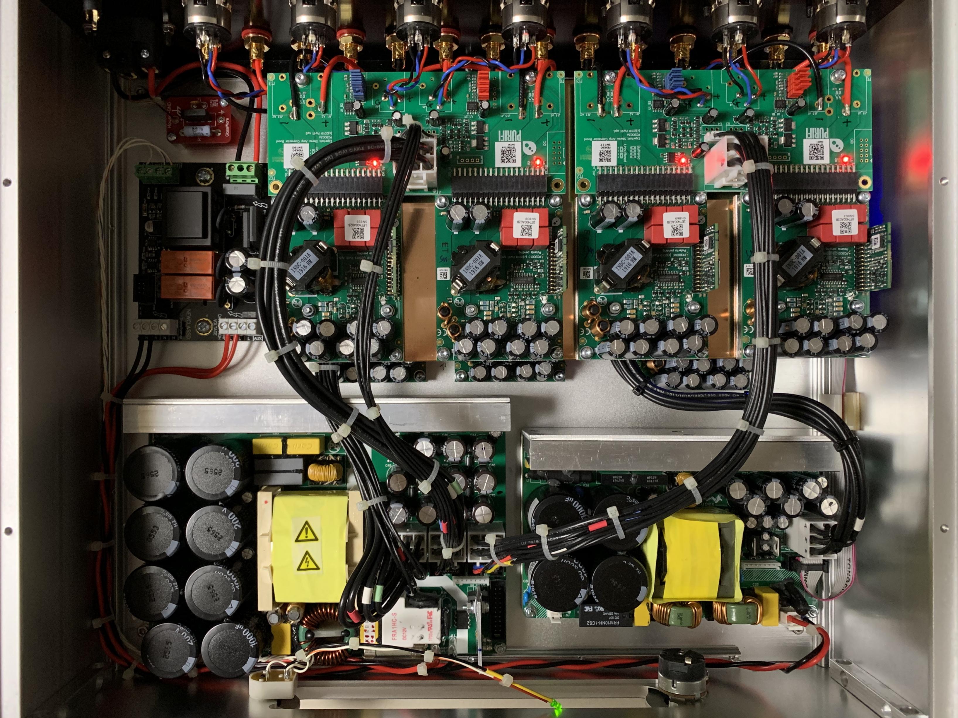

I am going to build a 7 channel amplifier for AV purpose🙂
Any updates on your 7 channel build ?
How is the SMPS3K working out ?
TIA
Add extra capacitors with 15000uF or more per rail and you are good to go.
Nice work Sami 😉
I see my 2 channel Purifi amplifer here....
TIA
Finished long time ago, happy listening now😀
