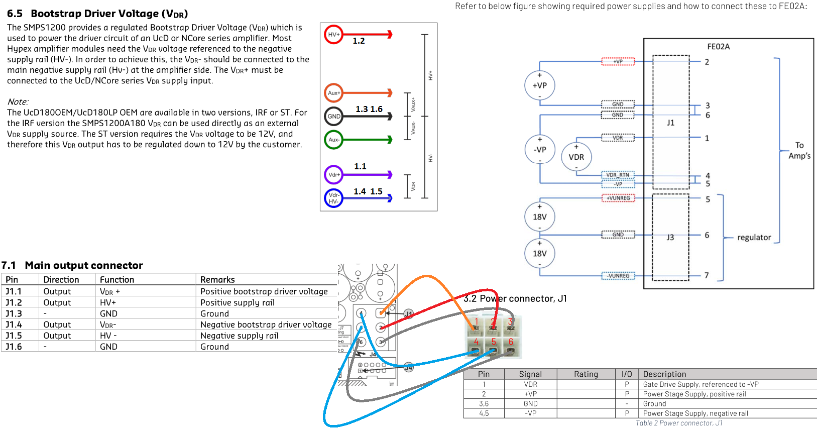

Has anybody here wired up the ET400 eval kit with the Hypex SMPS1200A400? I am a bit confused with the connections betwen the two.
The J1 power connector on the SMPS carries two bootstrap supplies, Vdr+ (pin J1.1) and Vdr- (pin J1.5).
On the ET400, the J1 power connector lists for pin J1.1 'gate drive referred to Vp-' . I assume that should be connected to the SMPS J1.1 Vdr+, but the 'referred to Vp-' confuses me.
Maybe SMPS J1.4 (Vdr-) should be connected to the ET400 J1.1 (Gate drive +, referred to Vp-) ?
At any rate, the ET400 J1.4 and J1.5 are interconnected and should be connected to SMPS J1.5, HV-, so one SMPS line (Vdr+ or Vdr-) does not need to be connected.
Who can clear this up from own experience having a non-exploded set working ? ;-)

Hi Ergo,
I think something clicked in my mind - you do that sometimes ;-)
Can you confirm: pin 4 of the SMPS J1 (Vdr-) does connect to pin 4 on the ET400. Since on the ET400 pin 4 and pin 5 are interconnected and connected to HV-, it seems that the SMPS Vdr- is connected to HV- and is the ref for the boost supply Vdr+ which is connected both sides to J1.1. ?

I know I had to put these pieces of pdf manuals side by side but can't find my paper copy to scan... anyhow I recreated it below and even though it was a while ago I'm pretty sure this is how it goes.
Not sure why Purifi keeps it this vague and documents it differently. As they do not offer PS I would expect majority of people are building it with Hypex SMPS.

Good - do confirm once you power it up successfully. Then I know if to keep that diagram for reference to others.

Yes the wiring is correct, it worked first switch-on.
