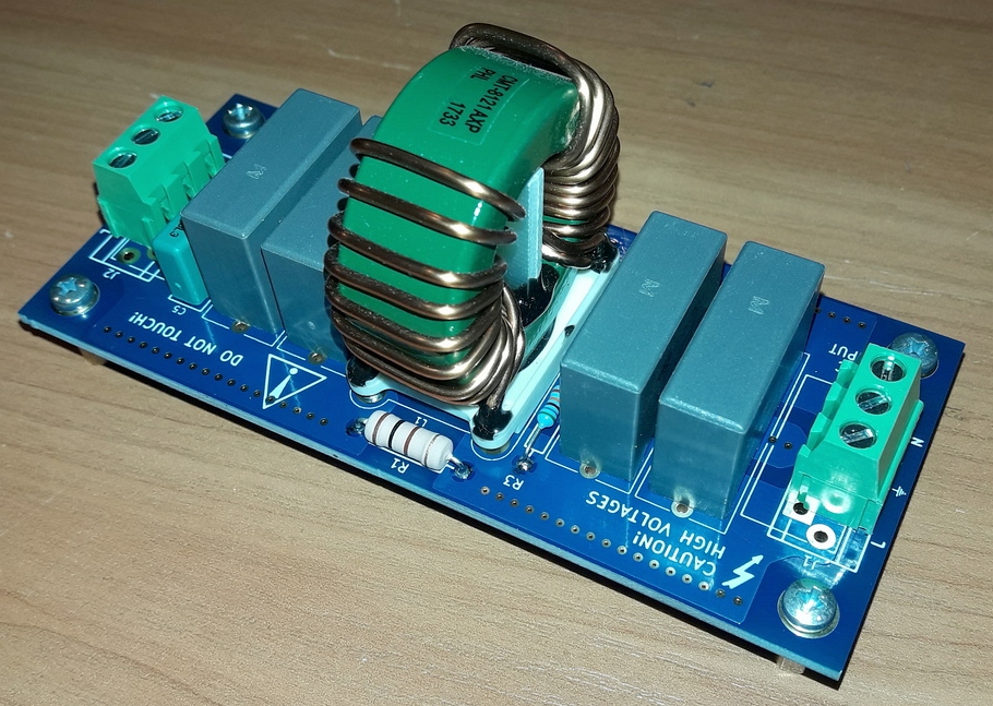

BTW, Aleksandar sells:
EMI/RFI/Common Mode Filter – assembled and tested PCB – ATL Audio Ltd.

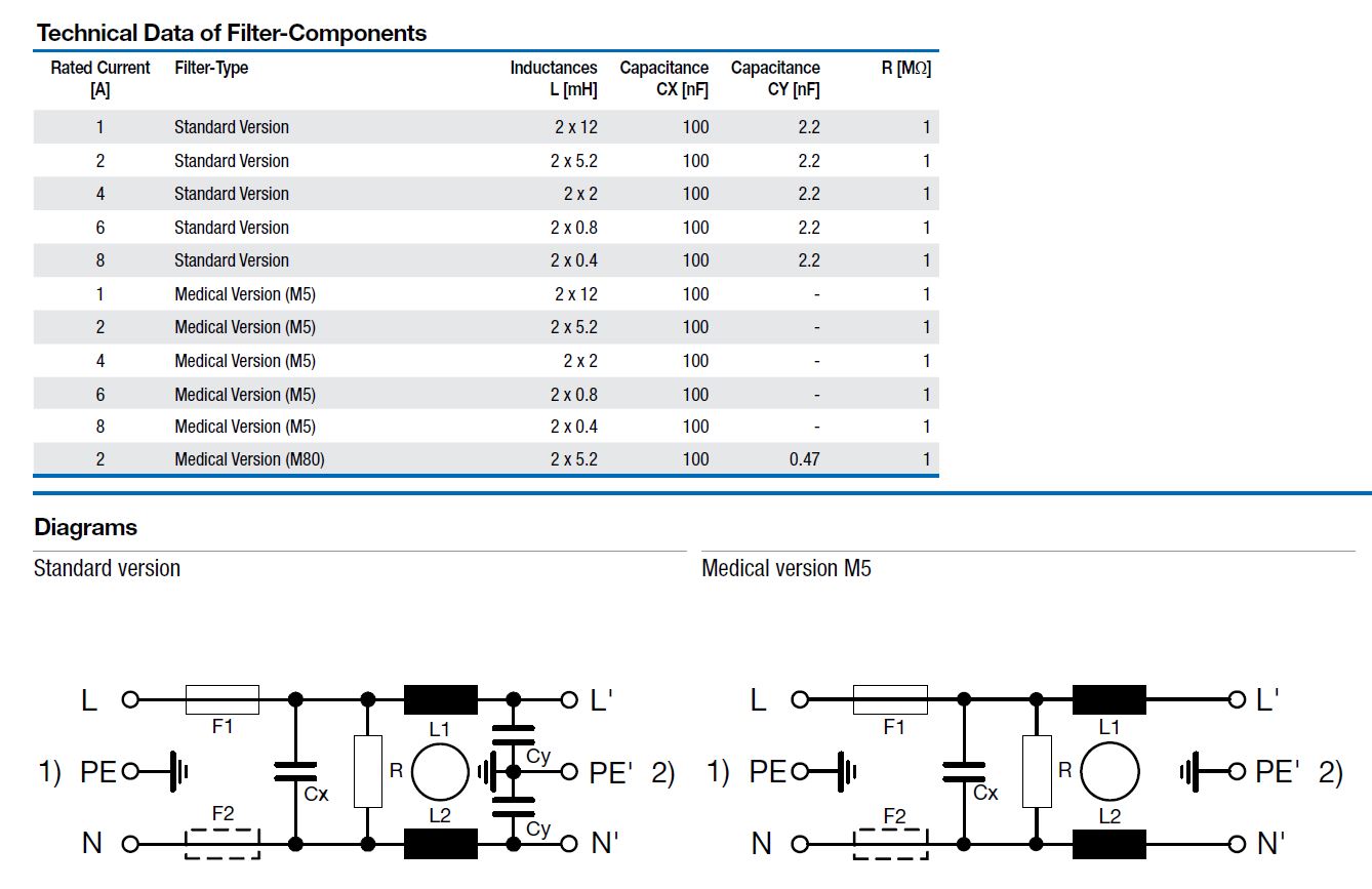

Look at the graphs (Schaffner and this).

Do you have "before" and "after" measurements of either? I know Bruno Putzeys has spoken against the filters, because they conduct mains noise to the chassis ground

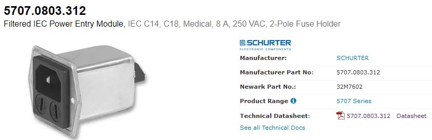

Here is an AC input EMI common mode filter without the Y-capacitor.
Filtered IEC Power Entry Module, IEC C14, C18, Medical, 8 A, 250 VAC, 2-Pole Fuse Holder, SCHURTER: 5707.0803.312
5707.0803.312 Datasheet

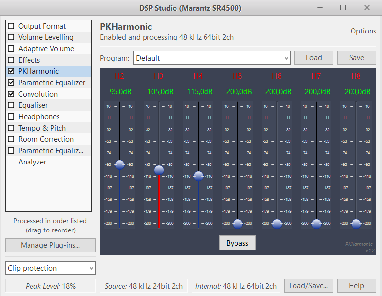

PKHarmonic VSTplugin
@daniboun
After listening to the audio a few times, the best sound on my system is with the addition of these harmonics.

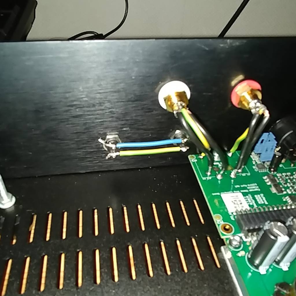

Currently reaching the end of my build first channel and having a couple of questions...
- I see on Jaaptina's build he is soldering the 2 (or 3) output pins to his binding post. I just connected 1 so far. Any reason for (or not) connecting all ?
- Could you confirm the sense input should also be connected to the binding post (like the output) ?

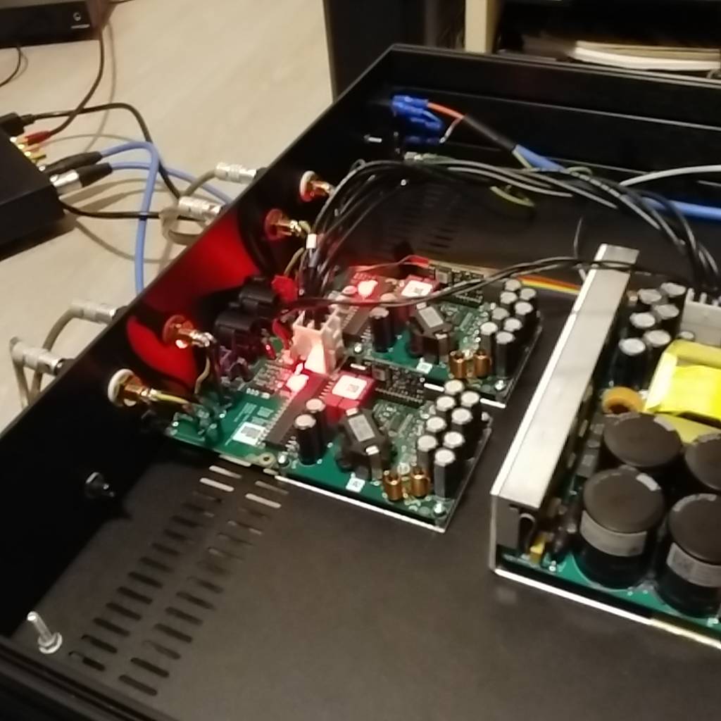

I recently finished building another Purifi amp - this time a stereo build using the Hypex SMPS3KA400 power supply and Neurochrome buffers. I wanted a compact amp that I could hide behind a table for my bedroom system.
I'm using a Galaxy 2U 230mm x 280mm case. To fit two channels in this case, I mounted one channel above the other, using a 10mm thick aluminum plate for the upper channel to provide some heatsinking. Because of the limited height in this configuration, I had to remove the power connectors from the Neurochrome boards and solder the power leads directly to the board.
Because this SMPS is not designed for half-bridge amplifiers (like the Purifi), I connected the second channel in reverse phase (swapping positive and negative inputs and outputs) to reduce the chance of large low-frequency reverse currents causing a problem. Most music has similar low frequency energy in both channels, so connecting the two channels out of phase will mean one channel will be pulling current while the other is feeding current back to the PS.
I chose the SMPS3KA400 mostly because the 1200w version was out of stock when I ordered it, but the 3K has the advantage of multiple power connectors.

Quite nice! I think you could have placed the Purifi modules vertically, on L shaped aluminium pieces. This would have provided even better aeration and possibly dissipation?
Yes, I agree that vertically might work better from a cooling perspective. It would be a little tighter to the connectors, but probably still doable.
Doing it the way I did made it a bit easier to scope points on the board and get one channel tested at a time.
