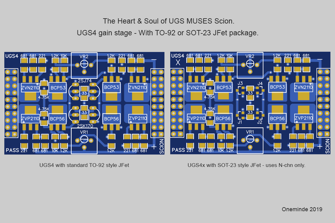

If we are looking for alternatives for an input gain stage, I would hope that some enterprising DIYaudio member who is adept at discrete circuit development might design a discrete alternative specifically for the Purifi amp modules, this could be a great project, and a really good discrete circuit has the potential to outperform IC based designs if a clever and talented individual designs it. could probably be a decent commercial project as well as it is pretty clear there is going to be a demand for alternative buffers for the Purifi modules.
If it qualify as buffer (fully discrete) - this is the Pass Labs Universal Gain Stage, generation 4. If it does not fit the job or qualify as a buffer, then I apologizes.
