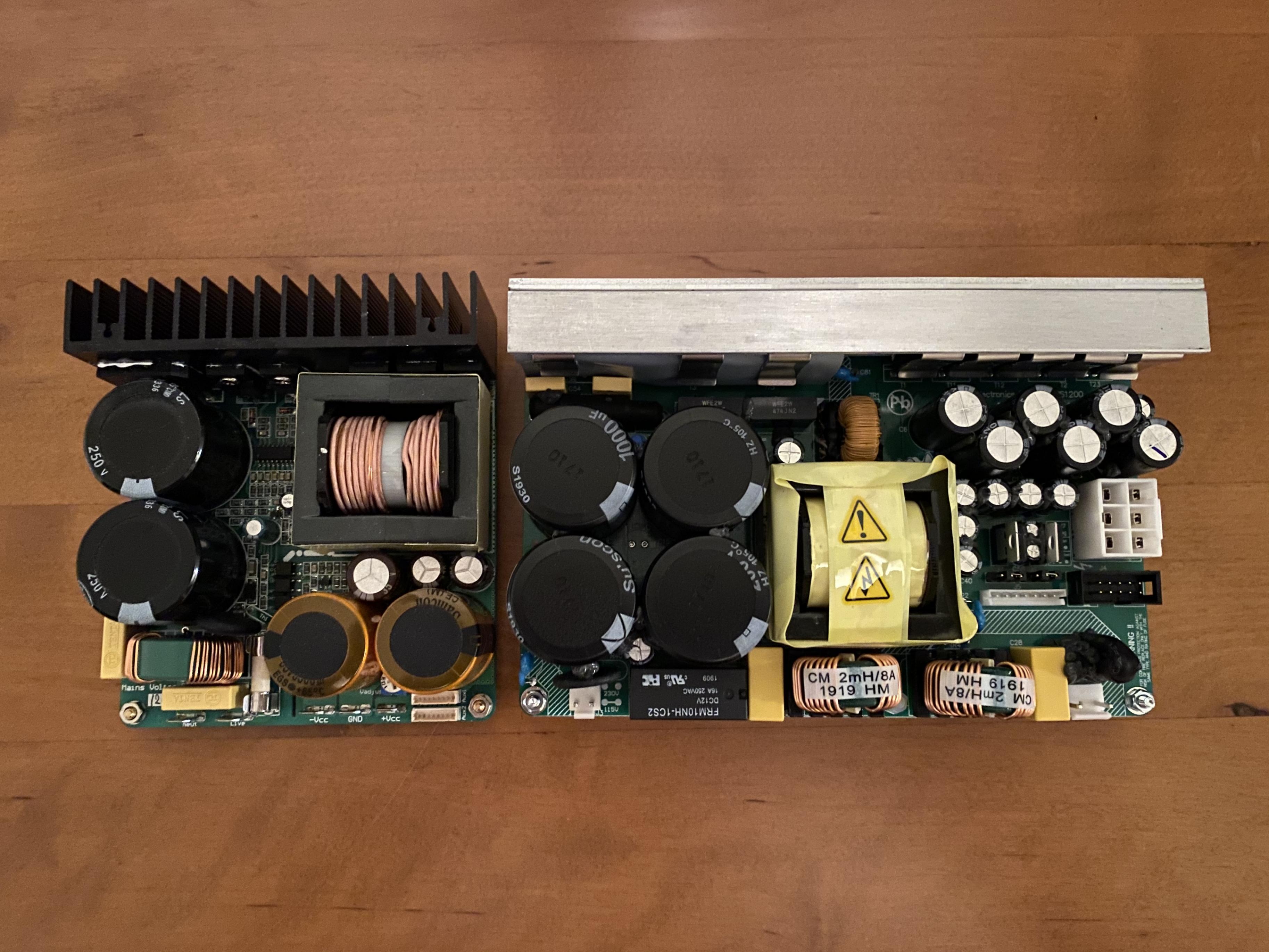

"True, but this is not the hypex module. Perhaps they have improved power supply noise rejection (I think they claim that). Are you suggesting to desolder the 7815 and replace it with a Belleson? Eek."
Yes, that is exactly what I am considering, but until I see the supply in person I will not know how possible it is. I have done plenty of mods like this before, and do not anticipate problems, but it would depend on how tight the fit is there on the board. IDK if the PSRR of the Purifi module that they talk about includes the VDR section or not, all I know is that there have been folks who have supplied a separate power supply feed (from an ultra low noise low impedance linear supply) to the Ncore modules and reported nice sound quality increases. if it is easy for me to replace the reg I will do so, I have a good relationship with Belleson, and have a lot of their regs at hand, so it is easy for me to try as long as the board allows it-they are direct pin compatible with 7815.
Ok, so I suppose you would refer to a SPM78 or SPX78.
The 7815s are easily reachable, see here:
![smps800re-power-supply-module-800w-72v.jpg](https://www.audiophonics.fr/10506-thickbox_default/smps800re-power-supply-module-800w-72v.jpg)
The only problem then would be the width. I just measured with my caliper and the width of the space available is 11.5 mm.
Never unsoldered something in a nondestructive way. how do you do that? first melt and remove (with a pump) the solder below, then heat the legs so that the remaining solder is molten and lightly pull up the regulators? (after unscrewing, of course ;-) )
Well, that's for much later.
Roberto

The Hypex SMPS1200A400 is a way better supply than the Connex. If anyone wants to buy mine I'll sell it for dirt cheap. Also you don't want to feed the main rails a regulated supply. There's a reason the main rails on the SMPS1200 is unregulated. and it's not to save cost.
I think I have to partially revise myself. The result with the Connex supply is so good that it cannot be only due to the amplifier board. Yes, the components on it have no noble pedigree (Samxon capacitors) but Connex has a good reputation. I believe that the sound quality here is due to the fact that the supply is regulated.
Maybe when Cresnet will provide his own I will try and upgrade it
Roberto
Not sure how it's possible to draw this conclusion after only trying 1 configuration. With my testing the Connex sounded anemic compared to the Hypex SMPS1200. I suggest people should try multiple supplies before claiming any superior.
Also I forgot to add that I have the top of the line RxE version. But in 600W. They show Nippon Chemi-con caps in the picture on the website. But when the product arrives it has the crappiest Chinese caps they could find.
You are right. My phrasing was also a bit rhetoric. But it does sound so clearly superior to the NC500 that I cannot relate it to several claims that the two modules sound "very close".
