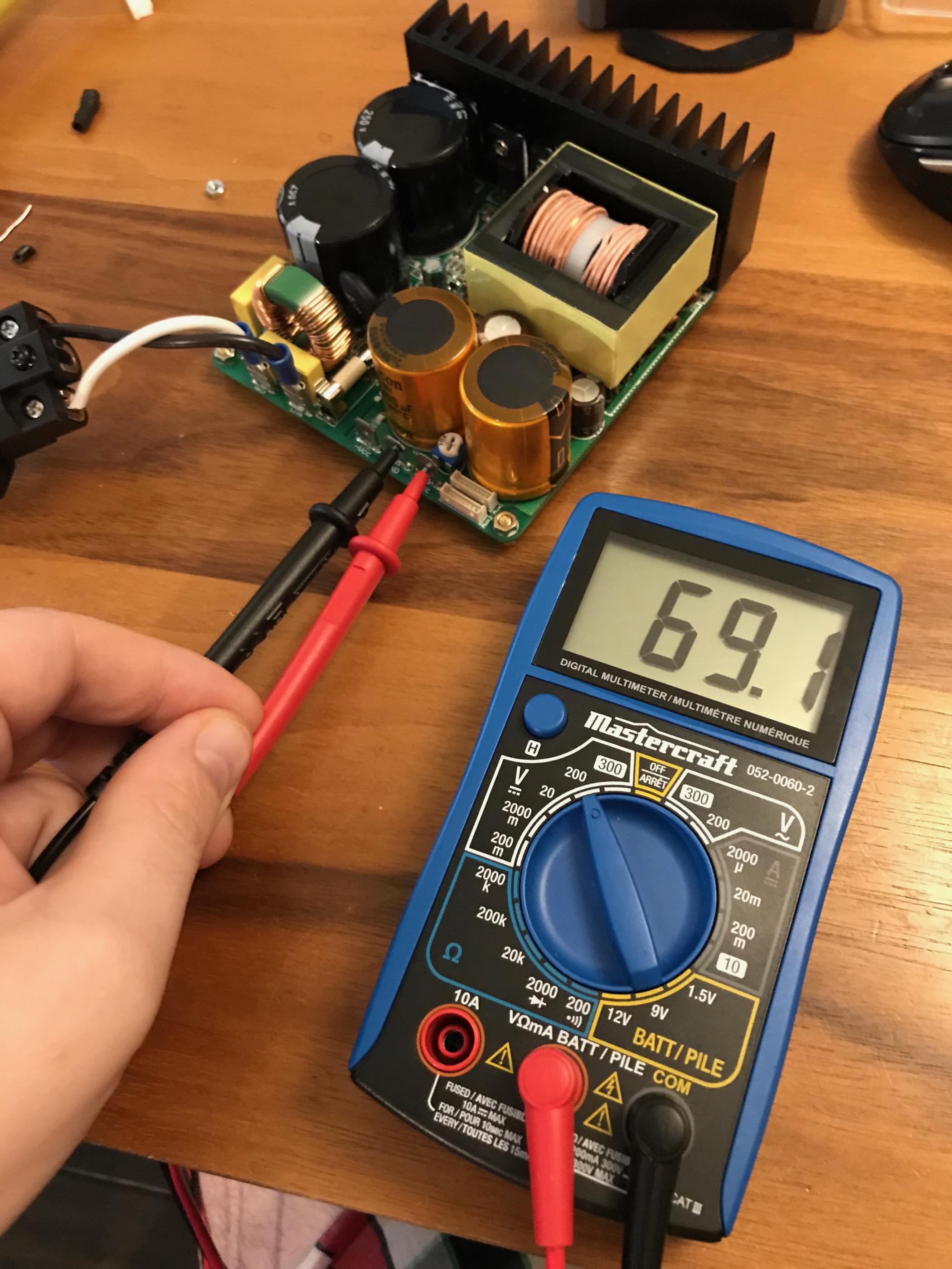

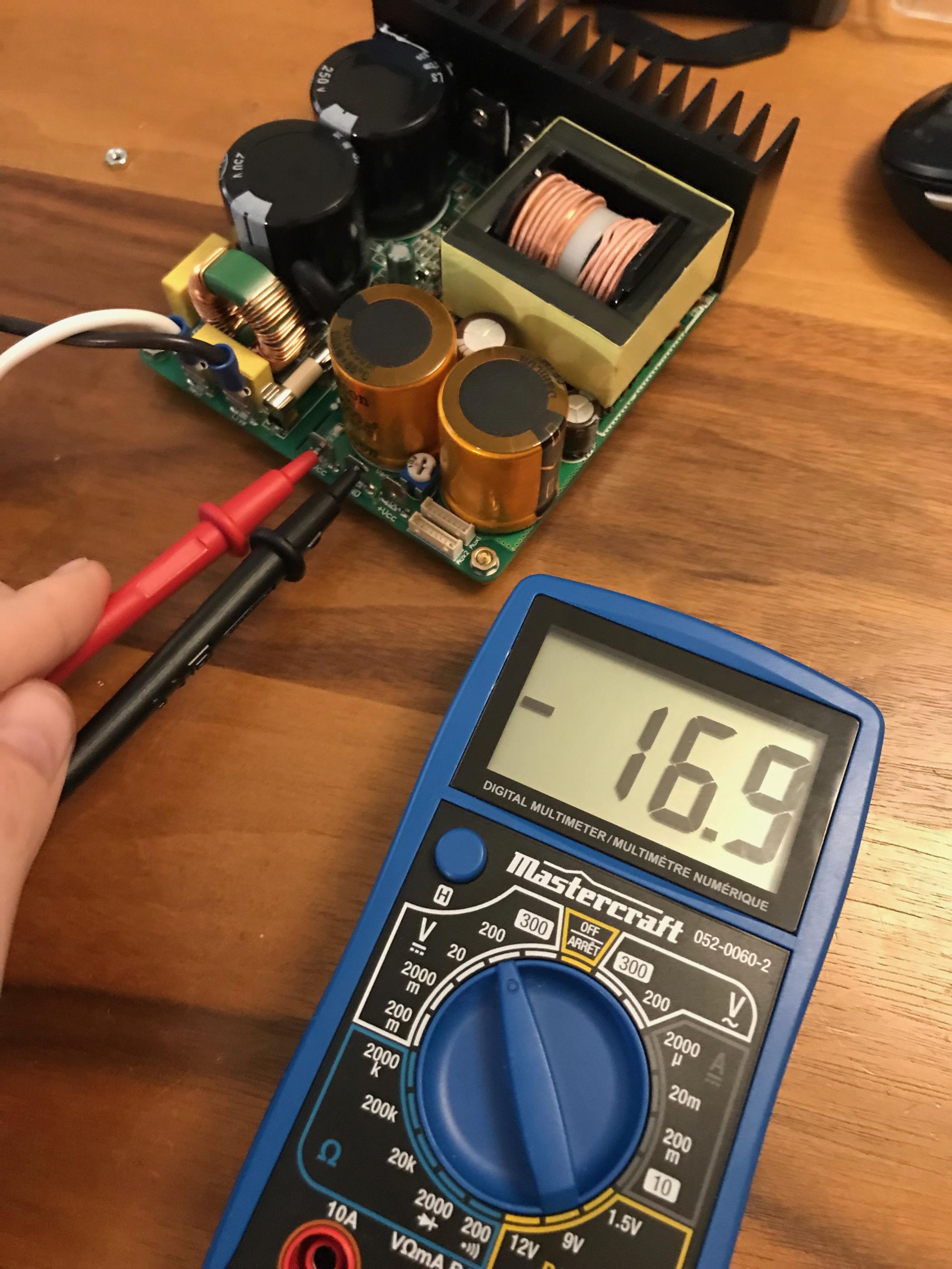

So I thought I'd test the Connex supply on my Purifi amps today. But before I got a chance, I measured the main rails which are supposed to be +-55v and this is what I get. Not sure if the cheap output caps failed or what it is.

Measure it with a load connected. You should know that, authority.

Ahh so we need a load to produce the correct voltages?

That's pretty common for switching power supplies, actually.

The 20 other dual voltage supplies I own all measure at their specified voltage under no load. If I was measuring for current, yes a load would be required.

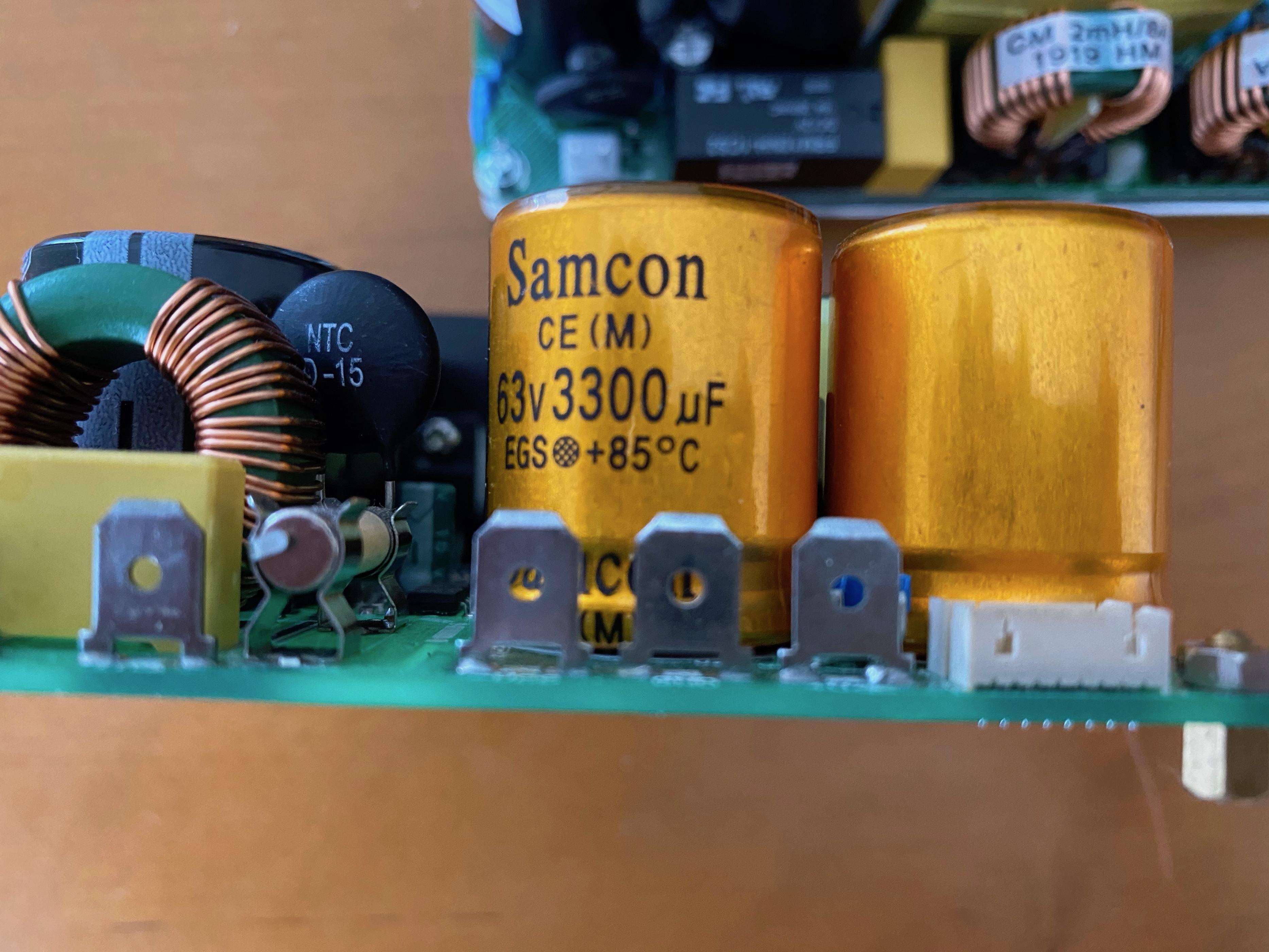

I think I know everything I need to know about this supply already. For me it was already a fail when he shares pictures of it on his website populated with Nippon Chemi-con caps, and it arrives with the cheapest caps he could find in the Chinese surplus cap bin.

A regulated PS should always stay at nominal output level - load or no load. That's really why you want them

As Tom Christiansen replied, with no load this is not necessarily the case. Mine jumps all over the place if not connected to anything, and once connected to the amp it stays at +54.0/-53.9 without sagging even at peaks (which in my case are moderate anyway). It depends on the SMPS. So this one does an excellent job of keeping its voltage constant when powering an amp. Which is really how I want it.
