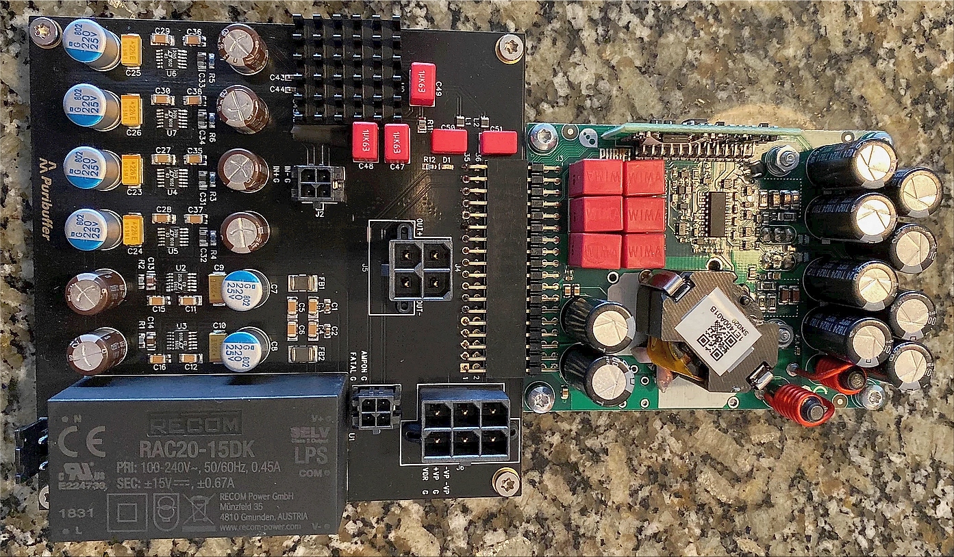

They also have 6 ultra low noise power supplies built in to power all the various sections of the Purifi modules to perfection. Everyone else uses the dirty power from the Hypex supply, and shares the power regulation between multiple sections Yuck!

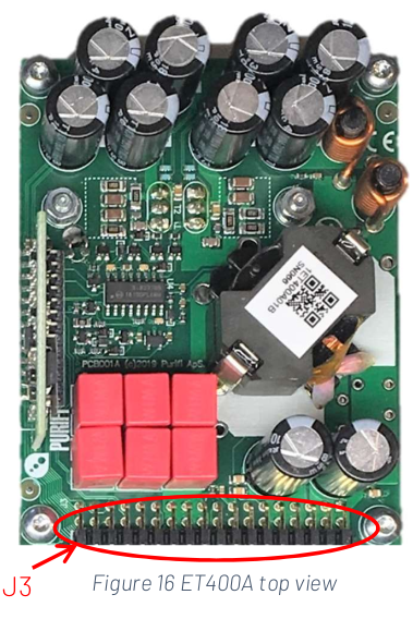

In respect of the 1ET400A, picture, VP 1/2 VN 9/10 GND 3-8. I kind of wonder about the current carrying capability of those pins but no doubt the sums work out.
Of more interest is the pair of electrolytics close to the connector. The bank of electrolytics to the rear of the the board and, more importantly, the pair of rod inductors also to the rear of the board.
I would hazard a guess that this is a deliberate design decision to implement a CLC section that isolates the connected supply from the main amplifier and the likely horrible negative impedance it might present to that supply.
Forward numbers are possibly meaningless but 1uH and 2200uF would have a corner frequency of just above 3KHz and would be critically damped with an ESR of 21mR.
In many respects the inclusion of that filter should cause pause for thought when arguing about the nature of the supply itself. At least it seems that way from my armchair.

if those inductors are power supply filtering inductors, where are the output inductors?
It's the one with the white Part No: label on it. RM Pot Core.
