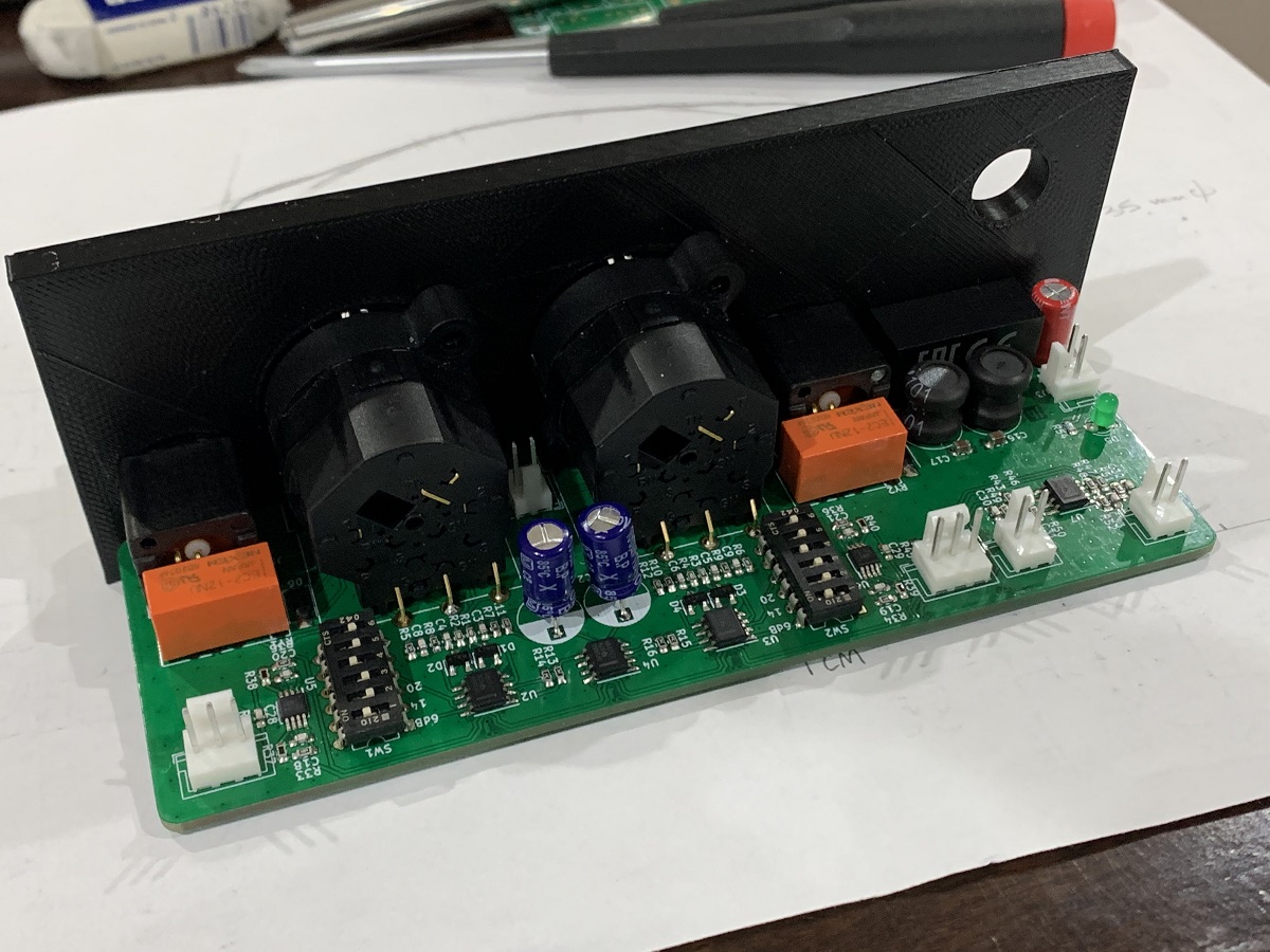

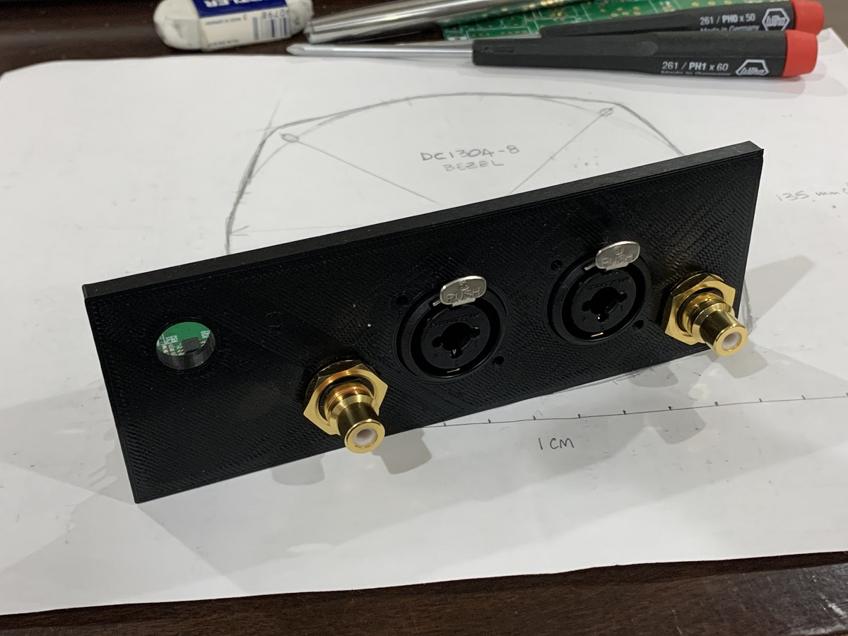

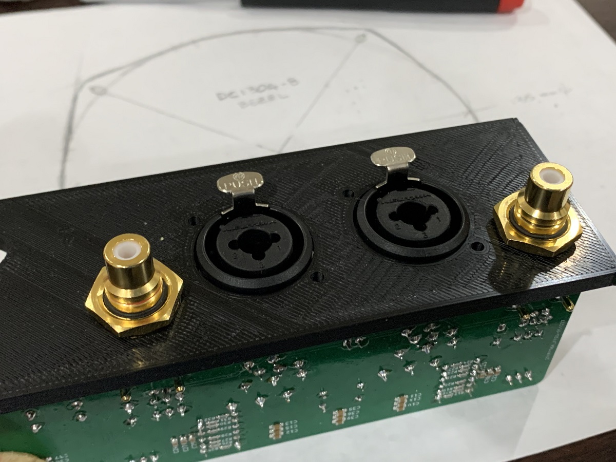

I made a 3D print of a test front/rear panel for the BTSB Panel Mount edition. I had concerns that the locking XLR tab would make it hard to slip all 4 jacks through the panel cutouts. But apparently, it is not an issue for a 4.7mm thick panel with 1mm chamfer on the back. This will make for a nice compact little bench tool to allow conversion from SE/Bal to SE & Bal.

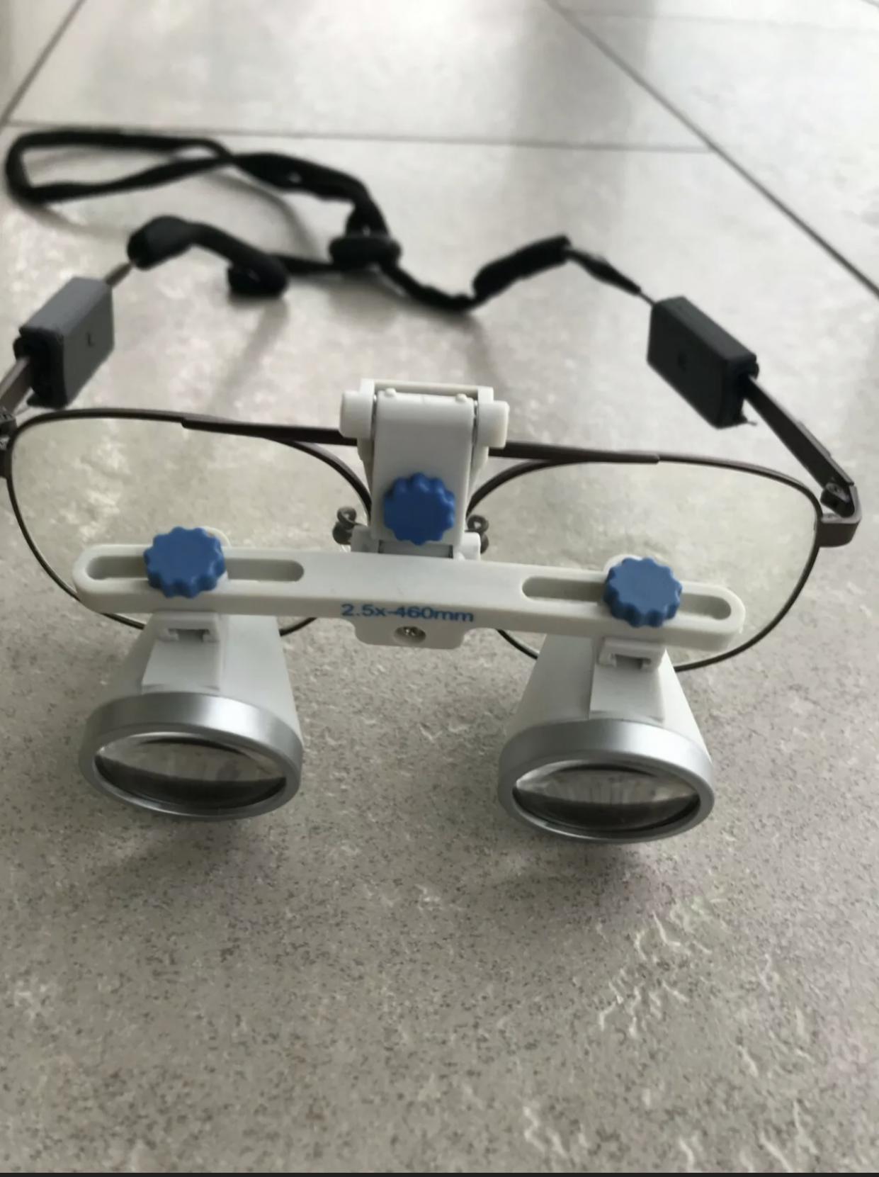

Thanks for the links x. I have got those flip up magnifiers, I though my face is way too close to the action, how do you get on with them?
I’m going to pick up some dentist loupes and see how those go and combine them with an led headlamp. You can pick them up on eBay for £40ish.
