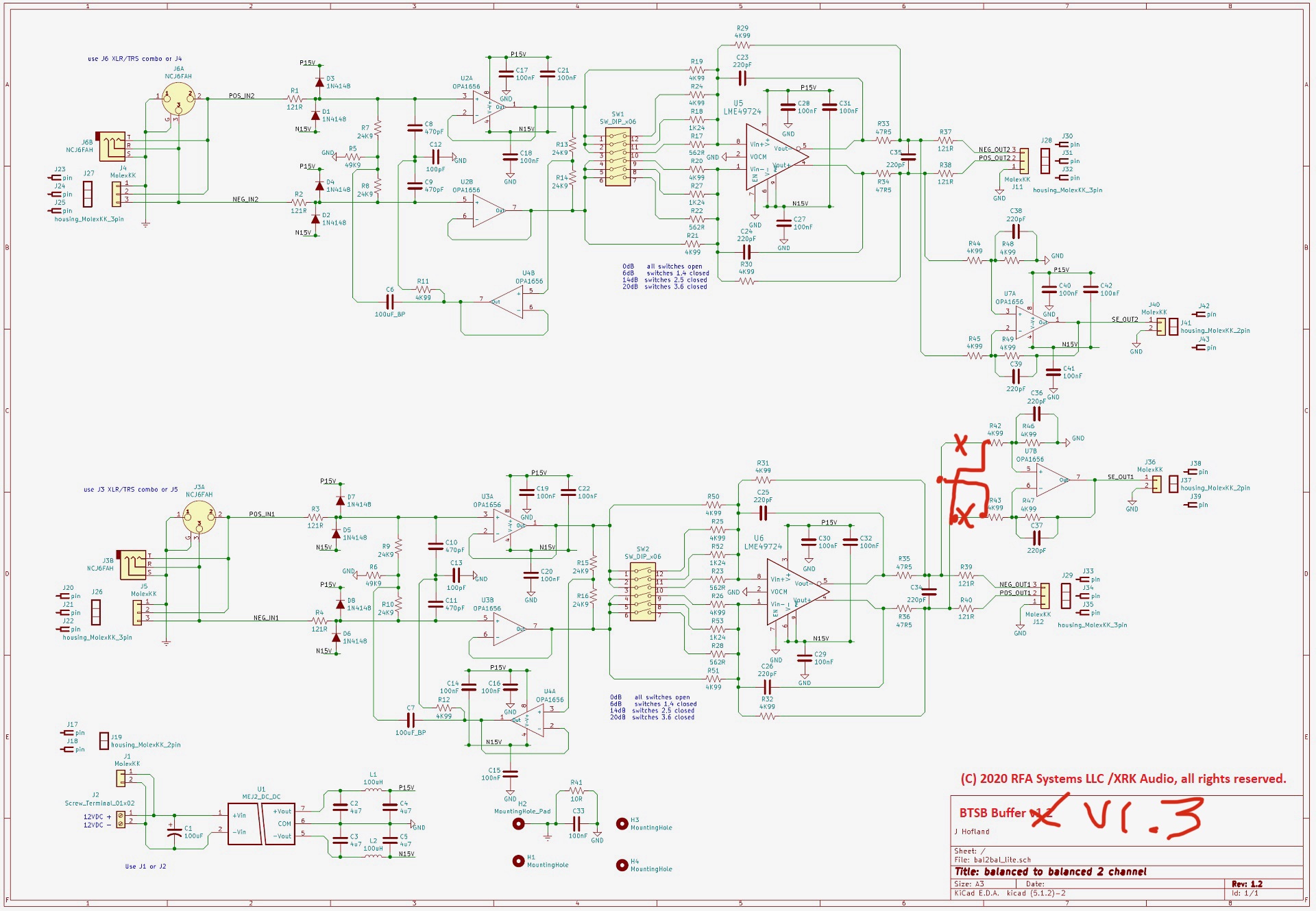

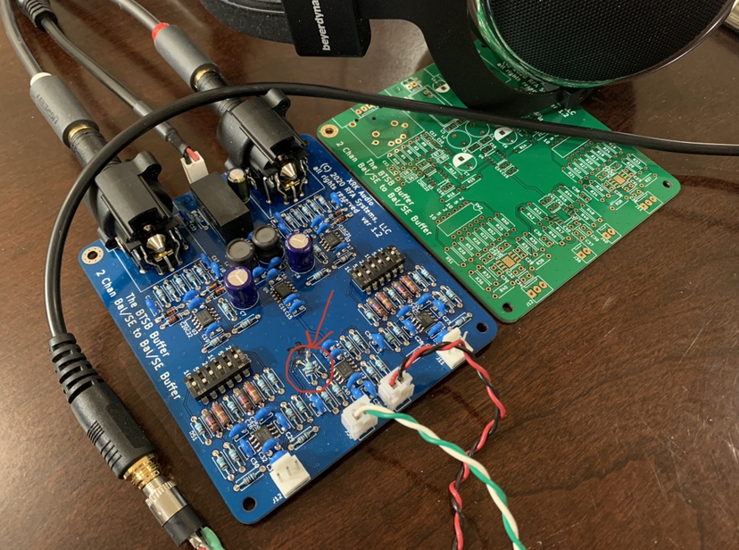

I tested out the easy fix for the v1.2 TH boards. See the red circle in the photo below for the location of the mod. It requires crossing the leads on R42 and R43. This was done on my verification board which was blue and not in ENIG finish. Some of you may have this older board (which I have offered to replace with the v1.3). However, if you have populated it already, the easy way to make it fully functional with SE output is to do the mod shown here. It’s quite easy to do. One other thing I did was made a headphone jack to connect to the SE outputs. The OPA1656 can drive up to 100mA and this is quite sufficient to drive many headphones nicely. I tested it here with my Beyer DT-880’s (250ohm) and it sounds great. So it turns out that the BTSB also doubles as a handy headphone amp!

Does the Murata Power Supply on the board have enough current capacity to drive headphones ? I only ask because in some of the earlier messages you commented that the power supply was close to its limit and on the new boards you have adopted a higher rated Power Supply module.
Also is it necessary to solder the back of the two output Balanced Op-Amps to the pad on the PCB. Do they really create so much heat that they require a heat sink ?

The Murata DCDC is good for about 70mA I think. Most listening levels are well below that I think. It’s probably not good for driving lower impedance phones to loud levels but for my 250ohm cans, it’s more than loud enough. Just offering it as a novelty. In a pinch it works as a headphone amp. You should add solder paste to the bottom of the LME49724 for the thermal pad to make contact with the PCB as heatsink. That is what it is designed for. If you don’t have solder paste, use liquid flux and solder from the back. But that’s iffy. It’s probably fine as long as you are not intending to drive lots of current.

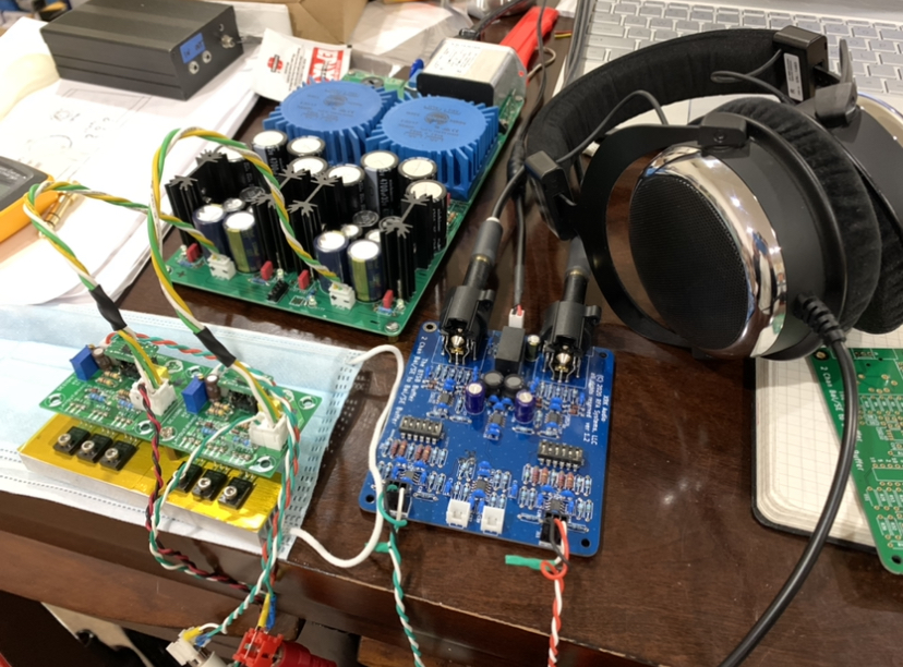

For fun, I pulled out an old Wayne Kirkwood (member mediatechnology) headphone amp I made years ago based on THAT1646 driving a pair of BD139/140 in Class A push pull. It’s powered by the uber premium Yarra Mk2 active bridge TPS7A4XXX regulated power supply +/-18v and good for 1A). This headphone amp is one of the lowest distortion amps I have measured in the past. It’s only a 0dB power stage though so the BTSB was the perfect voltage gain at 14dB. It sounds quite spectacular. This amp is probably capable of up to 4W into 32ohms. It’s Class A and runs hot though. My heatsink is way too small.

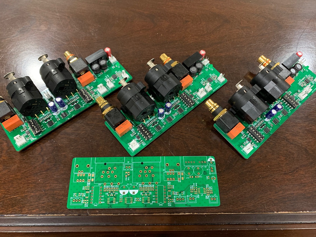

Vunce was kind enough to build up two more BTSB v1.21P panel mount boards for me. This time I wanted to test different opamps to see if others can work here. The wonderful OPA1656 orginally spec'd for the BTSB has been rather tough to find lately. There is plenty of stock on the OPA1642 (a JFET input opamp with very nice specs), and the LM4562 (a BJT input opamp, also with very nice specs regarding low distortion). So now I have an example of all three opamps and can play them side by side.
First listen was using my Focusrite 2i4 as a balanced or SE source and the BTSB woulld then drive my FH9HVX Class AB to my 10F/RS225 TL speakers. Switching between the three amps it was very hard to tell a difference. Maybe with some more extended listening I can get more info. I also tested the balanced output usiung an IcePower 1200AS2 driving my little Rockvile 5in 2-way speakers. First impression is that the OPA1642 sounds great. There are like 8000 of them in stock at Mouser and they are only $2.10ea in singles. The LM4562 sounds maybe a bit "drier" but still very clear and transparent. There are 4000 of them in stock and they are only $1.86 in singles. So it seems there are some alternatives here for the OPA1656.
